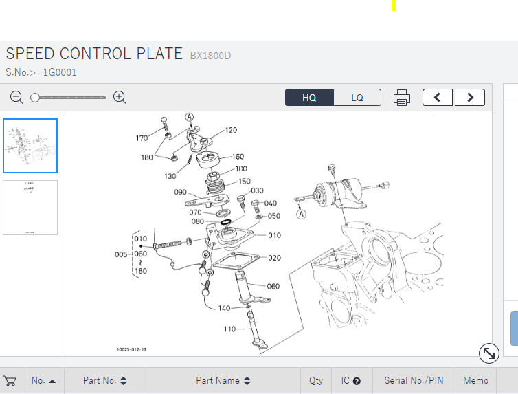

More than likely the slow to stop issue has nothing to do with the solenoid, but the linkage in the speed plate.
Remove the stop solenoid and the throttle linkage and see if both the control works smooth and easy.
They are a shaft inside a shaft so an issue with one will be an issue with the other.
As far as black smoke and slow start, it's not the stop solenoid causing it unless the linkage above is sticking hards.

Used to do a bunch of them, slow to shut down. Usually an issue with the stop solenoid, won't pull completely in to fully shut the fuel off. With engine OFF, turn the key ON (but do not start the engine) and then turn the key back off. Now grab the shutoff lever and push it towards the shutoff solenoid-if it moves at all, you can adjust the solenoid as it's mounting holes is slotted a little to allow for some adjustment.

You might want to check the position and alignment of the stop solenoid you replaced. It looks like it's just a drop in part but I found out when I replaced mine that it can be slightly out of alignment that will make the plunger move slowly or not at all. The are slots in the mounting plate that allows for some adjustment.
This was the most helpful suggestion. I put the original one back on. The tractor shut down immediately and started like it should. I bought the aftermarket solenoid a few years ago, throwing parts at a problem the tractor had. I have gained more knowledge now. I will check after it sits overnight and give it some time and report back. Thanks!
