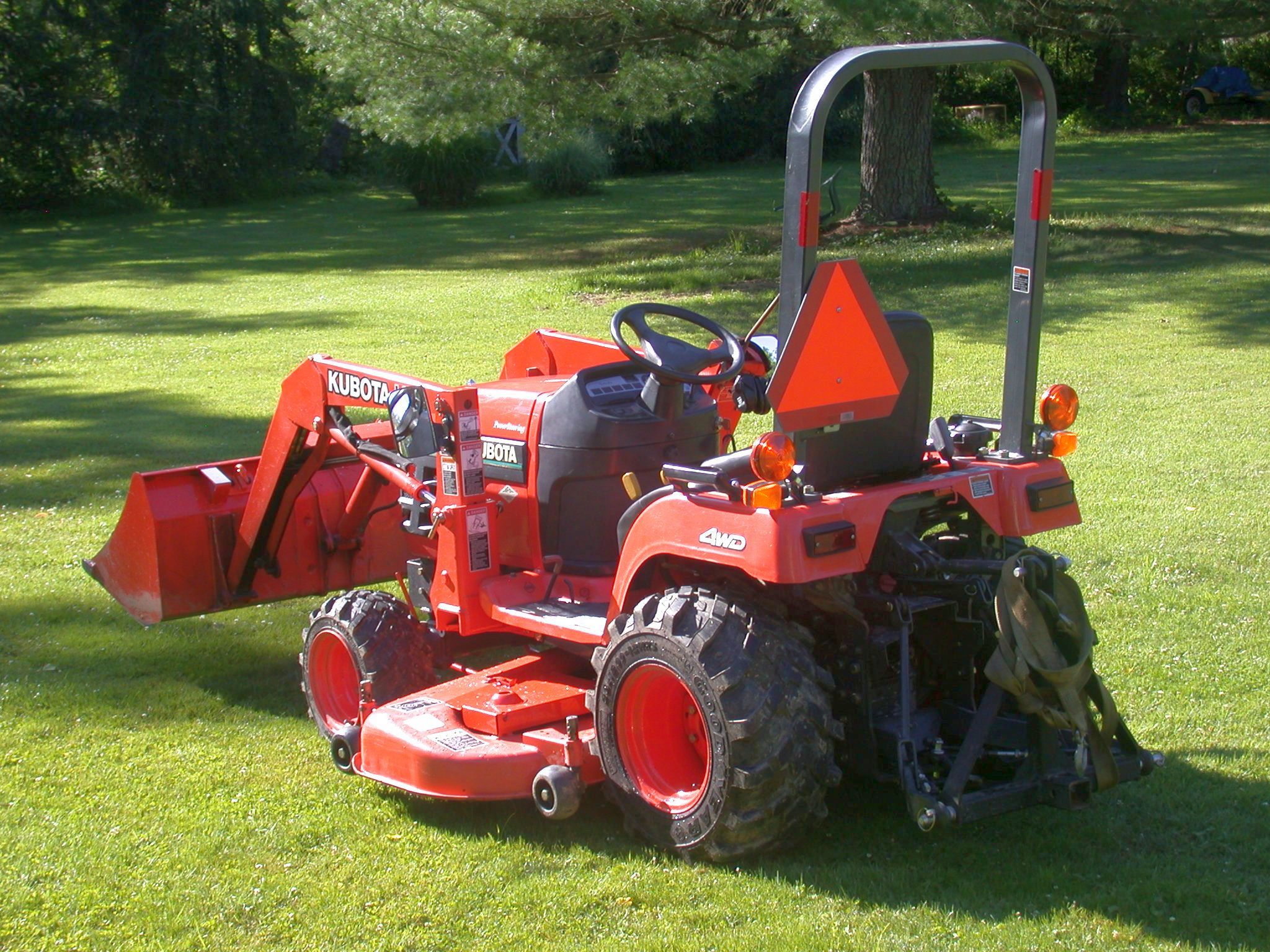

I like the look of the R14s!
In my case, I foam filled all four of my BX2200 tires. Never looked back and never regretted it. That was maybe 15 years ago. Tires are R1. Not that that matters.
Foam is not cheap but it is heavy, and fills the tires 100% which likely makes it the best of all for adding weight for stability.
Just suggesting an option. Foam is dense but not cement. There is still some flex in the tires if I push them with my foot. The place I got them filled at said they can cure the foam at different pressures depending on the application. I chose what would mimic an air filled tire. Still VERY heavy tires now.
