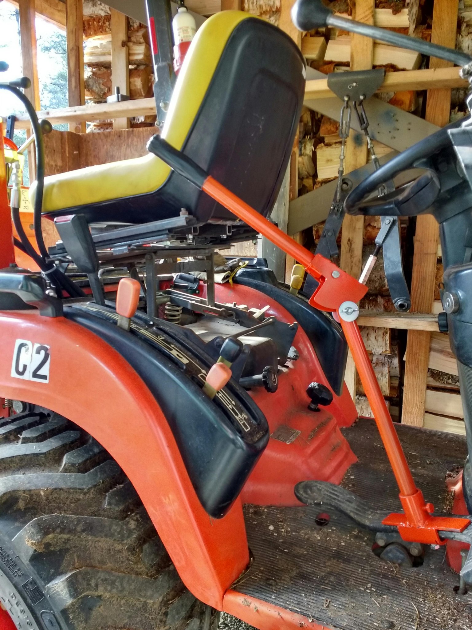

I am fabricating a hand lever that will bolt on the the bottom of the forward pedal. It will allow using the hand lever to pull the forward pedal back. The stock reverse pedal will still be available if wanted. 2 bolts are going to hold it on so removing them easily converts it back to stock condition. I'll post some pictures when I have it done and installed.

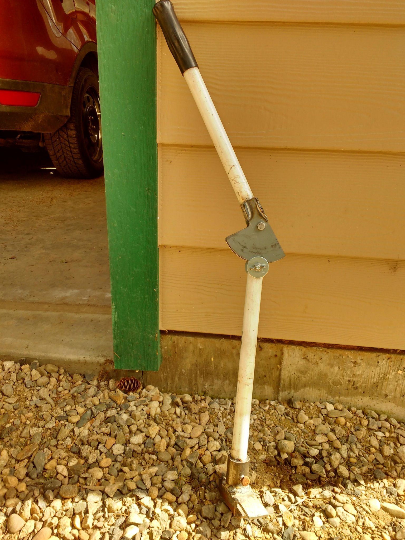

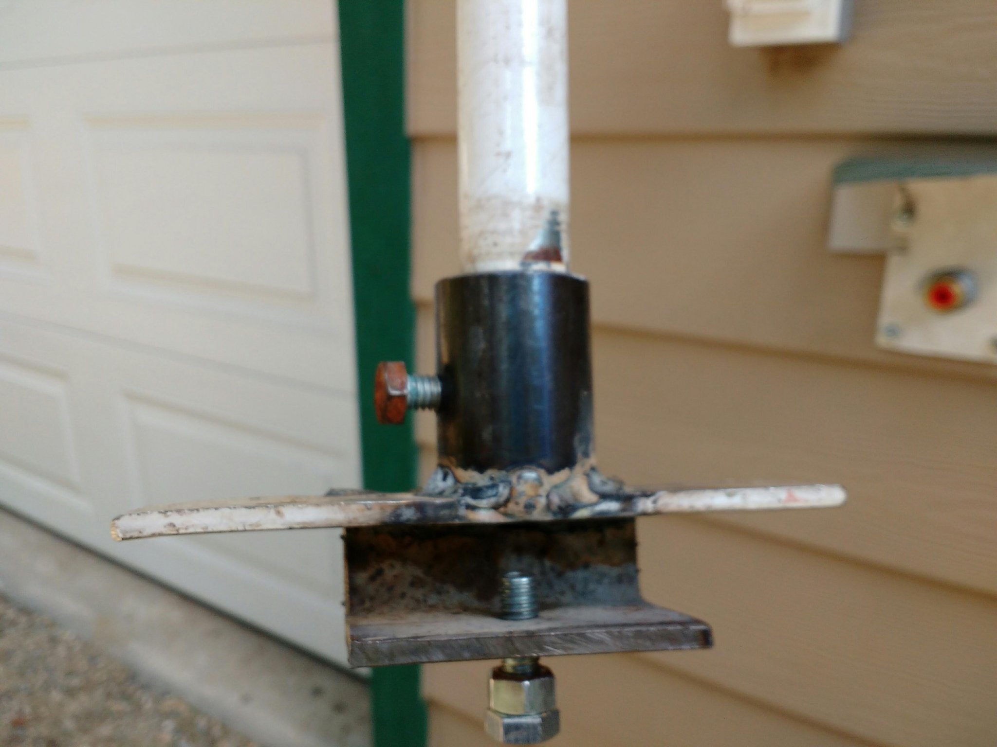

If a hand operated treadle would work for you, here is one I built to be operated from the backhoe position. There is no reason why this would not work, if the handle orientation were changed to work with the tractor seating position.

If a hand operated treadle would work for you, here is one I built to be operated from the backhoe position. There is no reason why this would not work, if the handle orientation were changed to work with the tractor seating position. View attachment 75476 View attachment 75477 View attachment 75478
I am going to do the same idea except I do not have the rocker style pedal. Mine has a forward pedal and a separate reverse pedal back near the fender. It requires you to move your foot back and raise your heel up about 3". The "University Idiot" in charge of the ergonomic design for this tractor pedal set up must have been "free basing" some chemicals. It is obvious he never did or did intent to ever actually have to use it him/her self.
