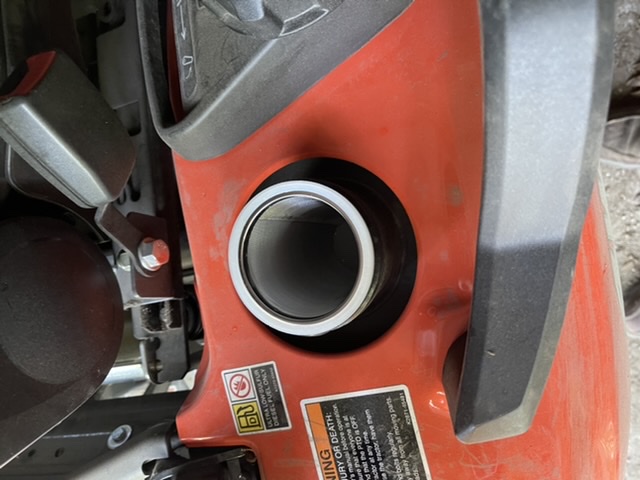

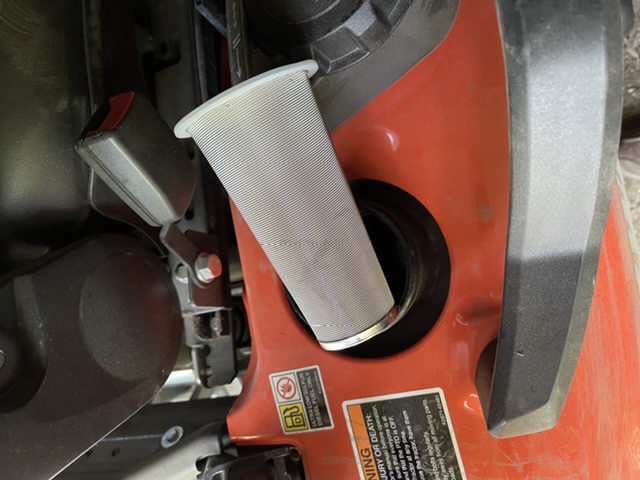

I think this is the one for the BX2380 or any other tractor that has something that stops the filter from going down, it is tapered and should fit past the neck. I am going to give it a try.
That's the one I got after purchasing one that had no taper. With the 80 series it needs to be tapered or it may not fit.. if it does go down past the lip in the tank neck you may not get it back out easily.
Has the gasket but I did not use it.

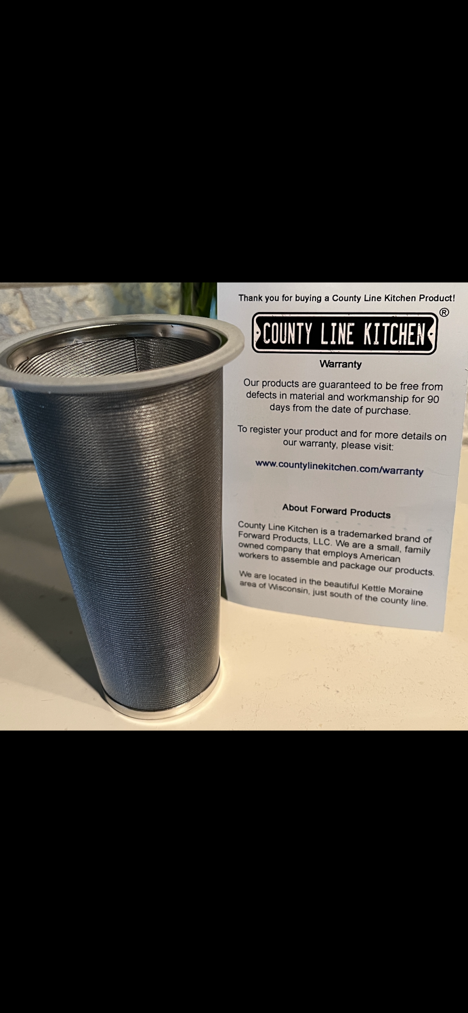

Bought this one. Fits good.
Just checked this filter, and the price is now $23.99 and that is with a 20% discount applied to the cost at checkout. That is more than double the $9.99 that was paid for it last year. I did a little more digging around and I found one that is slightly less at $17.99 after the 20% discount. It appears to be the same tapered filter as the County Line Kitchen filter which was quite inexpensive last year. Should have ordered it back then, but forgot about it after having my surgery and not getting on the tractor for a few months. Toda;y I noticed some unknown black "stuff" stuck to the bottom of my diesel can. I was able to scratch it a little bit and it flaked off. Now I am concerned about getting contamination into my fuel tank. Any suggestion on how to rid the fuel can of the black "stuff" which I suspect might be mold? It didn't dissolve in the little fuel that was at the bottom of the container.
