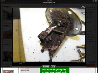

I have changed out the sending unit on my BX2350 also. Royal PITA ! ! ! I think most, if not all the BX line has the same problem with rusting fuel gauge sending unit. When I put mine in, I gave it a triple coat of epoxy paint before installing. No problems since then.

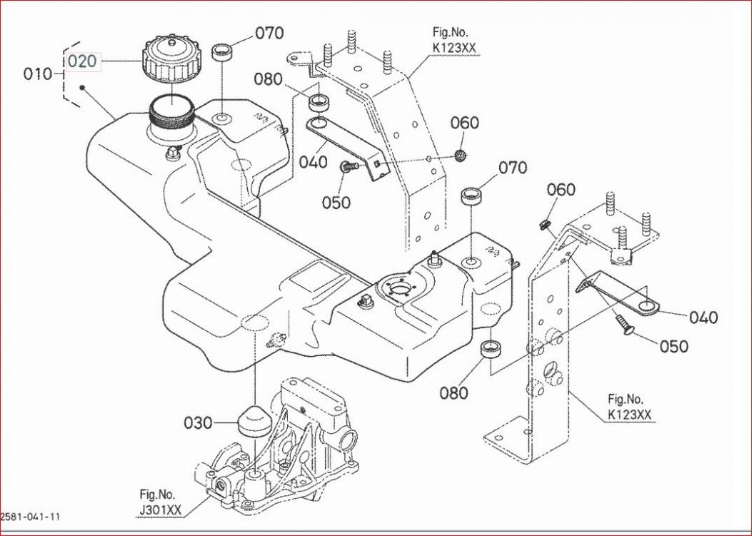

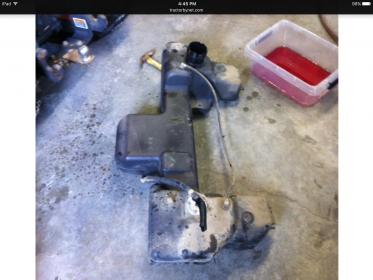

The shape of the tank doesnt lend itself for easy access of cleaning. I also want to remove the rusty fuel gauge which is under the left fender.

A tank like that - it almost makes you wonder if a mad scientist created it like that. I am amazed that fuel gets from side to side.:eek:
I really do not know why they could not have placed the flow out nipple on the fill side - that way someone with a small hand could possibly get their hand in there and "clean" out the debris.

I agree with you. I couldnt believe the complicated desgn of the fuel tank. And how about the fuel level device in the tank that rusts! Have a look at this photo of someone else's fuel gauge in a bx.

Remove floorboard, and HST pedal
Remove ROPS.
Remove rear fenders (don't forget the 12v accessory outlet..just unplug it).
Remove the two fuel tank stays on the rear of where the roll bar goes.
Remove fuel lines. (fuel's gonna drain out).
Then remove the fuel tank.
It's a pain. But what's the alternative? Leave the junk in it?
