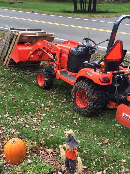

I put chains on my BX2360 without spacers and no problems. Need to snug them up good, it is a little tight in the wheel-well.
I've even used the MMM with them on, but wouldn't recommend it.
I don't think I could do the driveway (and some of the lawn) without them.

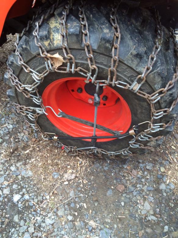

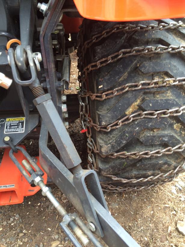

Maybe I'll post on "What did you do today" thread, but here is proof the BX will take chains without wheel spacers. Put them on Sunday.
Not pretty, but I pull the outside real tight so nothing binds/tangles in the wheel well.
