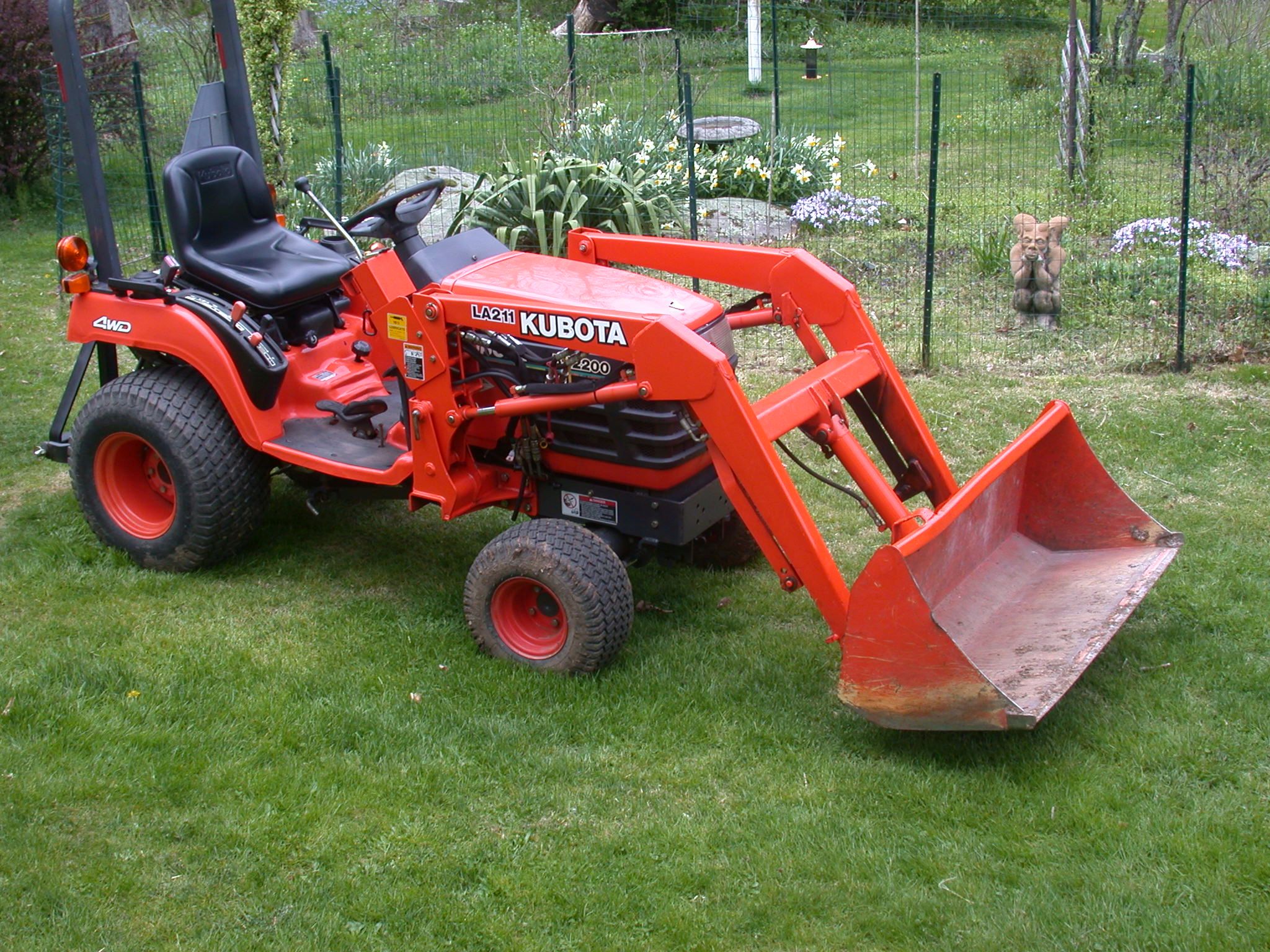

So I just bought this tractor a week or so ago, looking at 2 different models.
Picked this one because of it's compact size, easy to mount and low hours.
This is the first tractor I've owned with the front loader, I'm getting old and, need help. Tired of lifting things by my worn bones..LOL. Anyway, it' a learning curve for me operating the loader but, it sure is a great help. Of course I did make a pretty good mess trying to use it, I guess I'll get the hang of it .

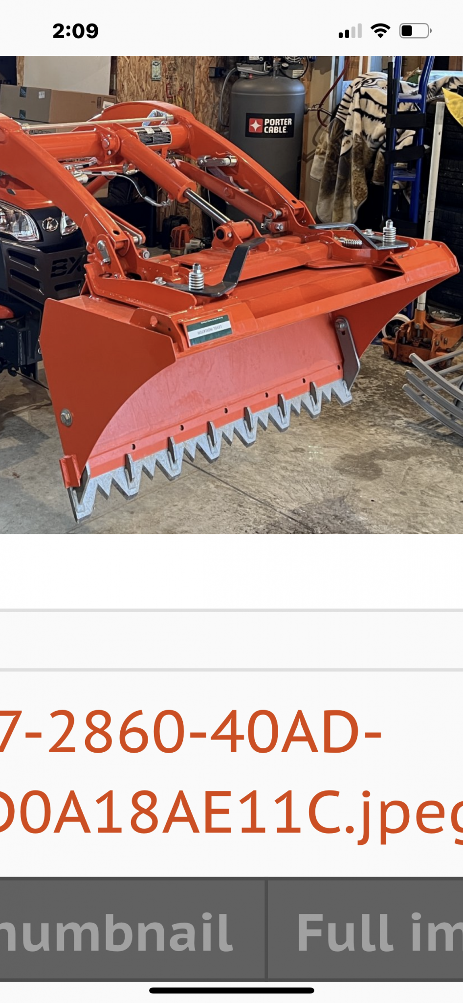

Tooth bar mentioned.. Piranha but any will do.

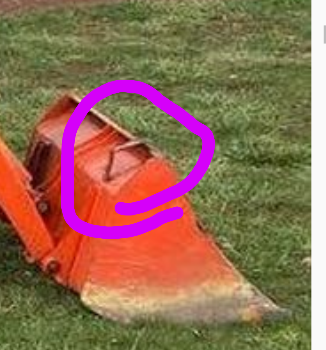

In case you haven't figured it out, that thing
is the level indicator. The top of it is parallel with the cutting edge. It helps when you want to skim the surface.

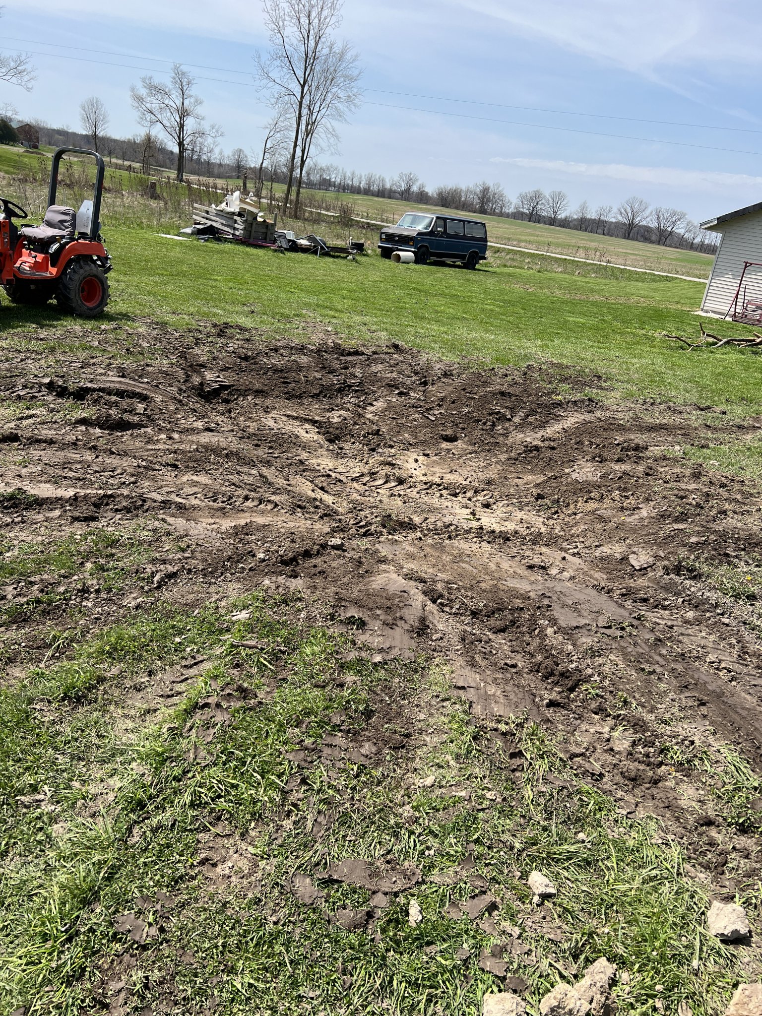

You will be able to do all kinda of stuff with the BX and FEL when you get the hang of it. Here are some Pics for you.
My land used to be farm ground so there was a spot that rocks had been dumped. Moved a bunch of bucket fulls, but finally used the loader to dig down below the rocks and will fill it in when I get a load of topsoil brought in. Gave me a chance to build up my backstop too.

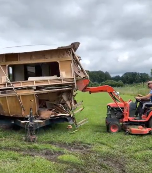

Demo'd my old/leaky 1995 camper

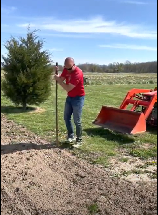

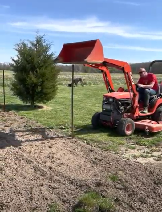

Besides digging with the FEL (which isn't always the easiest) I was also able to drive in the metal fence posts around my garden......along with clearing the area of brush, leveling with a box blade and tilling it too.
Looking back through my pics I realize I have way too many of my tractor projects.....
Stick the post in the ground and then drive it in with the FEL bucket.

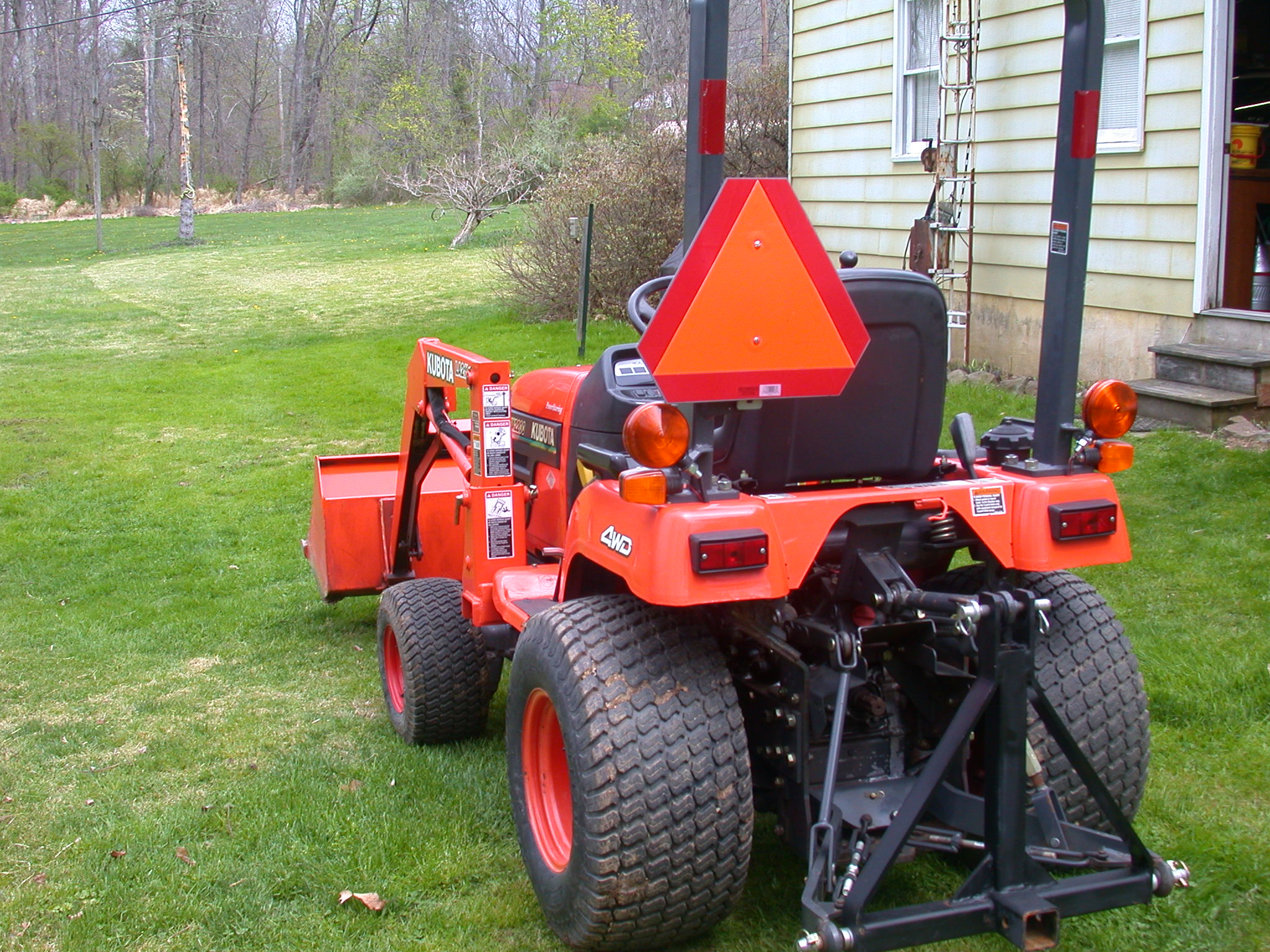

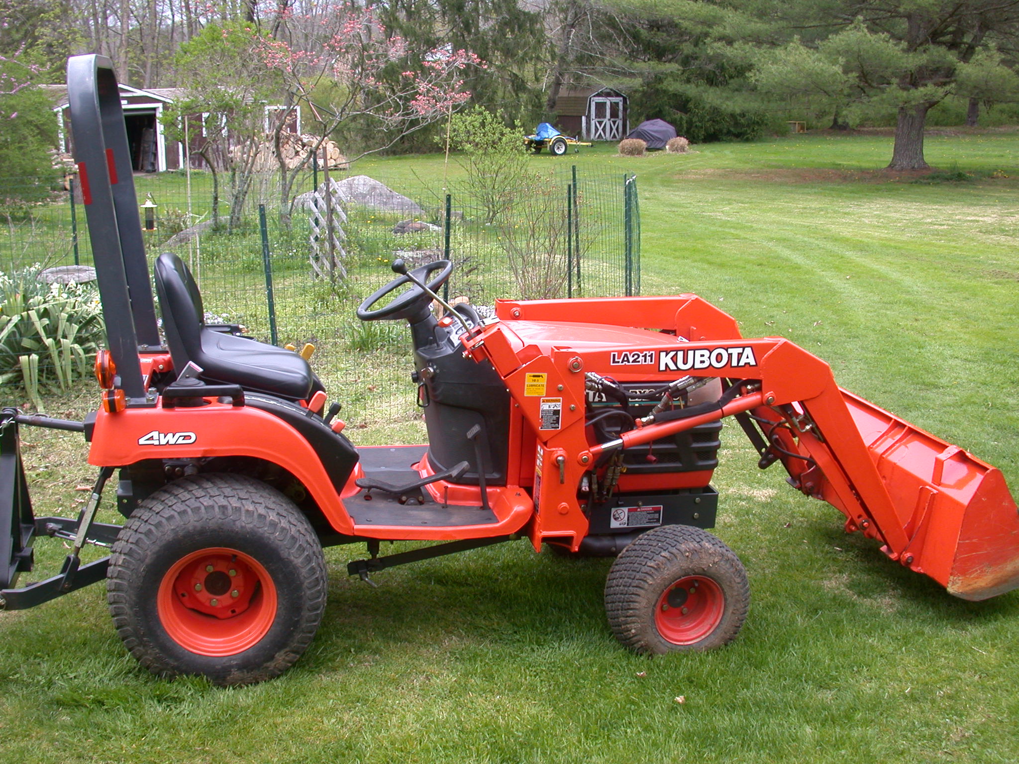

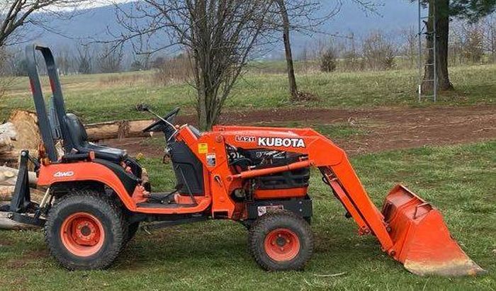

Yes to all these posts, I thank you. I'm waiting for things around here to dry out so I could get out there to use it. I really like this sub compact.
I think I made the right choice for my little 5 acre property.

One thing I noticed in your pic was your mmm.. "mid mount mower" linkage hanging down. You can raise your 3 point and set that vertical knob to "0" I'm pretty sure that locks that linkage up tight so you don't hang it up on something. Especially in reverse!
It won't affect your 3pt up and down after you set it..

Thanks for the tip, I'll try that tomorrow.

On my BX2200D the setting is TOP to keep the mower deck as high as possible. "0" sets it at the lowest position...
Just a small correction, at least as far as my BX2200 goes.
