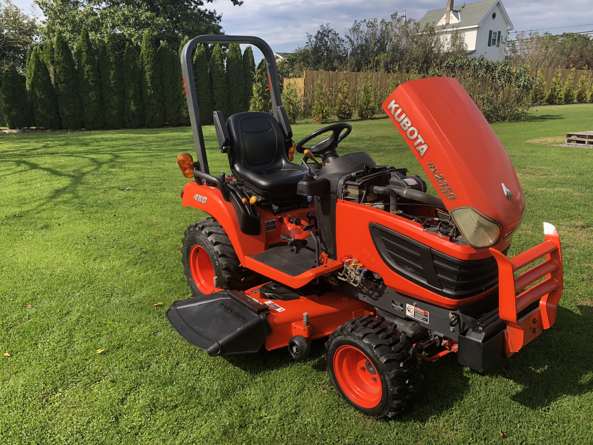

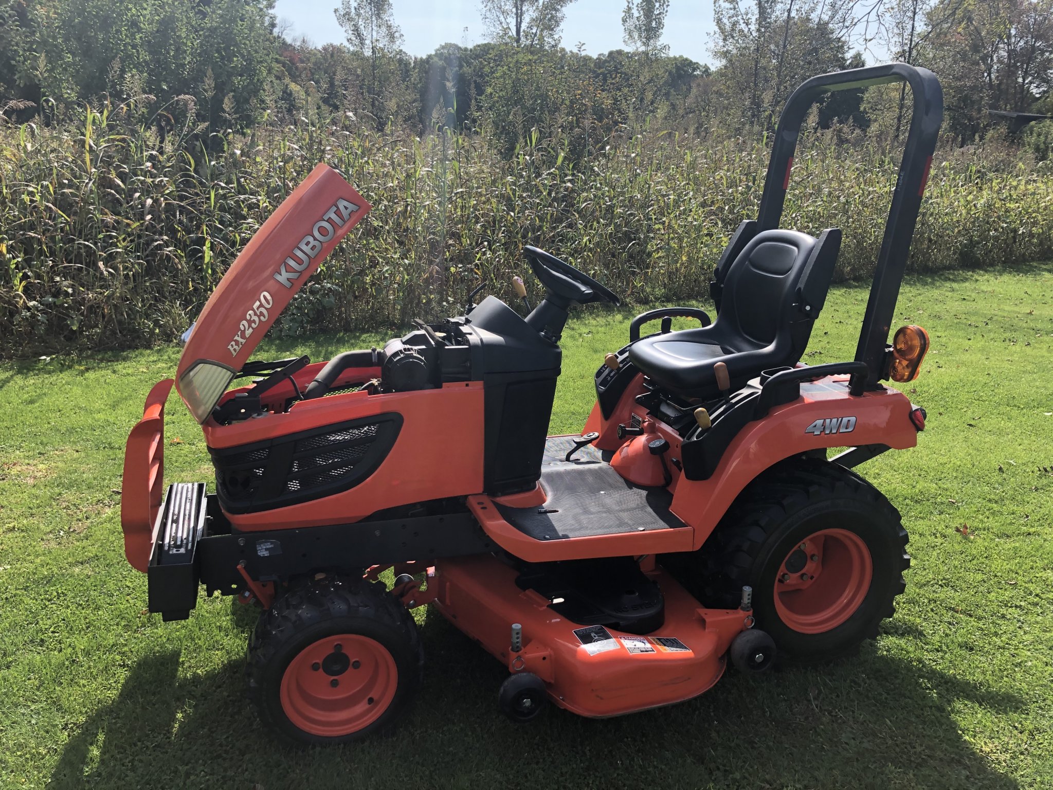

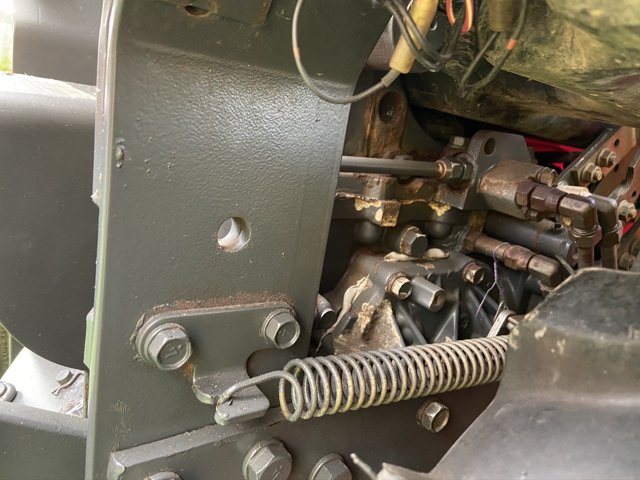

Long time lurker, first time posting.... Shopping for a BX or B, used and saw a 2008 BX2350 tonight with 995 hours. Saw this under the wheel well of the right rear tire - gasket? Does that protruding gasket mean this transmission has been ripped apart and resealed?

At 995 hours isn't all that bad for it's age but it sure didn't come from the factory looking like that. You are wise to take note. I would have to get some answers first.
Is it at a dealer or private individual?

Many thanks for the quick response! Private. Otherwise it looks cherry and seemed to work great.

That looks to be in very good condition. It's the plastic model, I have one, all my plastics are broken, I have about the same hours but the hours my machine has were way harder than what that looks to have had. Those are in good condition, but be aware the body panels don't like rough treatment. Having said that, mine has had the rough treatment, and while cosmetically it's ugly, mechanically it's never missed a beat. If I assume they treated it mechanically as badly as they treated it cosmetically, that's a good recommendation for the strength of them.
Looks to me like someone's had it open, and then been very generous with gasket when reassembling. In some ways that may be a good sign - they cared enough to put plenty on. Alternatively, it was leaking and they just put lots on to stop it - not such a good sign. Worth the question on what it was apart for, but not necessarily a deal breaker.

definently opened up at some time.
The bracket that holds the big spring has been off at some time....and some chipped PC paint 'here and there'. One potential problem with the generous goop is what happens when some of it INSIDE, breaks off ??
Definitely looks great, which drew me to it originally, and made me go back for a second look - when I saw this goop and snapped the pictures. Didn’t have a front end loader either, which to me means it wasn’t used hard. The owner got it from his uncle, as he says, and doesn’t have any records or documentation, and it seems as if the fluids weren’t changed since the last dealer service which was 2 years ago. After all these posts, my radar is telling me to steer clear.
Hadn’t thought of that. Really good point.
View attachment 49113 View attachment 49113
I would say this is definitely not as it came from the factory. That does not mean there is anything wrong, it may be good for thousands of hours. But I would ask the current owner and would need a good answer before I bought it. If the current owner does not know, I would walk.
