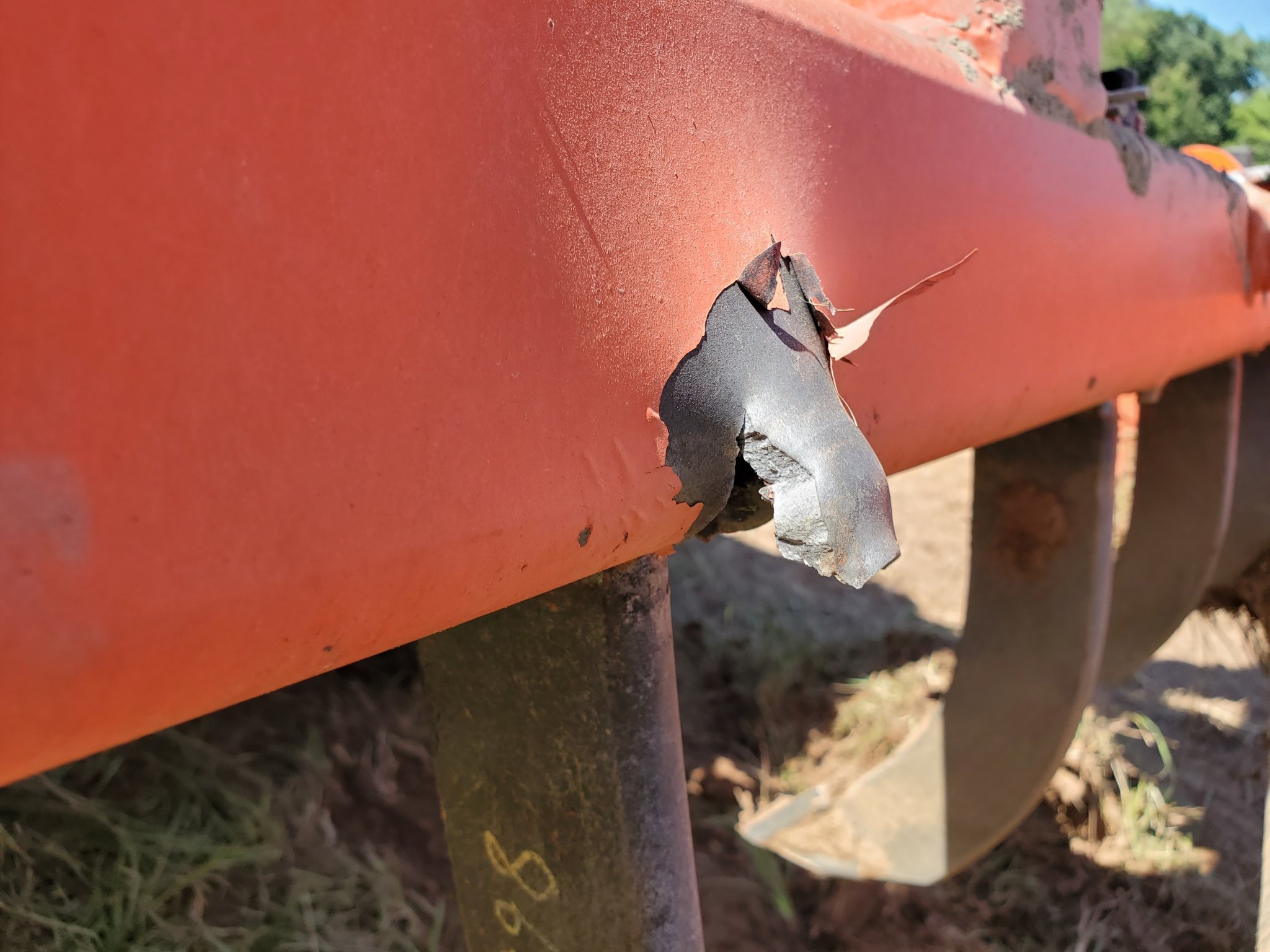

So I used my Bush Hog RG72 to straighten up my drive and the thing seems to be pulling itself apart. Any thoughts on the best approach to repair other than buy a better road grader?
I purchased the road grader in the spring and it might have 8 hours of work on it. The scarifier close up is the worst but the others are all showing signs of metal fatigue. The tractor is a L3901 so I dont feel like the implement is mismatched with the tractor. Service rep from Bushhog said they would not cover it under warranty.

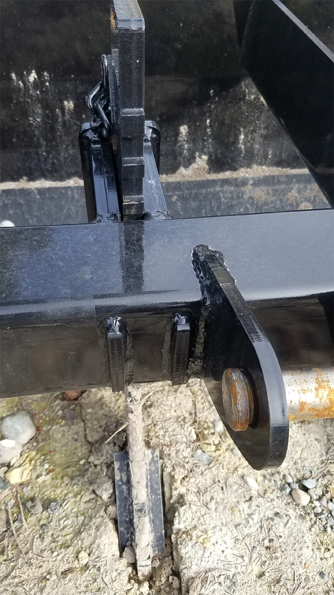

That's kind of annoying to put it mildly. I have a box blade and land leveler (land plane) from Everything Attachments and I like the way they design their products. They have a much stronger system for how they mount scarifiers and you could possibly do something similar, or simply reinforce the cross member after addressing the damaged areas. It wouldn't be much of a challenge to repair that implement and make it a lot better than it is. That would be your cheapest option I think. If you lived near me I'd happily do that for you for the cost of materials only. I like that sort of project.
You have to design this stuff with the expectation that one scarifier will be subjected to a significant load i.e. it's not distributed over all the scarifiers. Looks to me like that Bush Hog is poorly designed and built.
Here's the land leveler I bought from EA along with the box blade. Notice how strong their design is, and the fact that they use heavy walled tubing and good steel.

According to the parts PDF, the shanks are 3/4" wide, . The bar is 5/16" thick wall. each shank's contact area with the beam is then 3/4" x 5/16", so less than .25 square inches x 2 (top and btm. I leave it to the math wizards to compute how much force has to be transferred from one shank hitting a big rock through such a small area.
The 'tear out' is to be expected when you hit the 'unmovable object' aka a rock. My D-14 has a 'linkage' yo automatically put tractor into neutral when this occours. What's interesting is that a large area of the powder coat pealed off.

Might be an illusion but looks to me like the part of the torn material that would actually be contacting the ripper was not 'square' to it, and instead was a thin edge.. might need to see what is 'left behind' in the area directly behind the ripper to see if the rest of that material stayed there. Because having a thin edge is a good way to start a crack, and once it starts then propagating it is much easier.
But, me being me, what i would do in either case is just heat bang and weld it back in, then do a 1x1x0.25 angle across the entire bottom corner of that 4x4, with it seam-welded and the shape finessed a little at the ripper hole so that the ripper contacts it as evenly as possible. The rippers i've seen are rounded on the back and ideally, if you were gonna spend time on it, the shape of the metal that holds it would roughly match to distribute forces nicely. It would be 1 72" piece of angle, a welder, and a fair amount of work with a carbide in a die grinder, unless you get real fancy with a small angle grinder inside of a ~1x4" opening..
But im not against the other idea of 'fix it' just back to sellable, and sell it. I dont know enough to comment on metallurgy but i know with absolute certainty that if going slow enough this will never happen again regardless of what brand we're talking about. Maybe im lucky in that my tractor can only pull with rippers down in low range, but i really have no desire to do it much faster anyway.
