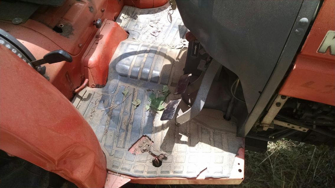

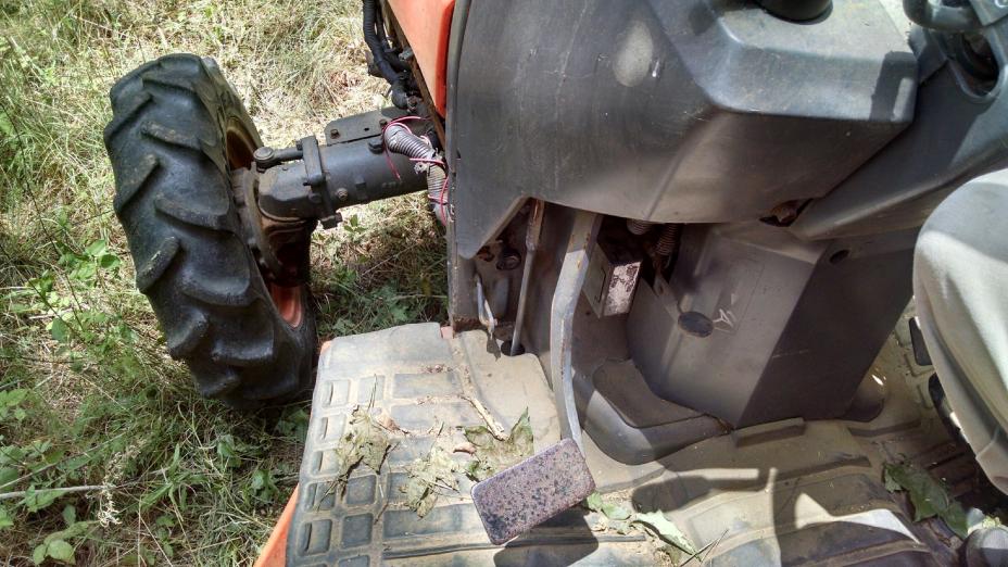

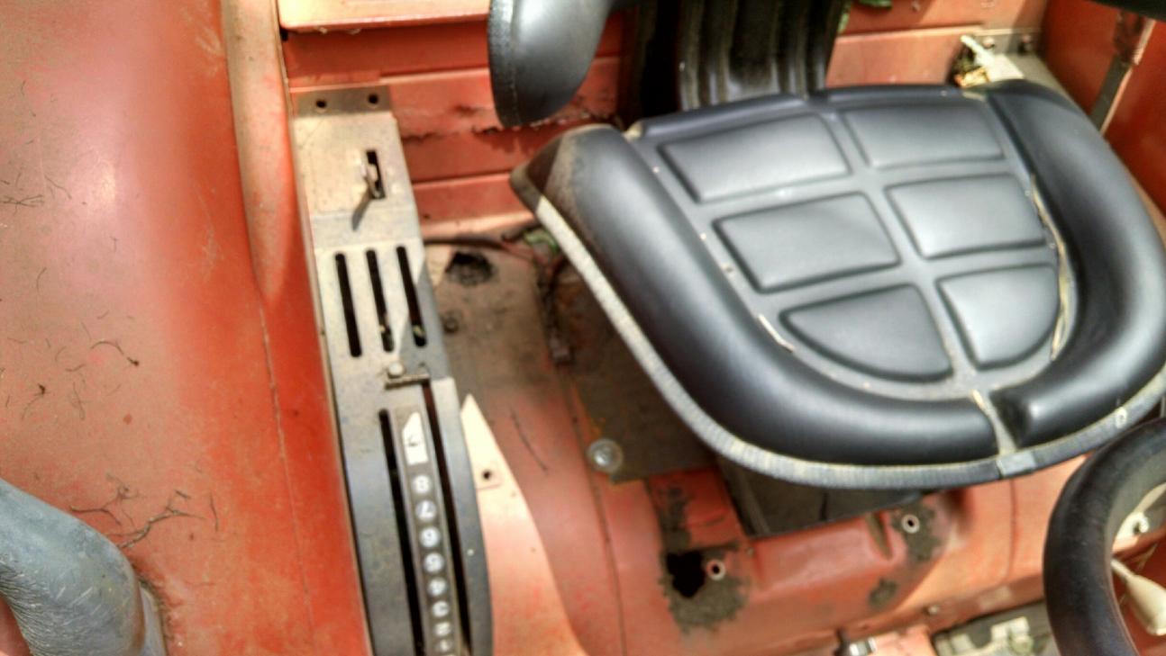

Well, I'm really not sure what the HST pedal is, or if I even have one. It isn't called out in my operator's manual and the pics I found online seemed to point to the throttle foot control? I took a couple more pics of the tractor if someone could point it out to me. I'm literally stuck right now.

You don't have an HST pedal! :p
You have a gear drive tractor, not a hydrostatic (HST) driven tractor.

Not that matters but that's an after market suspension seat. The seat switched would be bypassed! And whomever put the seat together put the seat bottom on backwards.:eek:
Pat
Haha, you're right! I didn't even notice. I realize I'm an idiot, but at least I'm not the idiot that put the seat together backwards.....just the one that didn't notice it :)
