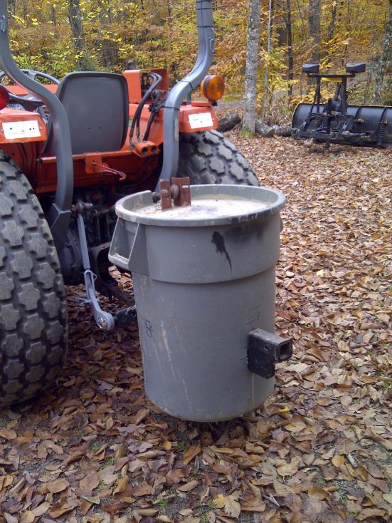

I took a 50 gal rubber maid trash can and cut 2 slots about 2/3 down and 2/3 to the front and slid a draw bar through it. I then welded and bolted a reese hitch on to it and let it stick out the back for small trailers etc.
I also bolted 2 pieces of 2 inch angle straight up and 2 inches apart to accept the turn buckle of the 3 point hitch. then filled the whole thing with concrete about 1000 lbs. works fantastic. also made a carry all for the back.
