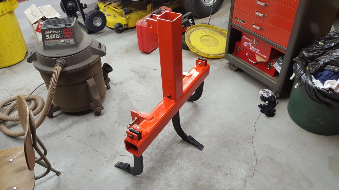

I looked at one of those rippers or subsoilers that are manufactured by heavyhitch and decided to build one. 3/4" plate and heat treated replaceable plate just in case.
So over the long weekend I decided to test it out. I have to say it performed very well. I was able to pull and cut through various size roots as well as pull stubborn stumps that have been bothering me for a while.
And then, pulling on one stubborn stump all of a sudden the tractor just went forward. Shoot, I already broke the thing. I looked back and all seemed ok, so came off the tractor and here is what I see:
Ripper is fine, but I just broke my hitch!!!!
High Lift jack, welder, brace, some paint and few hours later all was well again with the world.
Lesson learned "even when you overbuild your stuff, there is always something else that will crap out on you"

It's a pretty safe bet that hitch was designed for duties like moving a small trailer around a property and not for mounting ground-engaging implements. If there's something dragging behind the tractor that has the capability of hooking something and stopping it in its tracks, that's asking way too much of that hitch.
Look at even a cheap factory built subsoiler and study the design for a bit.

What you did was take half of a systems design and use it.
You need the entire designed system for it to work properly.
It would be like wanting a loader without wanting the mounts.
Or trying to haul a 10'000lb trailer with a Ford Focus!
There is nothing wrong with the design of the hitch you had, but it's designed for down force like a trailer tongue not up force from an implement.
You copied one half (the ripper), now copy the other half (the hitch) and it will work right. ;)

As to the ripper, based on my experience, I would be cautious with any hitch that has the receiver tube welded below the main frame, especially if there are no gussets, as most of the stress is absorbed by the the welds and not the whole frame.
Not good:
Better:
Of course, 3/16" tubing at minimum, 1/4" would be better.

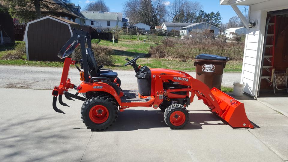

I have a 23 hp bx2370 the shanks are regular 18 inch box blade shanks I got them from agrisupply.com. I can pull all 3 about 8 to 10 inches deep thru our garden last spring in high range I don't recommend that found that out by accident oops lol. I was really suprised in how easy it pulled it the bota's got some power lol

For a deep going ripper like that you may want to incorporate a "fuse bolt" -say the top of the ripper is bolted using a 1/2" bolt and the lower bolt point is a 3/8" bolt -then the 3/8" bolt will shear and the ripper will simply fold up out of the ground if hitting something too solid.
I have a field that used to be an orchard and if I go deeper than 8" I tend to hit tree roots. Before I made up a fuse bolt system I damaged my hitch all the time. I used a 10mm bolt as a fuse bolt and it worked, where you are a 3/8" bolt may be easier to find than metric sizes.
