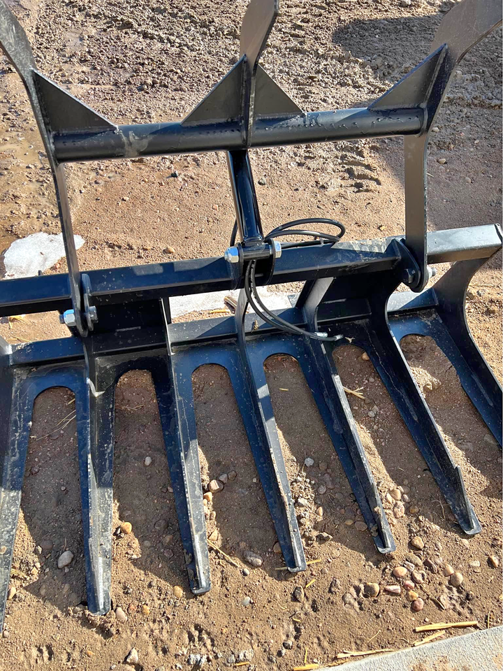

I have this theory, that if I can find a grapple similar to this one with long separated tines, I could pick up logs and saw them down to 16" lengths right on the grapple. That would save me one of the more difficult jobs of firewood harvesting, I think, which is getting long logs situated to safely buck them down.
Anyone tried this before? Have a reason to talk me out of it?

Neil Messick did a YouTube video to show different ways you can increase the pressure of your hydraulic system to very high levels with an uneven load. I think the pressure would dramatically change as you buck the log. I think you'd be better off lifting with log tongs.

I process around fifteen full cord a year of firewood and buck all of it with the grapple on my skid loader. Usually doing it with two guys one in the skid loader and one running the chain saw. I wouldn't buck firewood any other way.

Works great. Done lots of logs with a similar grapple on a Bobcat 632. Takes 2 people to do it on a Bobcat but a tractor and loader could do with one. Just need to watch not to overload the loader.

Excellent - thanks for confirming my thoughts, folks. The challenge seems to be finding a grapple shaped like this that isn't too heavy for my LX3310. I'll keep hunting...
