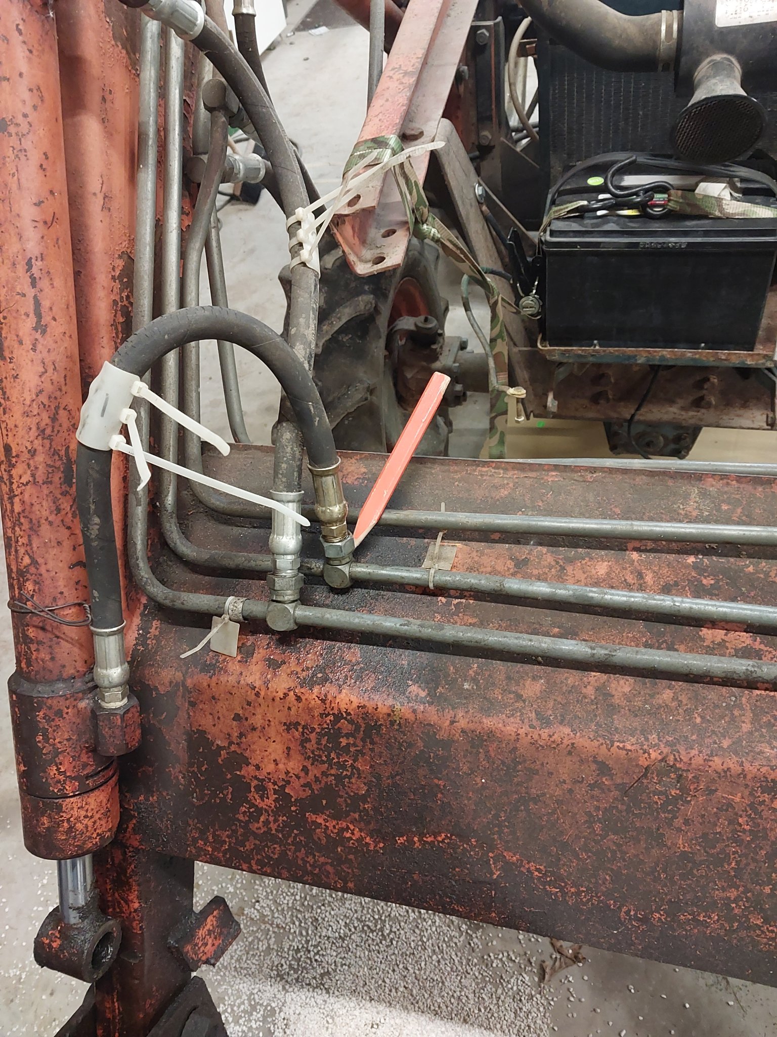

the metal line on the cross bar i took off the line going to the rod end of the right tilt cylinder.

Disconnect thw two bucket hoses from the metal lines. Stick them in a bucket or can, start the tractor, and BRIEFLY operate the bucket control in both directions. You should get a steady oil flow from alternating hoses as you move the control from curl to dump.

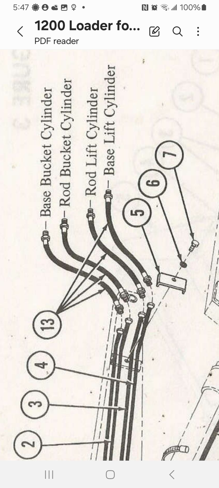

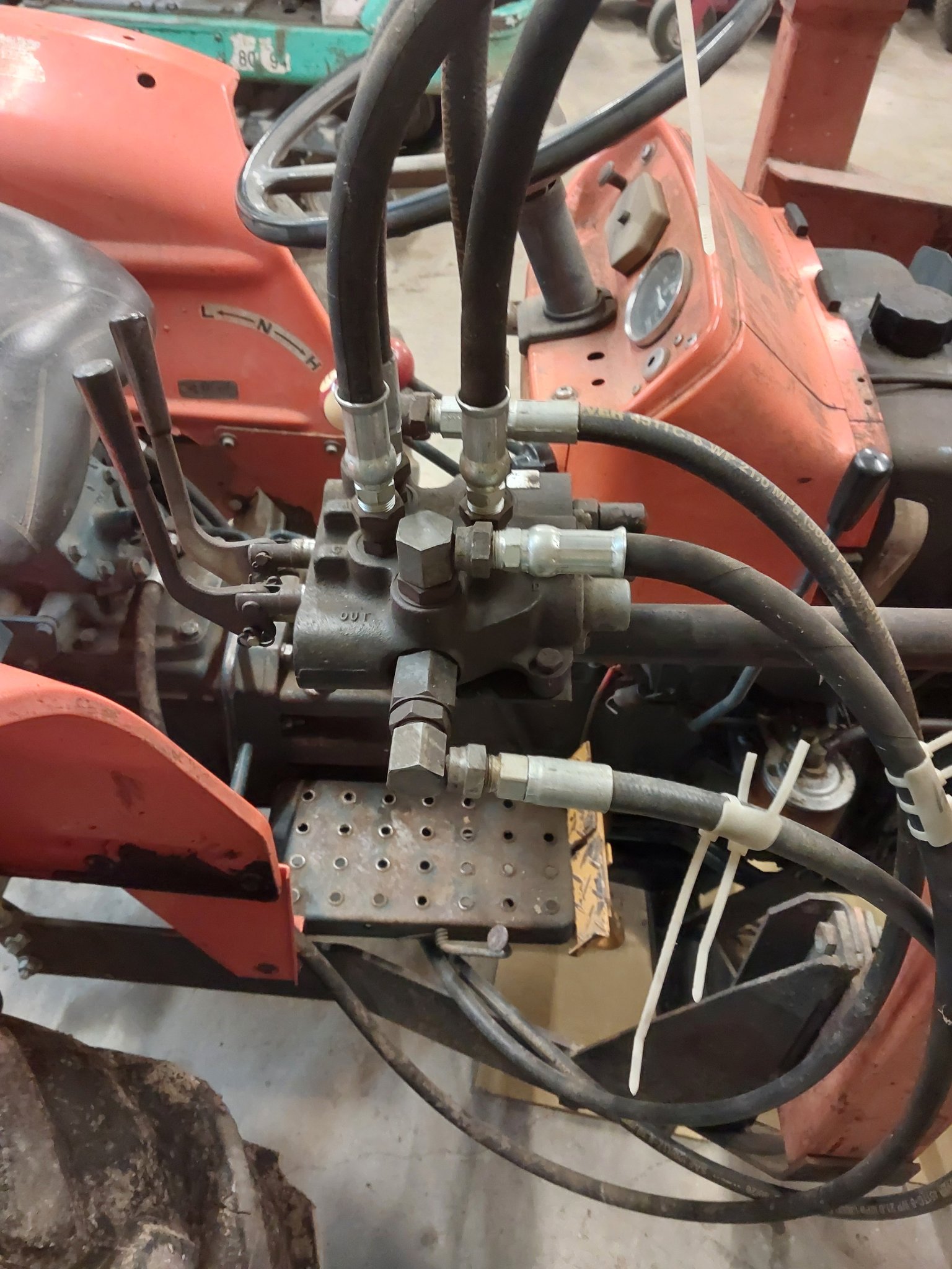

that is very possible that a line is hooked up wrong i replaced all the hydraulic lines , even though i tagged them all i might have got one mis marked. it is too far of a drive to do one at a time so i did all at once. i am retagging them so this weekend i can flush out all the lines and the control block to make sure something did not get in there while i had the lines off. i wrapped tape and plastic bags on the fittings when i took them off i might have missed something. the pics are the line i took off with weak flow, and the control block

The two top outlets in line witu the right lever are the bucket ports. As long as they go to the bucket cylinders curl and dump should work. If the lever action is backwards reverse those two ports.
I would say the chance of this being contamination are slim to none.
