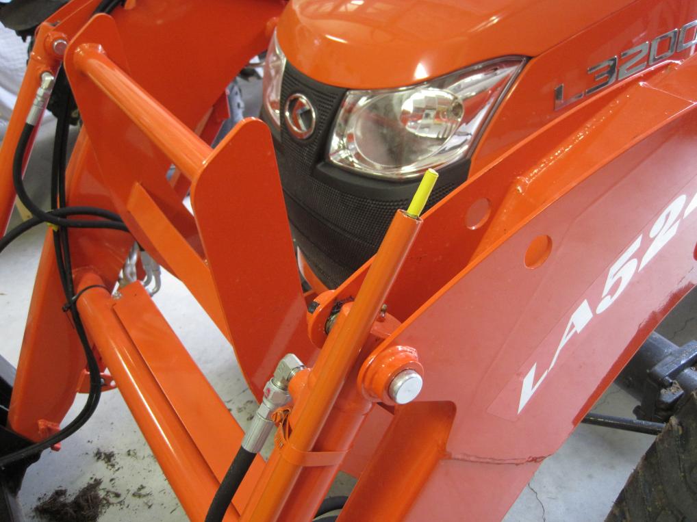

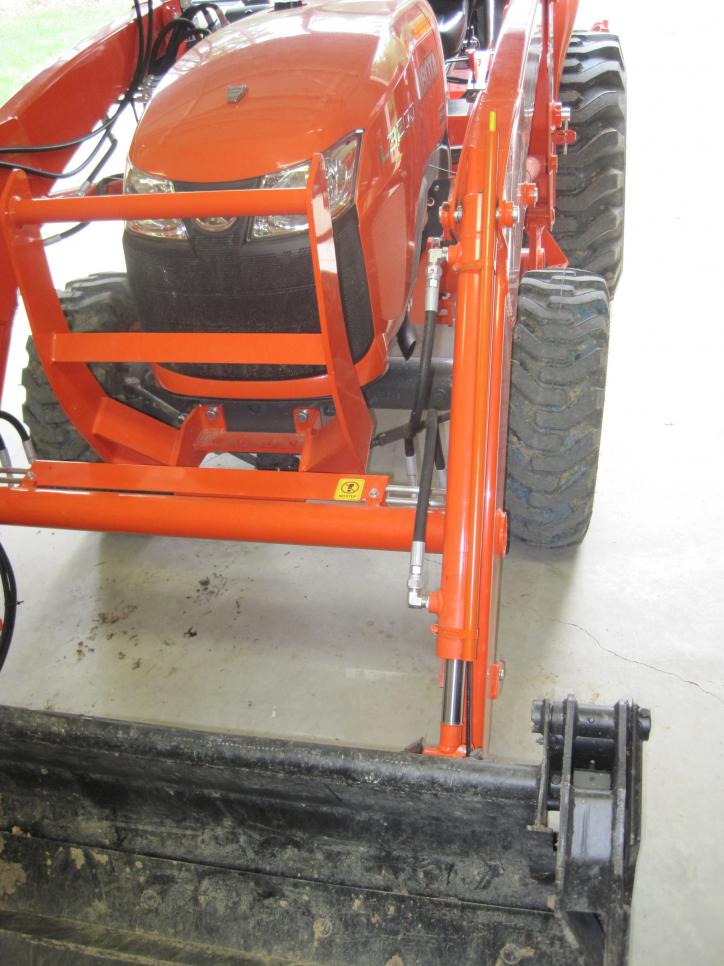

Hello I have a factory installed L524 loader on my L3200. My problem is it has no bucket level indicator.. Dealer said just line use the top of the bucket,sorta works in daylight not in the dark... So.. does anyone know of a aftermarket or a Kubota part??to add one.
Thats about the only thing this tractor lacks.. Thanks

this is just a factory level indicator..... I am sure you could fix something up along this line

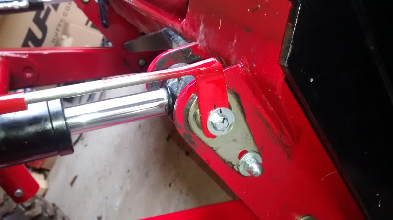

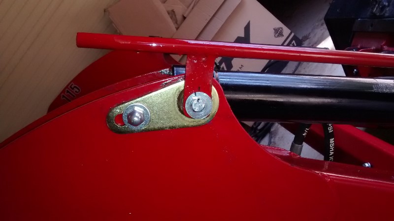

Mine is shown in the my2620 thread in the fabrication and customization folder, wildfire has his in the my bx25 mods thread

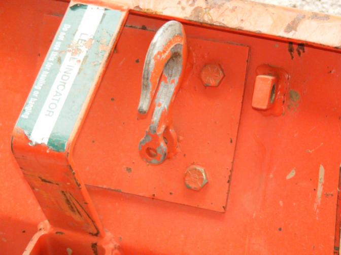

Kubota did offer a indicator kit for the LA524. Do not know the part number but my dealer wanted 60.00 if I remember correct. Was considering one for dad's L3800.

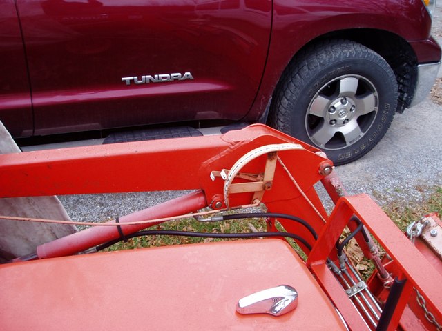

My LA302 came with that indicator on the bucket which I consider to be almost worthless with the bucket and totally worthless with forks. I built a mechanical level indicator several years ago that shows both level at ground level and at the current height.
The link going forward connects to the bucket and rotates the scale. The link going backward connects to the frame and move the inner indicator. The outer indicator is fixed.
