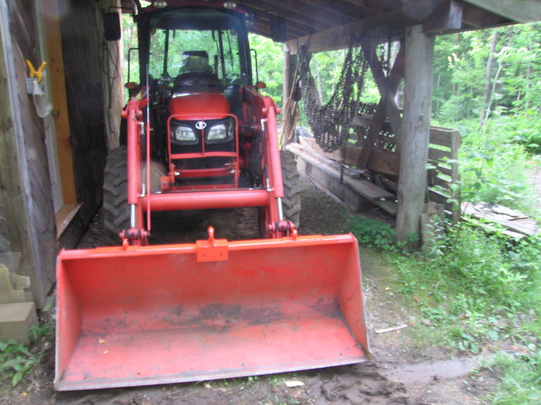

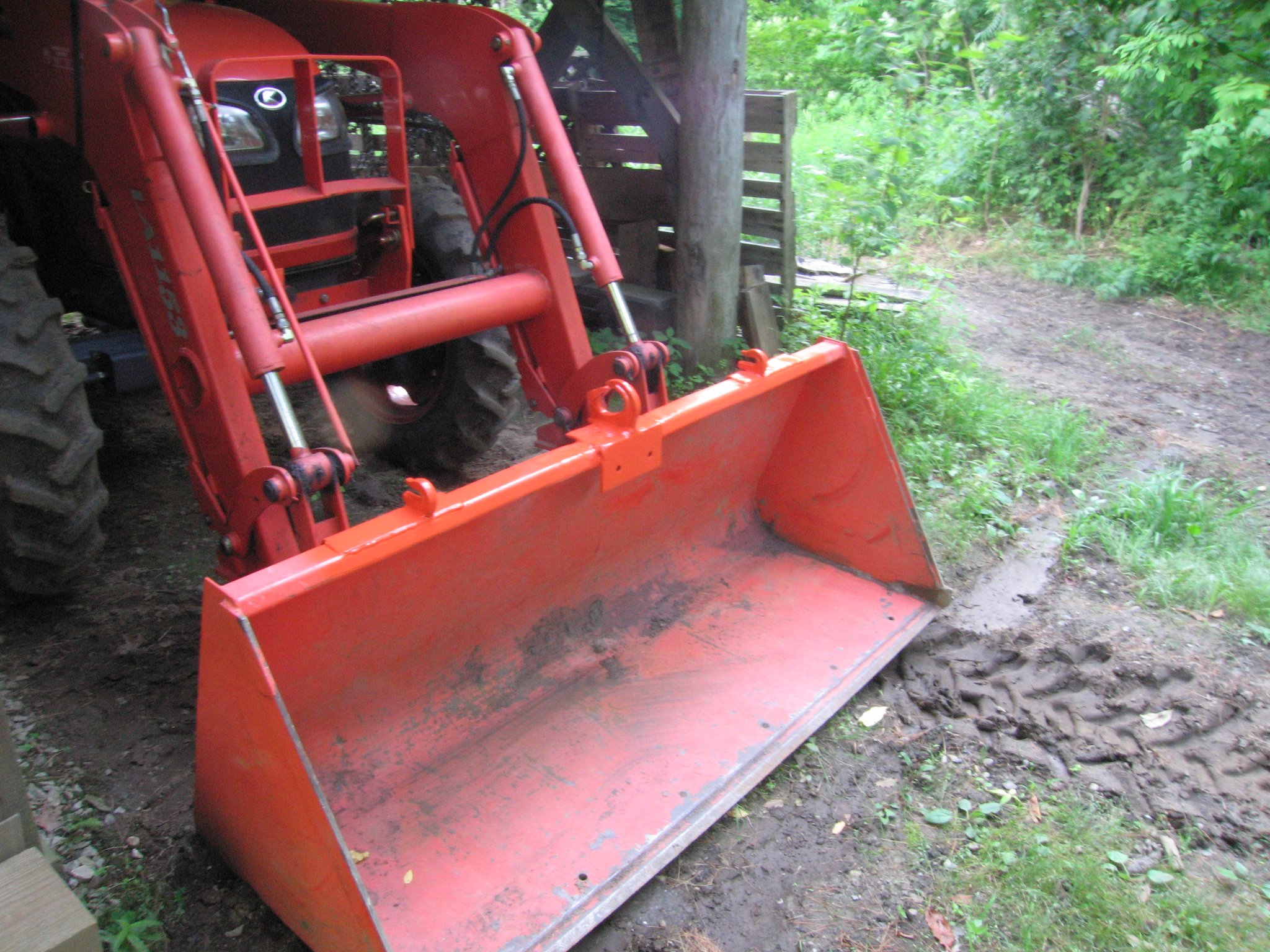

2012 purchased an MX5100DT with loader and rotary mower for our hunting camp. Had a single grab hook welded to the bucket center. Because the tractor might be operated by numerous individuals, some of which should NOT operate equipment, did not have hooks mounted on bucket ends for fear someone would use only one side and twist the loader arms. I certainly understand and agree with the reasoning for grab hooks on both bucket ends for additional strength as long as both hooks are used. I did provide our membership with written do's and dont's regarding equipment operation for what that is worth.

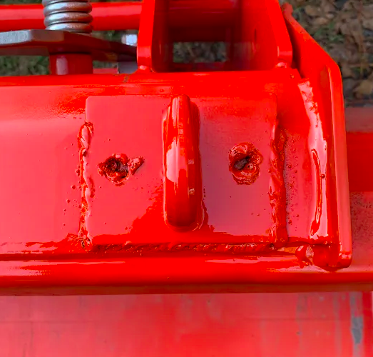

I know alot of folks disagree with mounting a single bucket hook in the center of the bucket due to possibly damaging the bucket. Attached are pictures on how I did my installation and help to strengthen the hook installation on my 23s. With the 23s not having alot of lift capacity, I should be good.
6,110
3,400
That is a clever solution. If I only had one hook, like yours it would be in the center and be a grab hook. 👍
