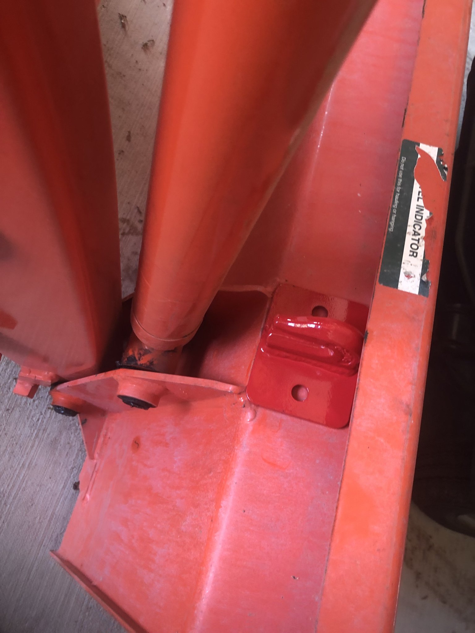

Thanks, everyone for the input. Here’s what I’m thinking. At the lift arm. Easy to drill. Out-of-the-way, but usable. I have some potential to bend the upper lip where the chain runs across it, but I don’t anticipate lifting terribly heavy items.

Place a spacer UNDER that - raise it up a bit, I had to do the same thing to product the lip ;)
9,909
4,064
You 'might' be able to put a section of say 3/16" angle iron under the lip ( upside down), drill holes in bucket AND the angle iron to bolt the hooks onto. The angle iron being full width of bucket distributes the load better than 2 'pads' AND keeps bucket from deforming cause we all know you'll want to lift or pull 'something' a tad heavier one day.......
You will be top loading the hook that way, and risk the chain slipping off. Either way, totally unsafe.
Pleased consider a local weldor to help you, or our hooks that are designed for buckets like yours.
(y)
+1 on this
That looks like a disaster waiting to happen with the position of that hook under the lip.
Either make a spacer, or buy the correct hook for that particular bucket.
