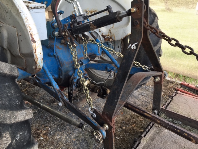

But I have seen a chain system used to hold the front of the mower in the same position consistently.
Look in this list for LIMITER CHAINS
These act to allow you to raise the mower and return to the same height as before easily.

This is what Russell is talking about. The loop is attached at the pins of the 3pt. implement (your mower). The top is attached where you ;in for the top link is. Adjust the chain links in the slot to get the height you want. You can then lift the mower when needed with the 3 pt lift a and release it to let it set on the chains to keep cutting.

Standard practice when using mowers on tractors without position control, e.g., Ford 9/2 Ns, etc., is to install limiter chains. Such chains attach between the mower and tractor top link attachment, one per side. The chains establish the low point of the three point arms.
