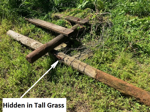

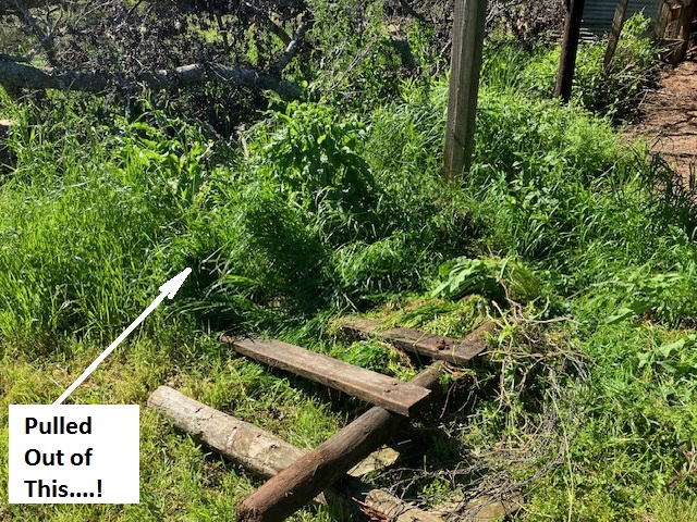

Speaking of hidden items:
Ran into this today when mowing around an old abandoned barn. No telling what else is in the tall grass around there.
I've never spent much time around the 'barn' in the 35 yrs. I've lived on this property. Might get around to tearing it down one of these years.
Thankfully, the bucket on the FEL found it before the rotary cutter did.

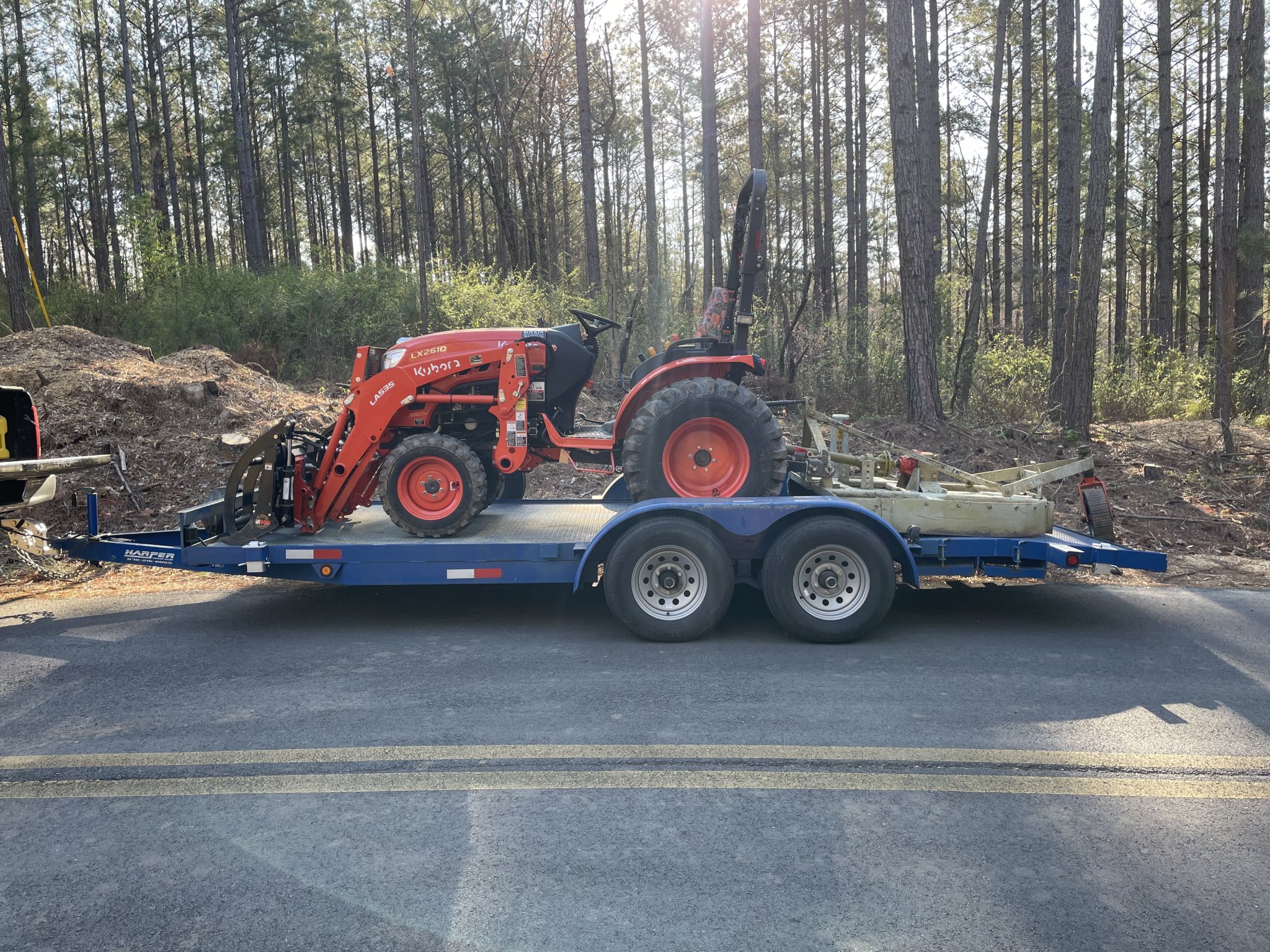

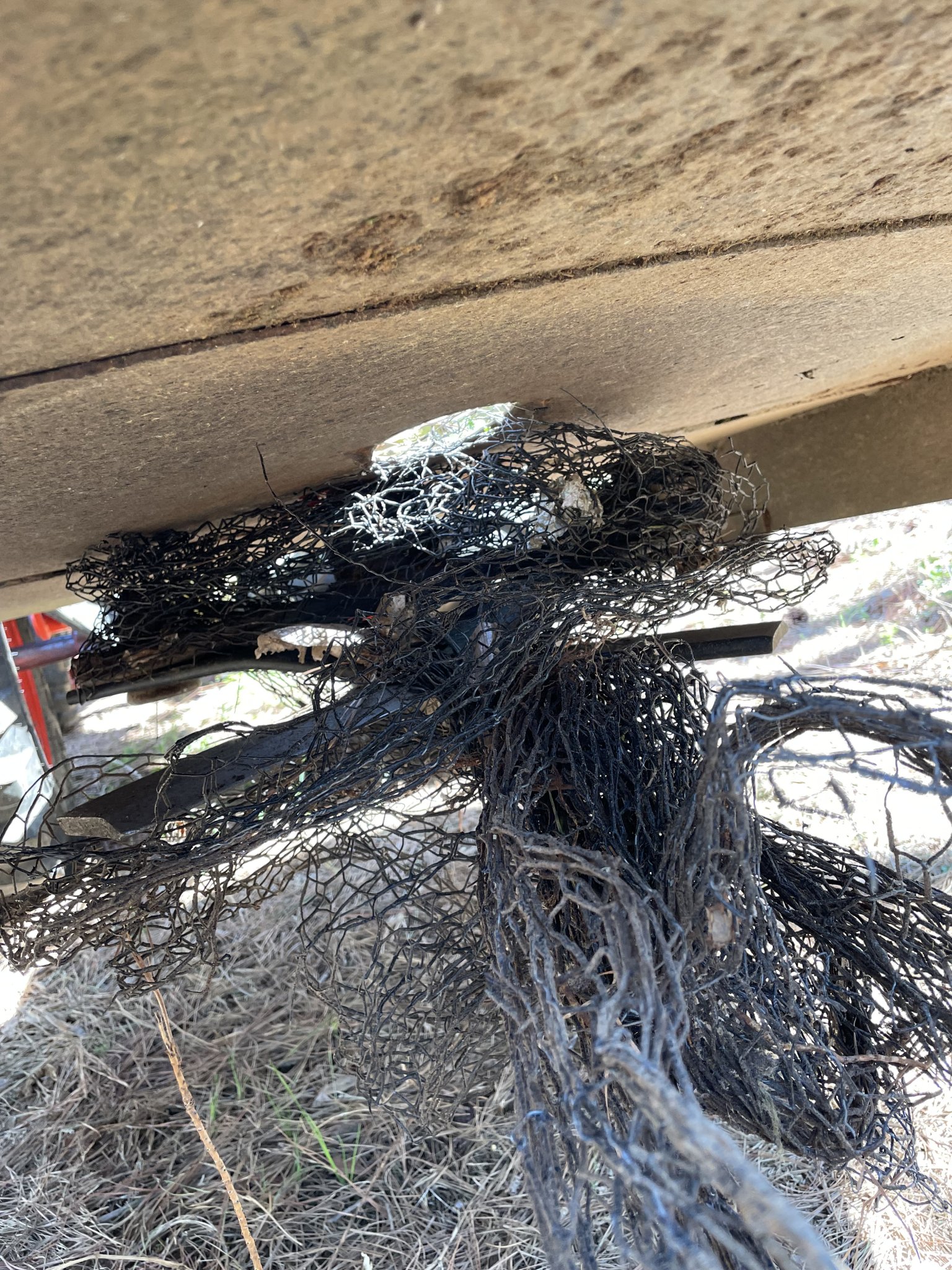

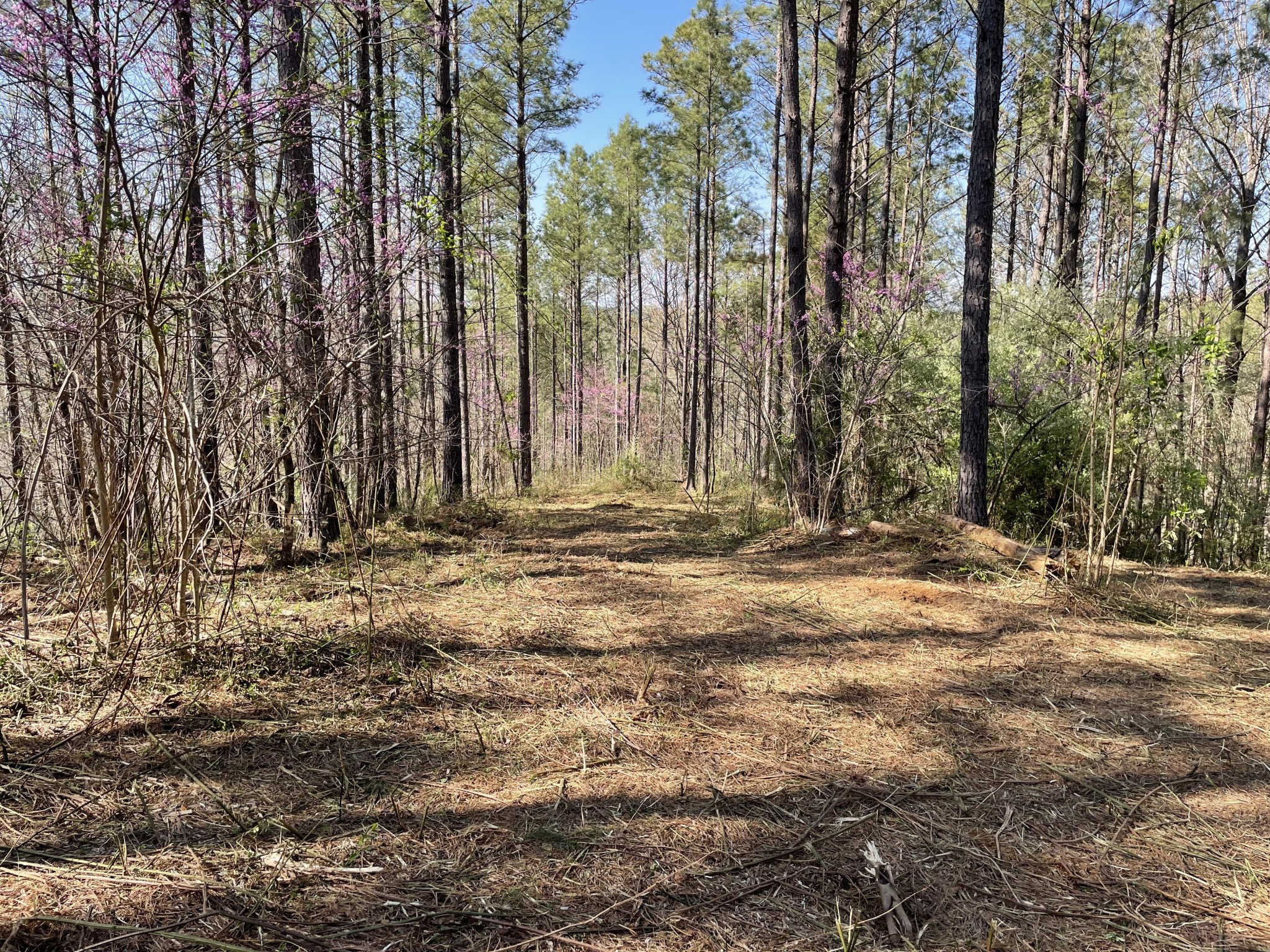

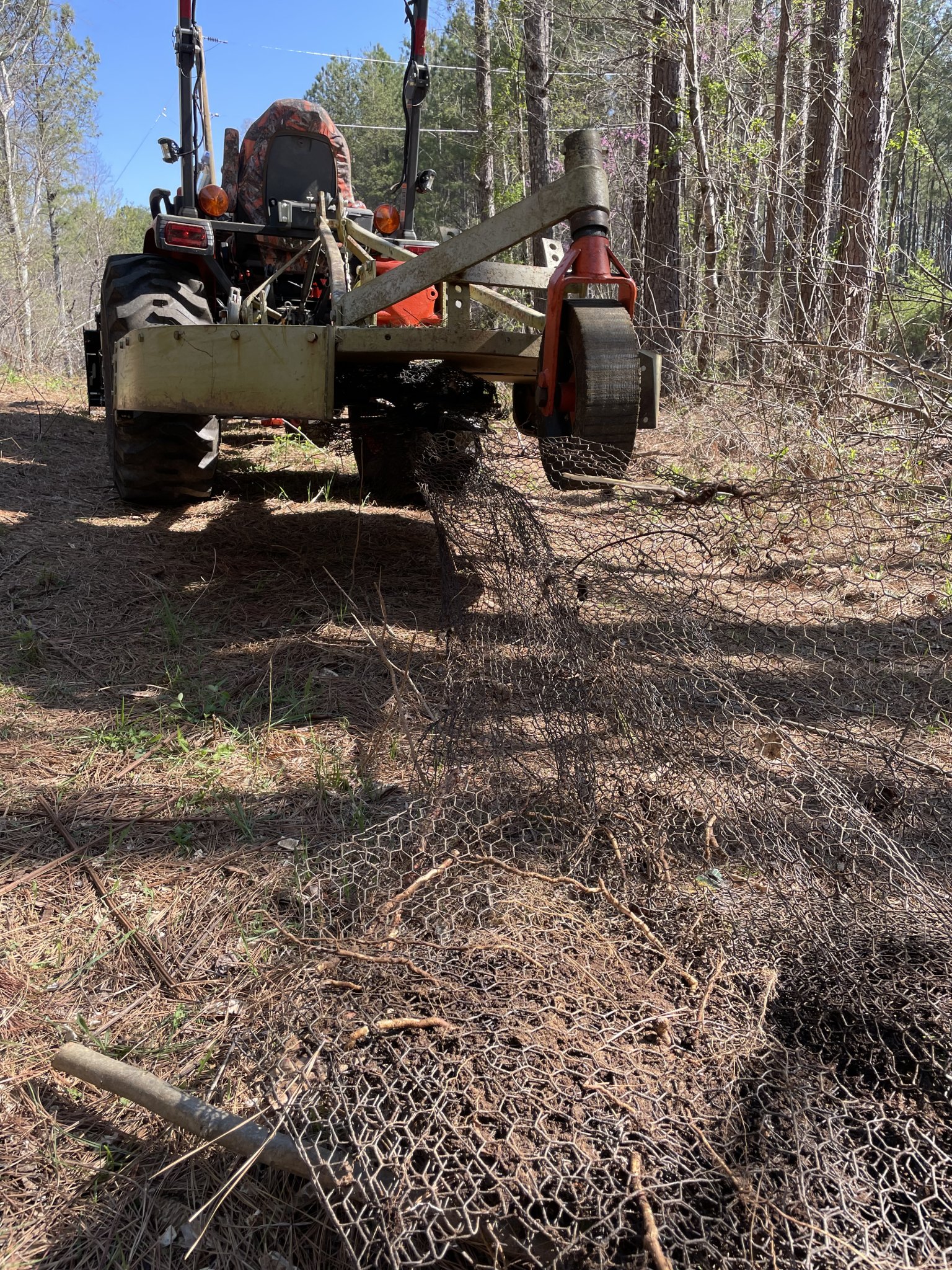

Well, I had huge success and a great time getting there. Took me 7 1/2 hours and cost one bent stabilizer for the lift arm. I decided to put the grapple on instead of the bucket and glad I did. I was able to roll it over to help push brush down while simultaneously feeling for hidden stumps or debris and it worked great. It also was huge to help get downed trees out of my way so I could keep cutting. My LX2610 was flawless and did incredibly well as usual. I have a very heavy duty 5 foot Sidewinder brush cutter that’s probably 50 years old, while backing into some thick brush a little too quickly I hit a low stump and that’s when I bent the stabilizer. The Sidewinder was unphased. It’s only nemeses was the chicken wire that got caught up and immediately stalled the cutter and tractor. Thankfully it only took about 15 minutes to cut it out and get back to work. Pics of the land never really show what it was really like but here’s one along with my chicken wire choker. Also a pic of an 18 foot dovetail with LX, grapple, and cutter in case anyone wants to know how well it fits (the wheel just hangs off the back a bit…and of course everything was secured for travel…I just wanted to avoid that debate).
