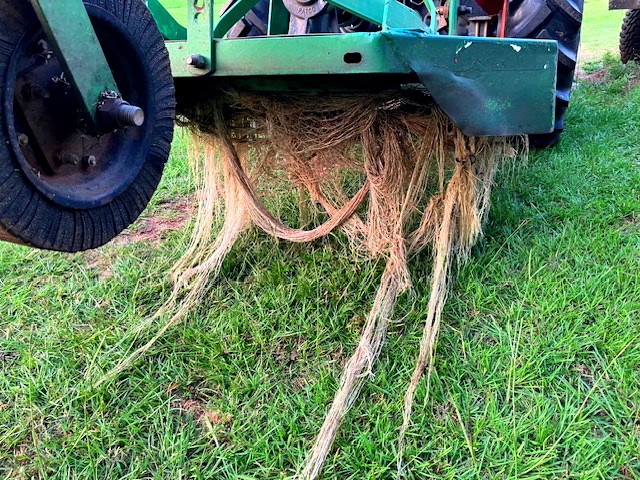

I found 3 steel antenna bases for a 100ft CB antenna that was in the field once, Oh and the coax cable. That wasn't fun at all!
Hay string netting I didn't see in the tall grass along my road frontage.
Took me forever to cut it out from under the mower.

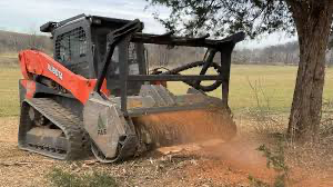

Rent one of these forestry mulchers, do all the clean up, thank me later
View attachment 124698 View attachment 124699
No question a mulcher would do the job and they are very maneuverable to boot. In the OP's case....he is only needing to clean up about an acre of land. Hardly worth the effort and expense for a mulcher in that situation.
In MY situation....I have about 25 acres in one spot that I am trying to reclaim/improve. I'd love to 'own' a mulcher for that purpose and future maintenance, but pretty sure the finance dept (Mrs. Flintknapper) isn't going to go for that.
Additionally, there are times of the year when it is too wet to get anything down there without getting stuck. So I wouldn't want to have to 'rent' multiple times to get the job done.
Currently....I just use my tractor as conditions permit. It helps that I am retired and can work on land clearing when I want to.
But man.....would I like to have a mulcher on a skidsteer. :)
You aren't kidding - a major land owner near me owns one and it was crazy how quick and well it did the job. I felt like I should pay him to watch it was so entertaining :p
Also, I've hit coaxial and netting - it was a long hard go untangling that rats nest
You can rent by the day!
Not worth buying one of these machines due to the abuse they see. When you rent it's 100% write off that year. Once you use one you will wonder why you ever wanted to do things the hard way.
I've done it the hard way using root rake grapples, BH, chainsaw, chipper. After you pull the roots of your brush you now have piles of wood, rocks and soil to deal with. You also have to re-level the ground you ripped up if you plan on maintaining the area with a mower later.
Instead of a several step process and lots of your time and fuel, one person on a forestry mulcher can level and clean up everything in one pass and turn wood/soil/small rocks into soil mulch in a short amount of time. At the end of your rental day your land is ready to maintain with your lawn mower.
