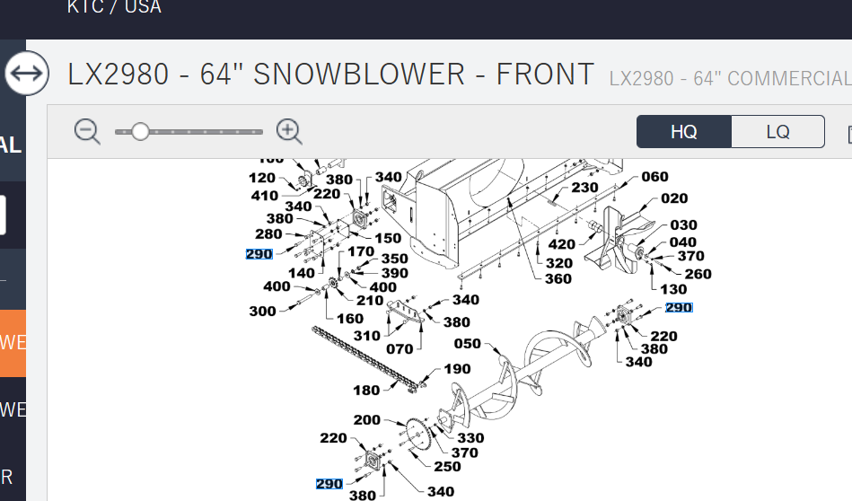

I might try a large pair of Channel Locks or C-clamp on the flanges to re-orient. The auger side should be moveable. Looks like its one-piece.
Is there part of the shear pin stuck in there restricting movement on the auger side, or are the two sides jammed together? When you hit the stone did it bend the snowblower housing?
PS - - I misread the parts diagram. Shear is not where I thought it was. Still might try a C-clamp...Auger side should rotate freely.

By the looks of the parts diagram, you shouldn't need to move the PTO gear on the tractor to move the auger side of the flanges.
Absent the shear pin, the auger should rotate freely, but understand there's two sprockets with a chain drive on a 64" auger.....might not move without some effort... ;)

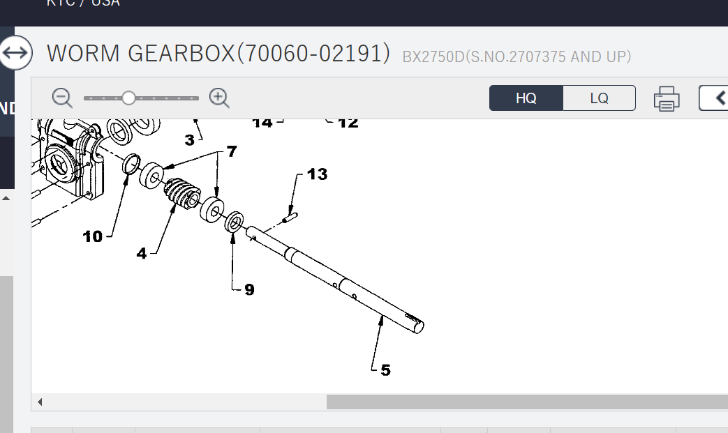

DustyRusty - - I have an older BX2750D blower and have wondered about lack or zerk between the fan/shaft.....
I haven't had to pull the fan, so haven't dealt with it.
Can see the bushings on each end - - part #4.
Bet it could be hassle to pull the fan if there was corrosion in there....
Hard to tell from the parts diagram, but there is a hole in that shaft, just forward of the snap ring.
Not sure if shaft is hollow or hole threaded? Might be a place to thread a zerk in?

Yeah this is the existing hole in the shaft as I edited my first post.
Even if a zerk were there, don’t think it helps much either., for the reasons you mentioned.
PS - - looks like there might be another hole in shaft to allow grease to get between bushings and fan/shaft.
Still not sure of great benefit, as bushings are only contact point as you pointed out. Probably easier to drive off....Might be reason zerk was eliminated.

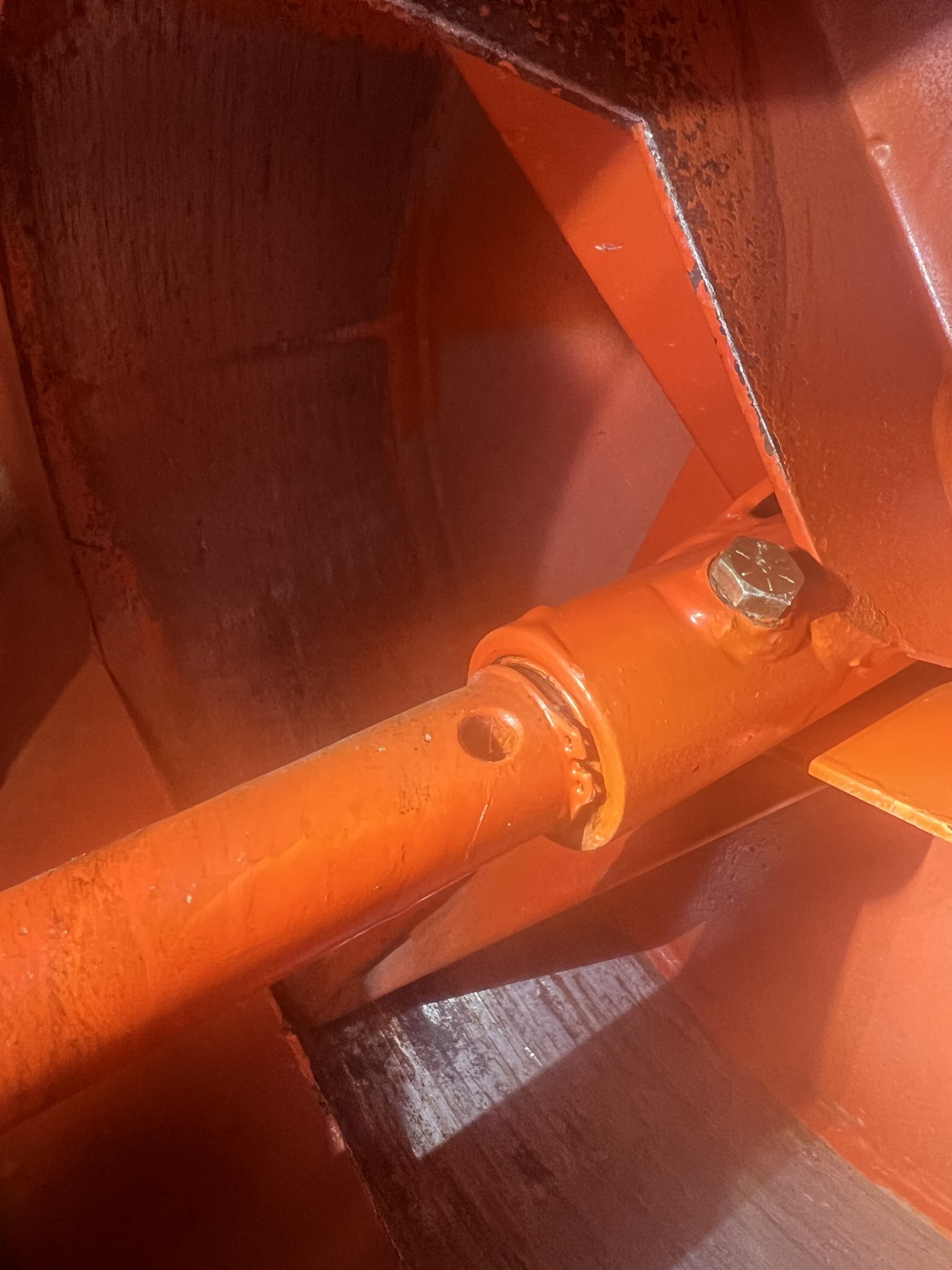

We are discussing 2 different animals here. The fan on your tractor is pinned directly through the shaft, and on the BX2750 there are 2 flanges that line up like on the auger ends on your snowblower. It appears from the hole in front of the clip that keeps the fan from moving forward when the shear bolt breaks that the shaft is used for more than one model snowblower.
