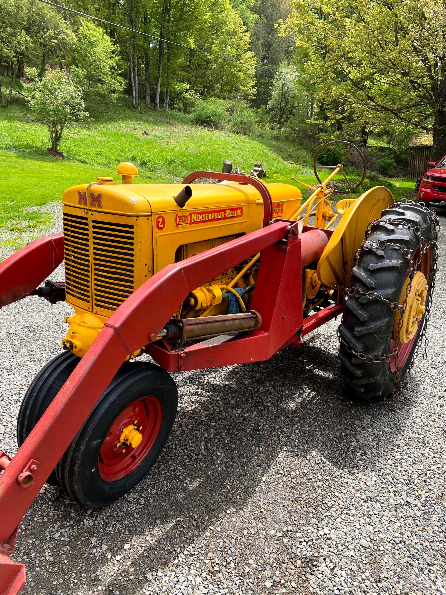

I started driving farm tractors at 6 years old, but admit it’s been years since I did that routinely.
At 7 or so, I could back this and a manure spreader down a barn floor.
