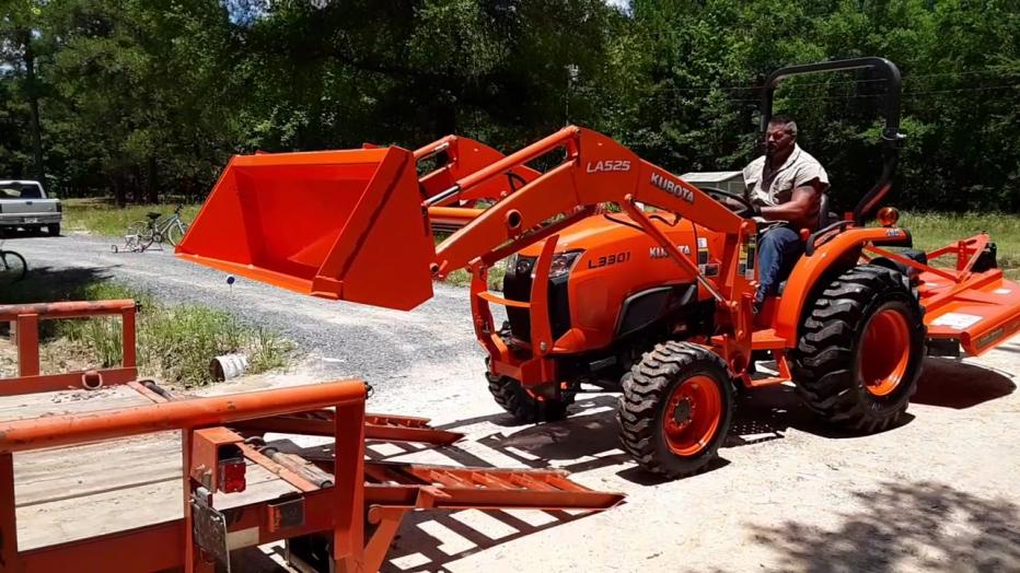

Brand New to Tractors!!
malenurse13
Kubota L3301 with Front Loader and Rotary Cutter
Jun 7, 2019
Vivian, LA
I have never driven anything larger than a lawnmower. Now I have a Kubota L3301 with Gear-Drive Transmission. I have a front loader with quick detach bucket. And I have a rotary cutter on the back. I have NO IDEA what I can do with this tractor and what I can not. I bought the 33hp because my friends and neighbors all said 25hp would not be enough for my property. We have 6 acres that has been cleared and brush-hogged by the previous owner. So I have plenty of acres to mow. And I've got a good bit of dirt to move around. This is just me saying hello! And let me know what resources are available online to help me learn the basics and the limitations of my tractor. What can I do with that front loader? And what common mistakes should I avoid?? Thanks!

Welcome to the FmyMoney Support Group. It's pretty great. Go ahead and have utilities come out and mark the No-Play-Zones. And THIS will be one of your best resources. I'd recommend finding your own limitations. It's the funnest way to find out. That's a pretty solid machine, I doubt you'll be disappointed.
Sent from my SM-G973U using Tapatalk
14,345
6,591
With any tractor with a loader always be aware when the loader up up in the air the center of gravity goes up with it. Getting into any situation where one front wheel drops down suddenly can cause problems quickly. The PTO shaft on the mower is also a thing to be cautious about.
You can find all kinds of Youtube videos to give you ideas. Go slow, be safe, and welcome to the forum! https://www.youtube.com/watch?v=TX5J5suE-Gs
Just about anything with the right attachments.
Keep the loader low to the ground when loaded.
If you didn't get a ballast box for the rear get one!
Muzzy
B2650HSDC
Feb 13, 2019
274
WNY
Congrats, Nice Rig.. Doesn't take long to find out what your machine can & cannot do. Start slow, get comfortable with operations, get to work & enjoy..
14,966
4,025
Welcome to the Orange,:D You have a nice rig there so you should be good to go for most anything you have planed. Remember, your little beasty is not a 988 so you will have some limitations. Slow and easy is the ticket, think each move through. Think on what you want to do, what tools you are going to need, think it all through and then think OK HOW CAN I SCREW THIS UP:eek:. And pretty soon things will start to become second nature to you.
Keep things as low as you can FEL low dont run with it way high up, that changes your center of gravity, you want to keep that low.
Just go slow until you understand what is going on, it is a learning curve everyone in here had to go through too. You will do well :D
Ask anything you want, and someone will come up with an answer, this place is like one big dysfunctional family

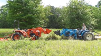

Neighbor
My neighbor brought over his 35hp LS tractor to show me all the grease points and just have some good ol' tractor talk. When should I do my first grease job?? The dealer said they lubed it up prior to delivering it yesterday.
SidecarFlip
Banned
7,182
557
Re: Neighbor
Loaders are every 10 hours and I'd grease the tractor at the same time. Don't forget the front axle pivot underneath. 2 fittings one on each side.
You need to raise your chopper a bit. t's not a lawnmower and never will be, it's a chopper. I run mine level not nose down.
6,393
2,037
Have you read the manual for the mower? It will give you some good information about how to set it up so you don’t bottom it out so easily. You may also need to approach the hills at an angle instead of straight over.
I have a fairly flat property so don’t have to deal with hills at all
