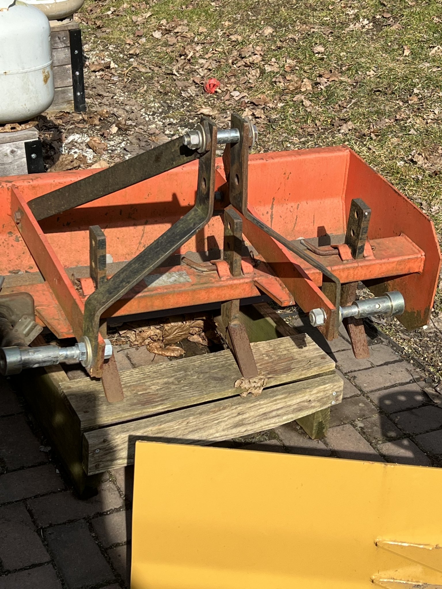

Any ideas?
Bought it used 10 years ago.
Not sure I did all of this, it's been out of whack for a long while.
I probably didn't help it when I added the long adapters to make it work with my quick hitch.
I seldom push in reverse, which is how this might have happened?
Done a LOT of work with this box blade. Probably my favorite implement.

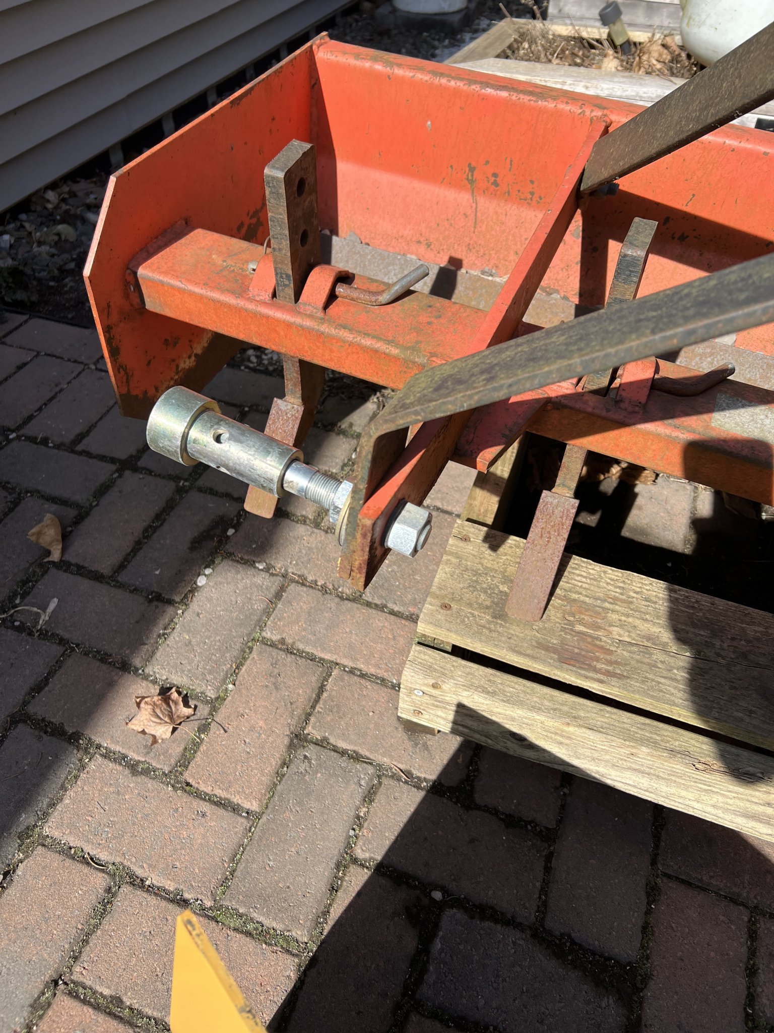

The piece that's bent is 1/2"x3". Other side is straight.
I'd rather not heat it and take tempering out. That's the main draw-point for the blade.

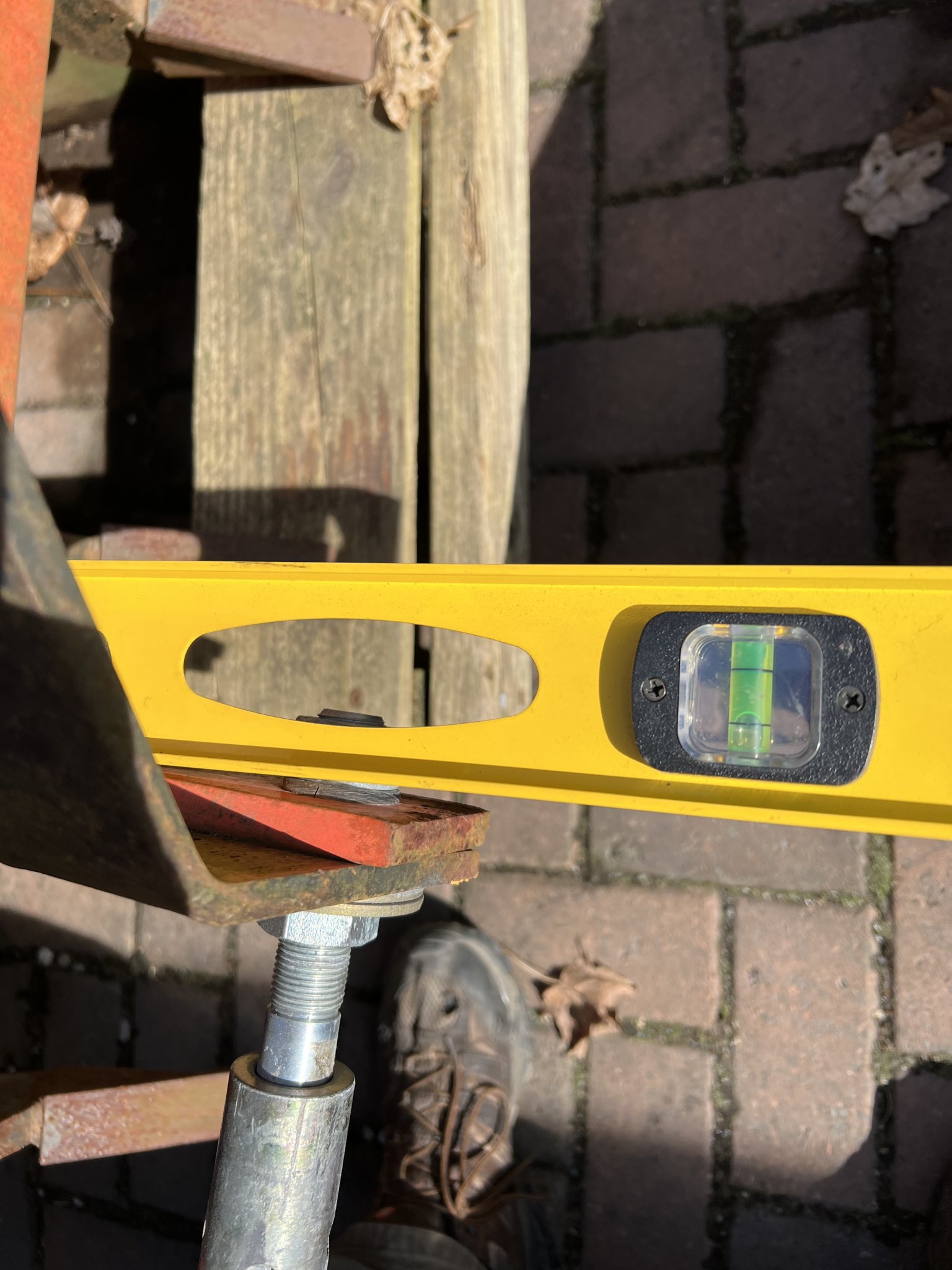

Left in photo is the bent side
It’s off 3/8” or so. Also not plumb anymore.
Plumb probably isn't a big deal if I can just get it straightened out.....

Put a piece of pipe on the end and bend it forward.
You can use a pipe wrench too.
6,046
3,330
Yep… The Wolf said it. Remove the nut, slip a long pipe over the pin and bend it back straight.

That type of design with the vast majority of all the force on those two sections of flat mild steel bar stock
will tend to bend flat mild steel bar stock.
Especially with the lengthened quick hitch pins.
Dull cherry red, it will straighten out perfectly without any issues.
Mild steel really doesn't have any "temper" so unless it's grossly overheated, no harm, no foul.
Hind sight engineering at it's best, it was designed and fabricated with a "price point" in mind.
If it were mine, after straightening, I might "scab" some flat steel bar stock on the inside, so as to "double up" the existing bars. You do have additional threading available on the pins for that exact modification.
Also, a piece of angle connecting the bars after doubling them up wouldn't hurt either. I likely have steel available, oxy-acetylene, and a stick welder. And a grinder for removing paint prior to welding.
Wire brush after welding, hit it with a rattle can and it's better than new.

I think you are going to find that it will bend back pretty easy using Wolfmans method. Then I would weld a flat bar across the two ends to tie them together and make a ‘box’ section to prevent this from happening again. Something the same width but doesn’t have to be as thick.

Guys - as always many thanks for the suggestions.
Started to gather pipe, pipe wrenches, etc. to pry it back.
Came across an antique jack my FIL had. Reminds me of Railroad Jack, but not that heavy. Maybe old car jack? (I’m around old cars all the time, but not their jacks.😉)
Top face is coved, and the radius was about perfect….
Worked like a charm….😉
Perfect? No, and it wasn’t when I bought it for $300 years ago.
As a former farm kid, I know they know how to improvise. This time it worked….sometimes it doesn’t.. 🥺
Appreciate the recommendations for improvement. I may box it as @Yooper suggests. Extending the width of the pin mounts is ideal like @North Idaho Wolfman says, but I’ll do the box as step #1 for now. I might want to use it this spring and don’t want it all apart.

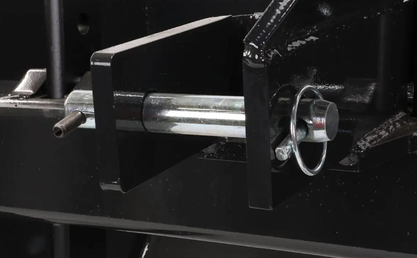

Another super easy and quick fix!
Add a tab outside the existing tab and change the pins and a bushing to get this:
Beat me to it! My Rural King/King Cutter box is built like this & was going to suggest similar to OP if he has the ability to weld. Doesn't need to be anything fancy, just a brace from the outside of the pin adapter back to the frame.
