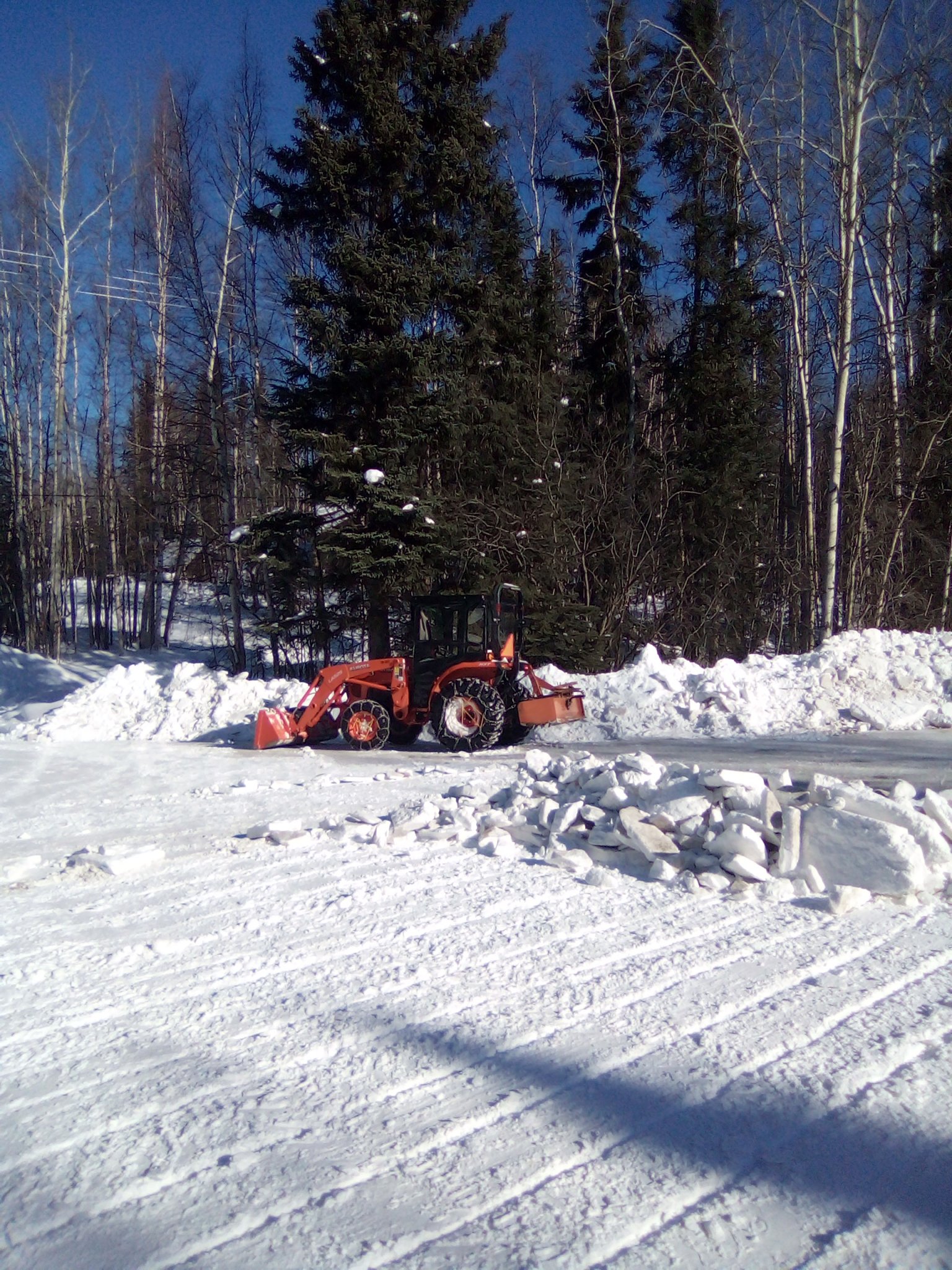

I combine the box blade and FEL. I use the FEL at about 3" off the ground and push snow while the box is all the way down. Each pass I'm pushing and pulling snow. Just before I get to where I'm moving the snow I raise the box. I back over what it dropped and use the FEL to push that into the pile. Granted the push/pull method takes some power and traction because both are carrying material and not just sliding it to the side ( like the rear blade at an angle does).
For me it's been a box blade hands down for snow and dirt. Even using the rippers to break up hard packed snow.

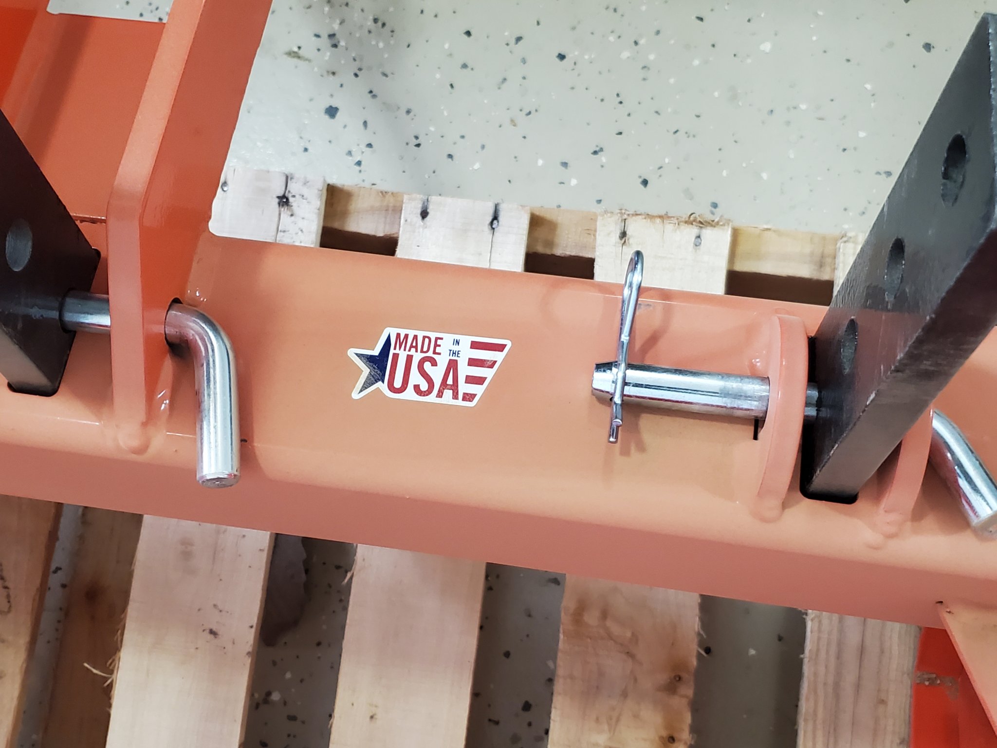

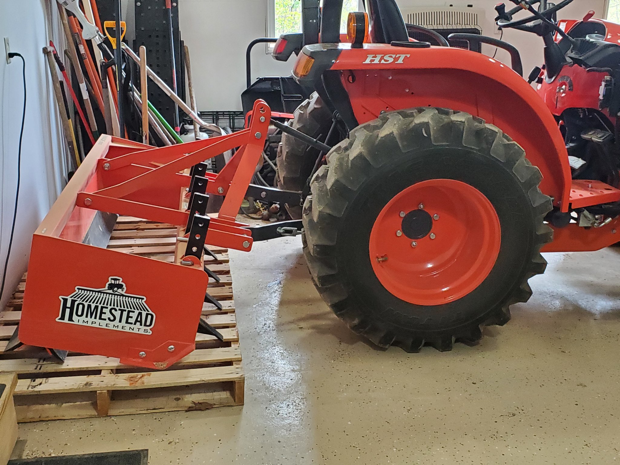

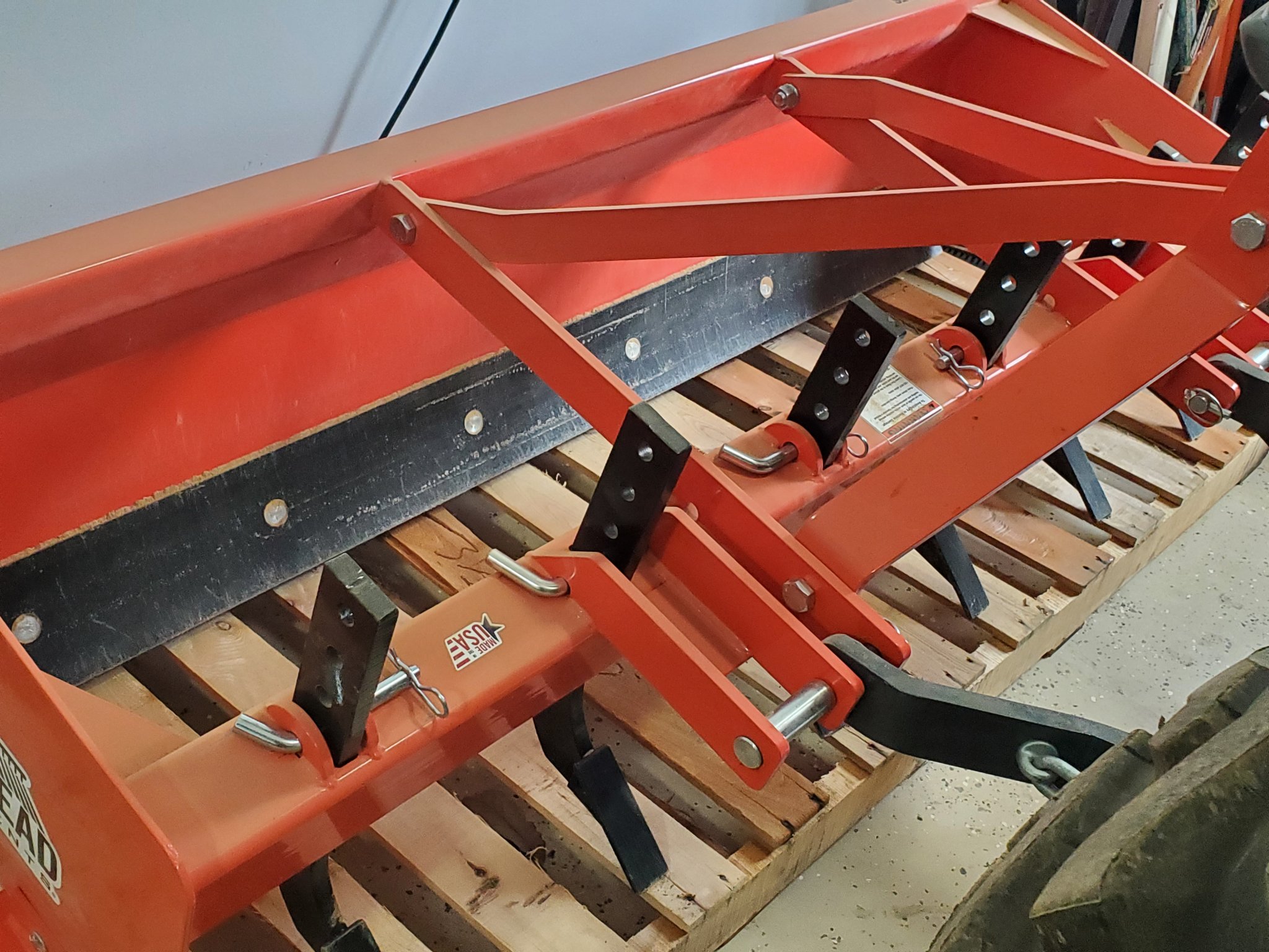

So, I went with the box blade. Ordered a 6' box from Homestead Implements. It arrived today!! I have to say, it is an extremely well built piece of equipment, and best of all, Made in the USA. Box blade 3.jpg Box blade 2.jpg Box blade 1.jpg I got it installed and adjusted, spent about an hour in the yard. I love it!! Exactly what I needed. Thanks to all for the input!
