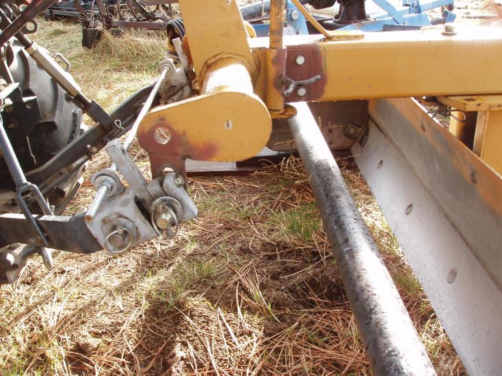

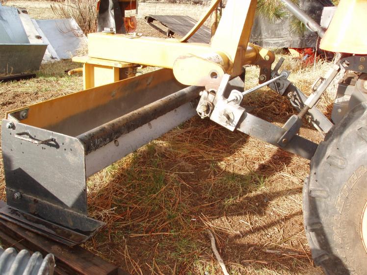

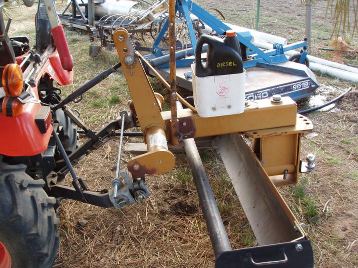

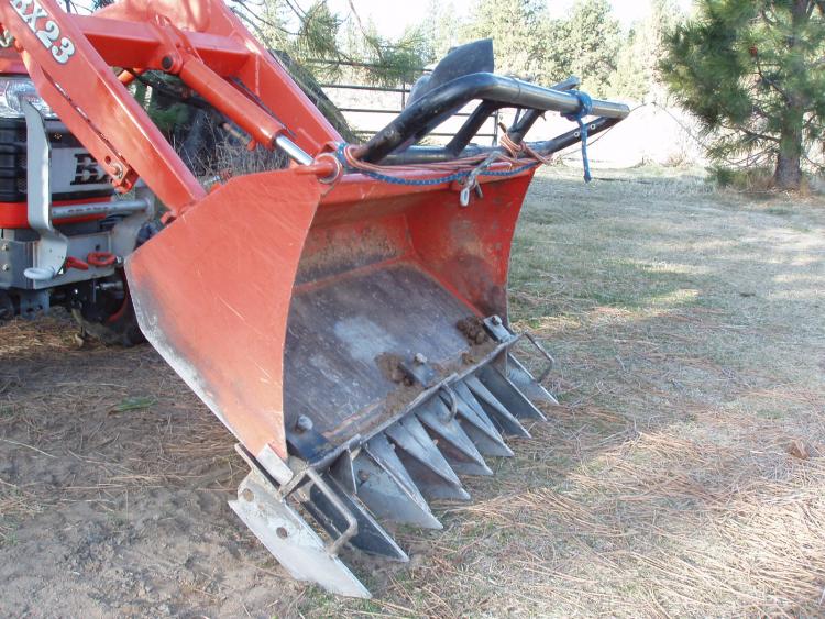

I have added a winged attachment to my blade that is easily removed to go from box to blade. A couple of square feet of 1/8" plate and a length of pipe
for the crossbar. I put angle steel on the bottom for skids to keep the wings
from digging in. Unit works quite well. Mounted using lower scraper holes on both ends, and two 1/2" holes drilled into the top of blade corners.
Also made were quick attach units to the arms. They seem to be holding up.
I do fabrication work. Semi retired construction millwright. I have other pictures of a jib type crane arm that fits front and back of tracter. Bucket attached snow plow. Note trailer hitch on rear of blade frame.
Ripper arms could be added if needed. I have not found the need.
I am a new member and this is my first post. Hope this helps.

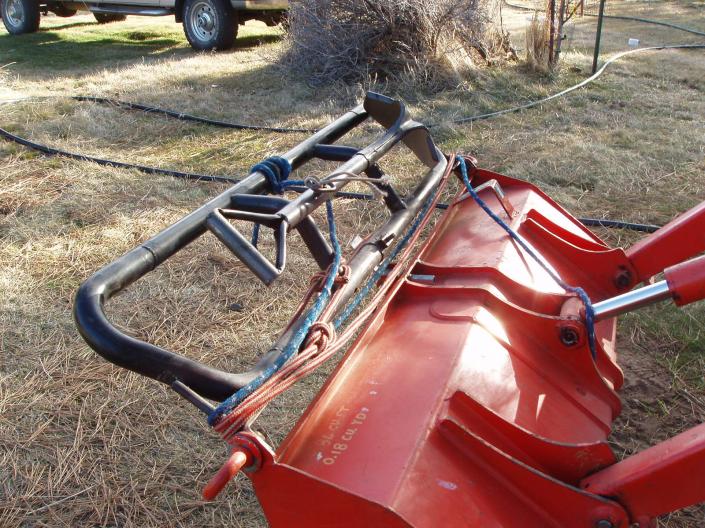

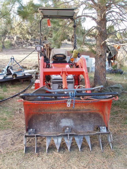

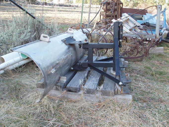

Here is a set of pictures. I only have a BX23, but it gets a workout on snow and rocks in our area. Its a workhorse.
rdeist
Bx23TLB
Feb 13, 2014
20
Bend, Oregon USA
This is the second half. Pic's show light/mirror mount, rock rake, bucket guard, snow plow, storage hooks, storage container on backblade. Items were made for convienience in field. So far all have held up to rough use.
