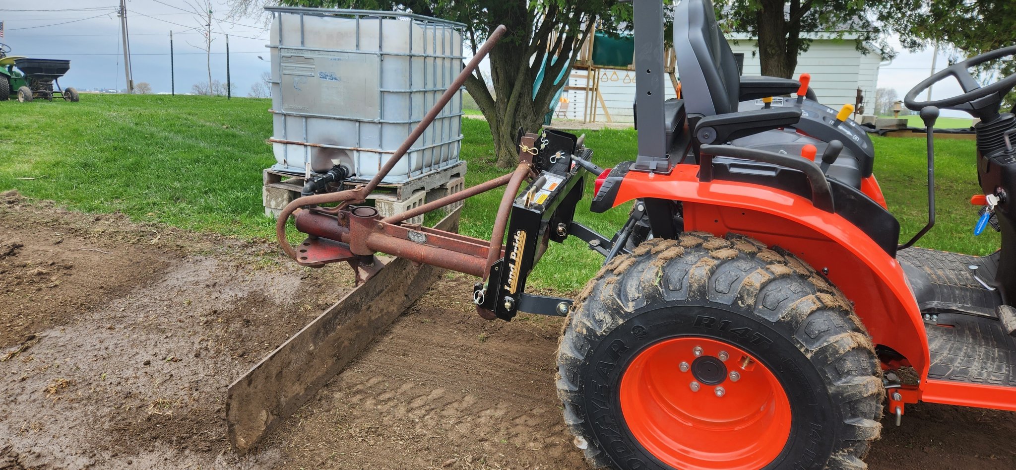

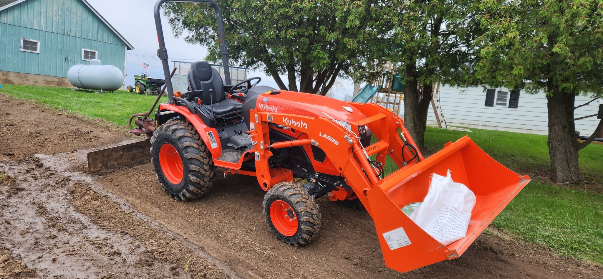

Hello,
I have a heavy duty 6ft rear blade I bought at auction this past summer and used it for dirt work and 2 times plowing snow. I'm not 100% happy with it.
I've been doing research and watching videos on box blades and I really think that's what I need to level out my atv trails, create drainage ways, and make scraps for duck hunting. I've watched videos of box blades for snow removal and I believe it'd work for my application. I like the idea of pulling the snow and then able to back up and push it with out getting off the tractor to turn the blade. I have 4 piles of snow I create so I have short 100 ft runs around my 100yd horse shoe driveway so I'm not worried about filling up the box. What used blades are going for I can sell mine and get a box scraper. The question is:
What size box scraper is appropriate for a lx2610?
I have a 6 ft blade now that when turned it covers the tractor. Would I want a 6ft box scraper or would that be too much for the tractor?

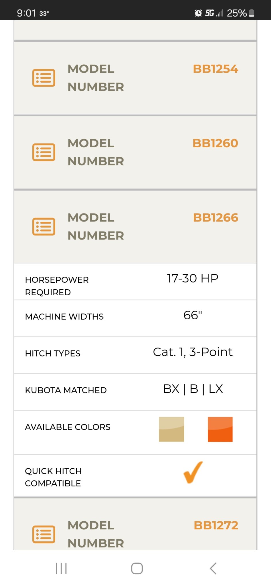

I looked in the owners manual and it said a 1266 would be a good match.
I can find 4 to 5 foot used blades for 400 to 500 but just curious if anyone used this model blade before or ran something more narrow than their tractor.

Remember that your 6ft blade when turned is actually covering a narrower path. So if you buy a 6ft box blade you will be pulling more material. Plus a box blade will carry more material taking more power and traction to pull. I have a 5ft box blade, the BB1260 that I use on my B2920, which has a couple more HP than your LX. When loaded with dirt it is a good load for it. Dirt here is a heavy type of soil and damp, so that adds weight fast. The 66” blade would work for you too, you just might need to take a little less of a load behind you each pass.

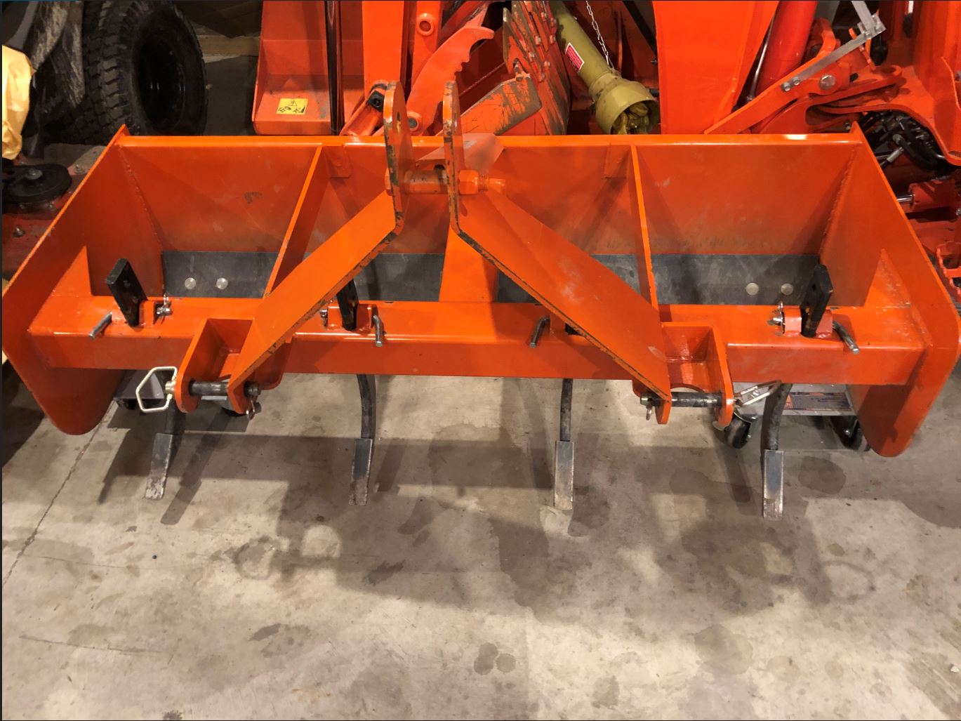

I just watched a video of I believe the 1266. No one is happy with those little clip deals
Correct. I believe that the 15** series is a bit heavier duty with pinned shanks. You also want to take a look at how they connect to the 3pt arms. My opinion is that the yoke style is much stronger.
Thank you I just read that also. Youre pulling in the center of the pin and not the outside like the typical cat pins. My choices are getting narrowed down now lol.

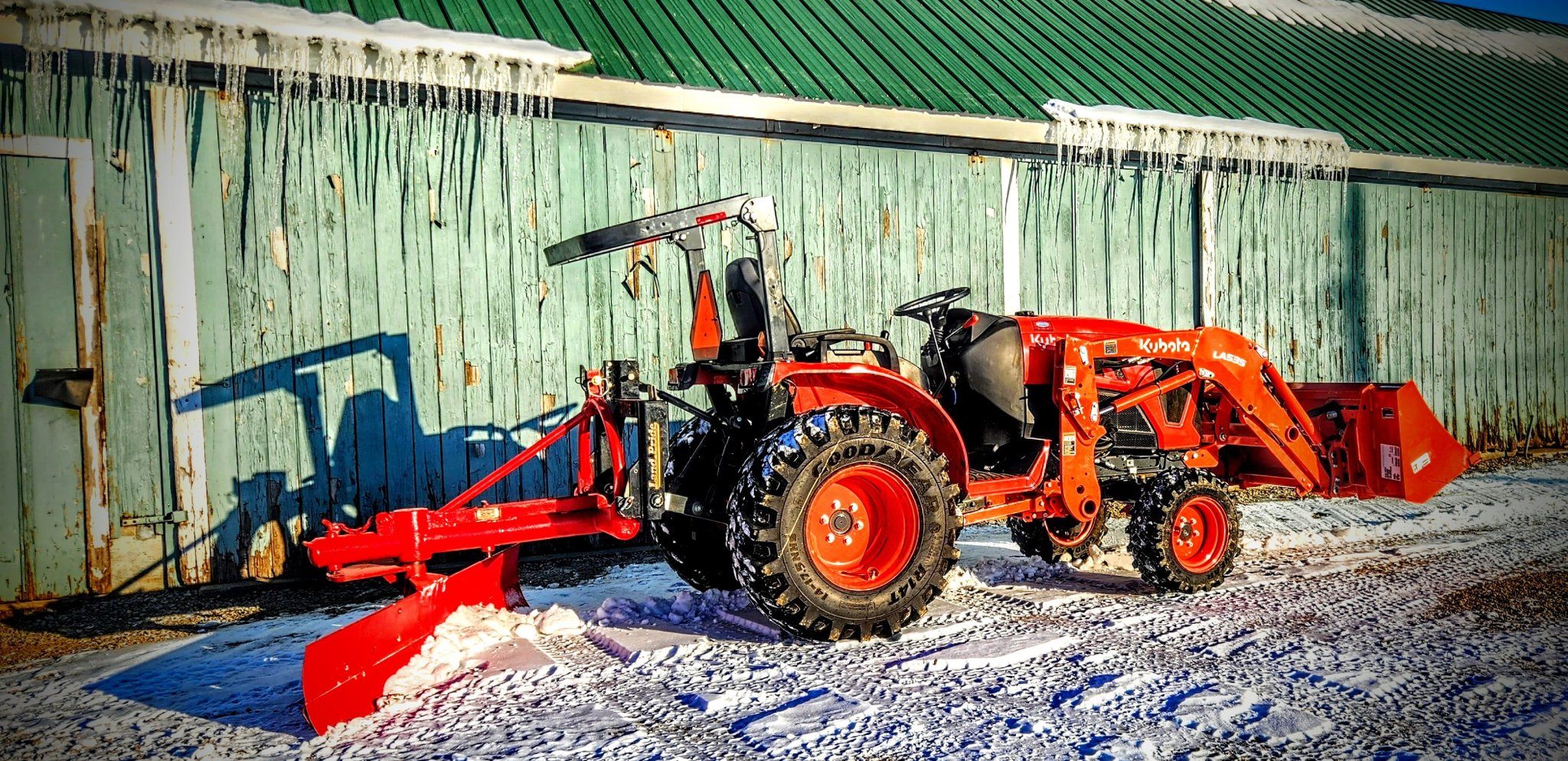

Thanks. I got the rear blade dialed in good for snow but thought if I had a one use tool the better. I just watched a video of I believe the 1266. No one is happy with those little clip deals
You will find that a good rear blade is better for snow removal than a box blade. I had both and got rid of the box blade because I didn’t use it. Box blades are great for leveling dirt or gravel, but not very useful for cutting and cleaning ditches or doing snow removal. You can’t angle them to deposit snow on the side of the road or pulling gravel from ditches back on the road. But if you’re going to buy a box blade get one that will be a few inches wider than your wheels on both sides.
Thanks for the advice. I was thinking about that. How it's nice to throw the snow off to the side and did worry on if I got rid of the rear blade. I did find a cheaper box scraper now I thought I could buy and try and hang onto the rear blade.
