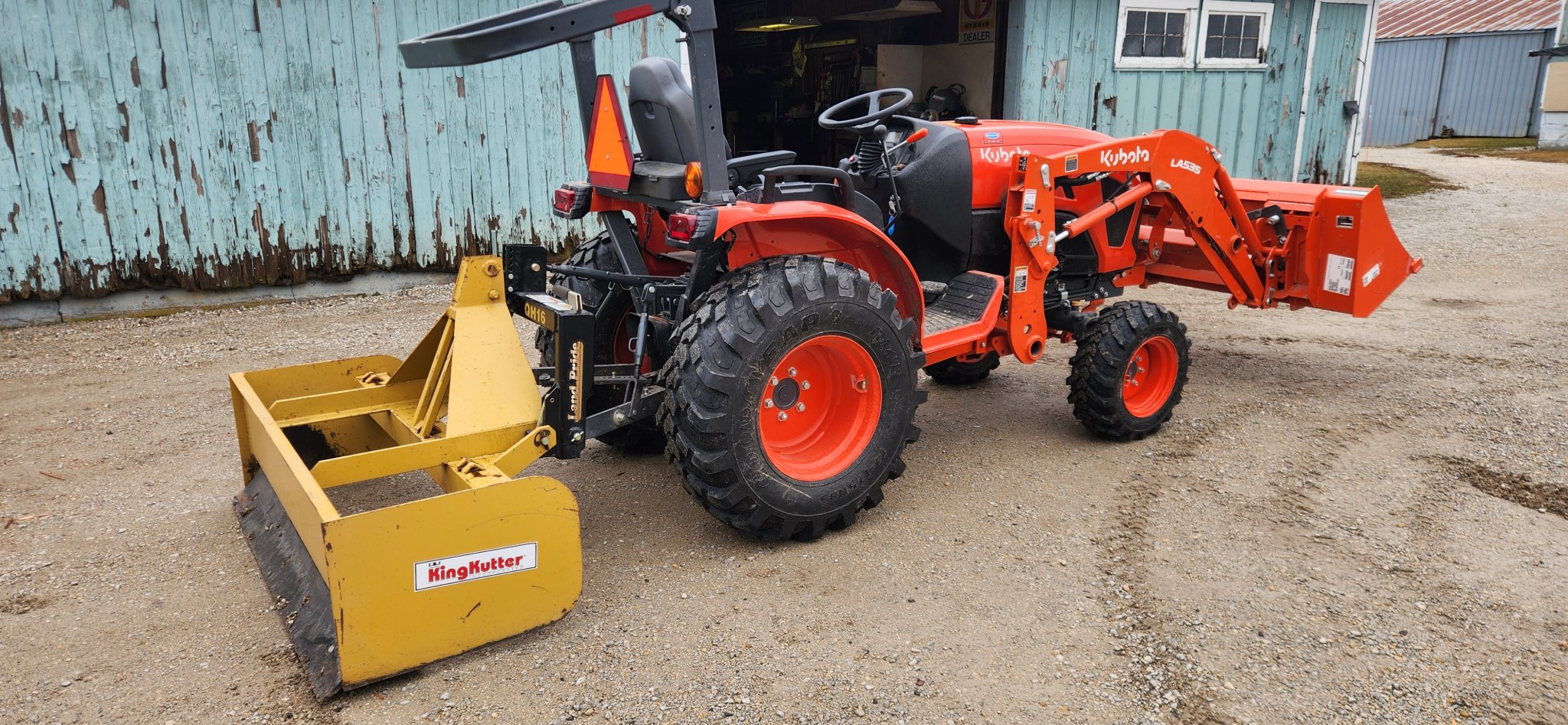

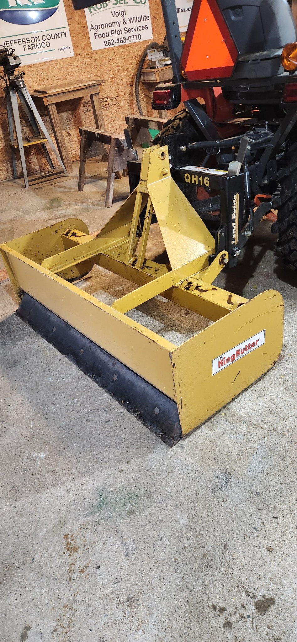

Got the box blade picked up and adjusted on the Kubota.

You will find that a good rear blade is better for snow removal than a box blade. I had both and got rid of the box blade because I didn’t use it. Box blades are great for leveling dirt or gravel, but not very useful for cutting and cleaning ditches or doing snow removal. You can’t angle them to deposit snow on the side of the road or pulling gravel from ditches back on the road. But if you’re going to buy a box blade get one that will be a few inches wider than your wheels on both sides.

I've been doing a ton of research of different brands of rear blades and box blades. Sadly a few of them seem exactly the same just different colors and stickers with jacked up prices. If you look closely at welds and support you can see some differences. This used kk for 400.00 looks exactly like a 900.00 taylor way one from the dealer. Granted it seems like kk isn't built like it used to be but I also read stories of guys bending land pride and Frontier blades.
