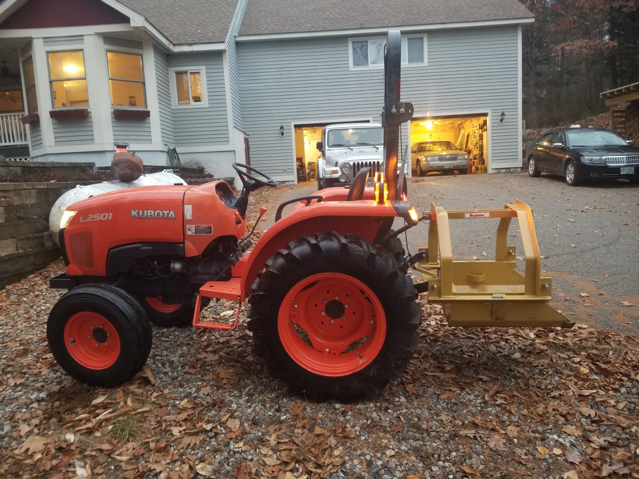

I have one of those too, mine is made by King Kutter and it's reversible. They're pretty handy. Along with moving dirt I use mine as a carryall to carry tools and firewood.

Those dirt scoops are a godsend when you don't have a FEL, like I didn't until a month ago!
Absolutely! I don't have a FEL so that's the next best thing. It does way more than I thought it would.
That is the exact same dirt scoop as I have. Very good value for the price. Bought mine about 15 or more years ago. It is a little rusty now...Yours looks like new. Mine lives outside in the weather year round.
Mine is only about a year old. It lives outside as well but I plan on building a small pole barn to store my implements next summer.
When you build, build about three times bigger than you think you need. My shed is something like 28 feet square, and to comfortably store what I have, under roof, I think I would need probably 30 x 60 feet. Of course if I had that I would soon run out of space too... :oops:
