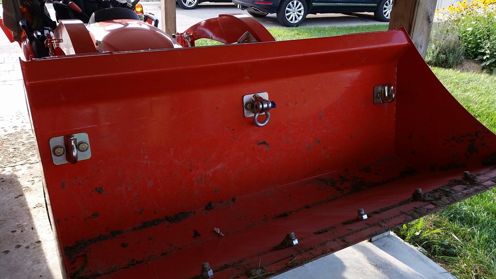

I installed one of Ken's excelent bolt on hooks in the center on my L2501's loader. My thoughts were to add two more when I get a chance. My grapple spends most of the time on the loader but it sure is handy to have hooks when needed.

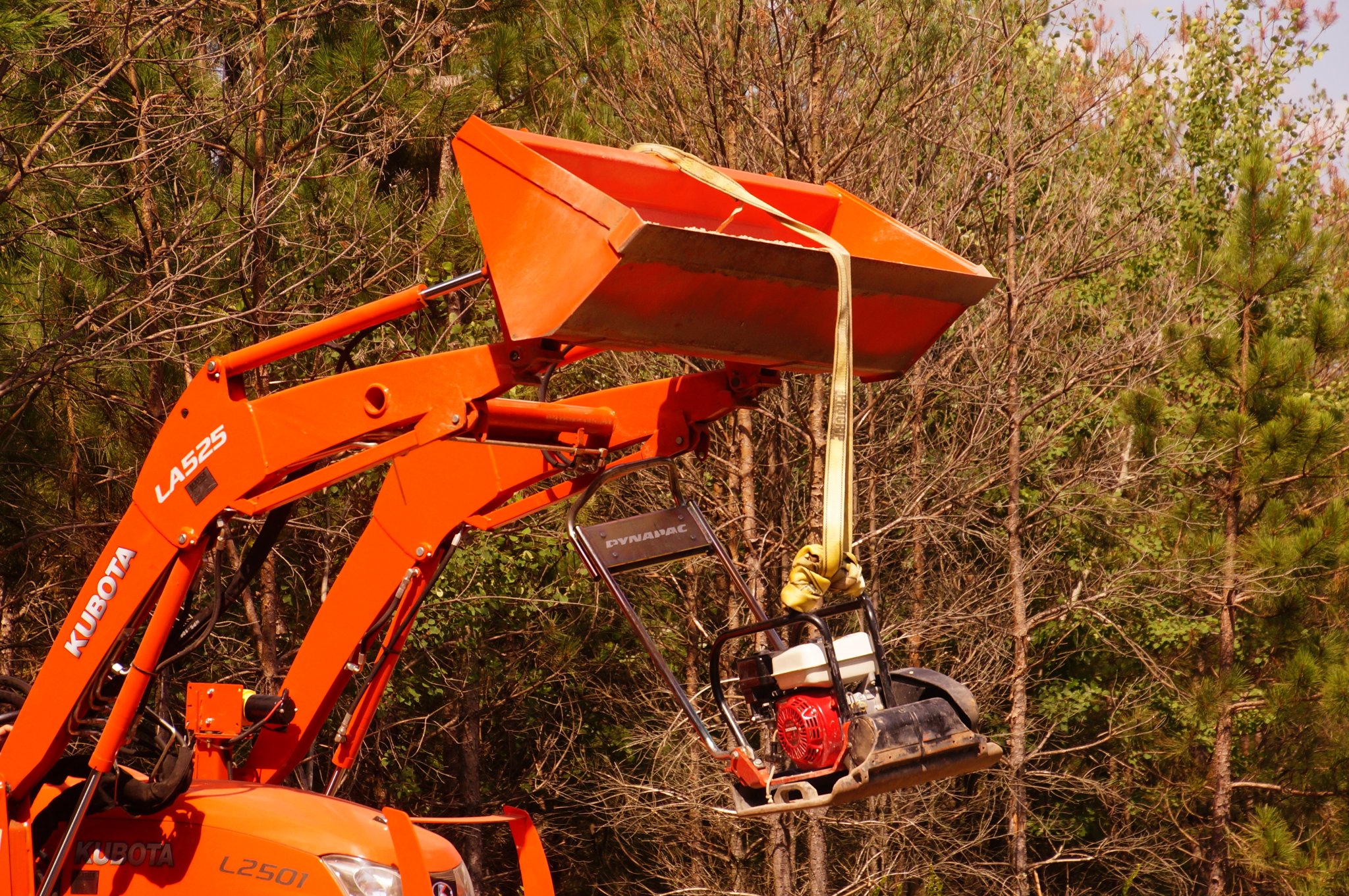

I did not rig the compactor , I would have used a chain or some sort of protection for the strap and the bottom cutting edge. It was a short lift so no damage done to strap.

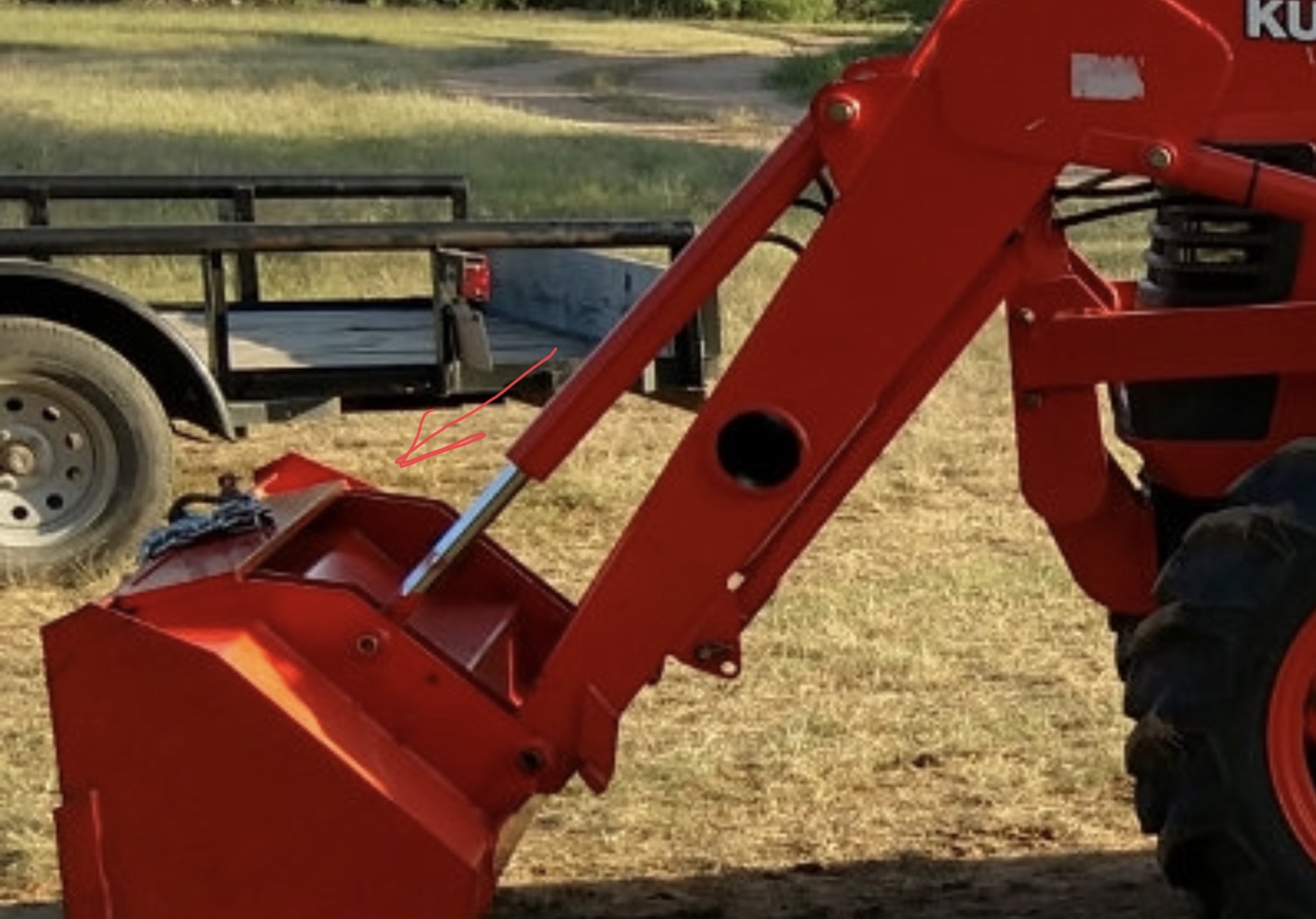

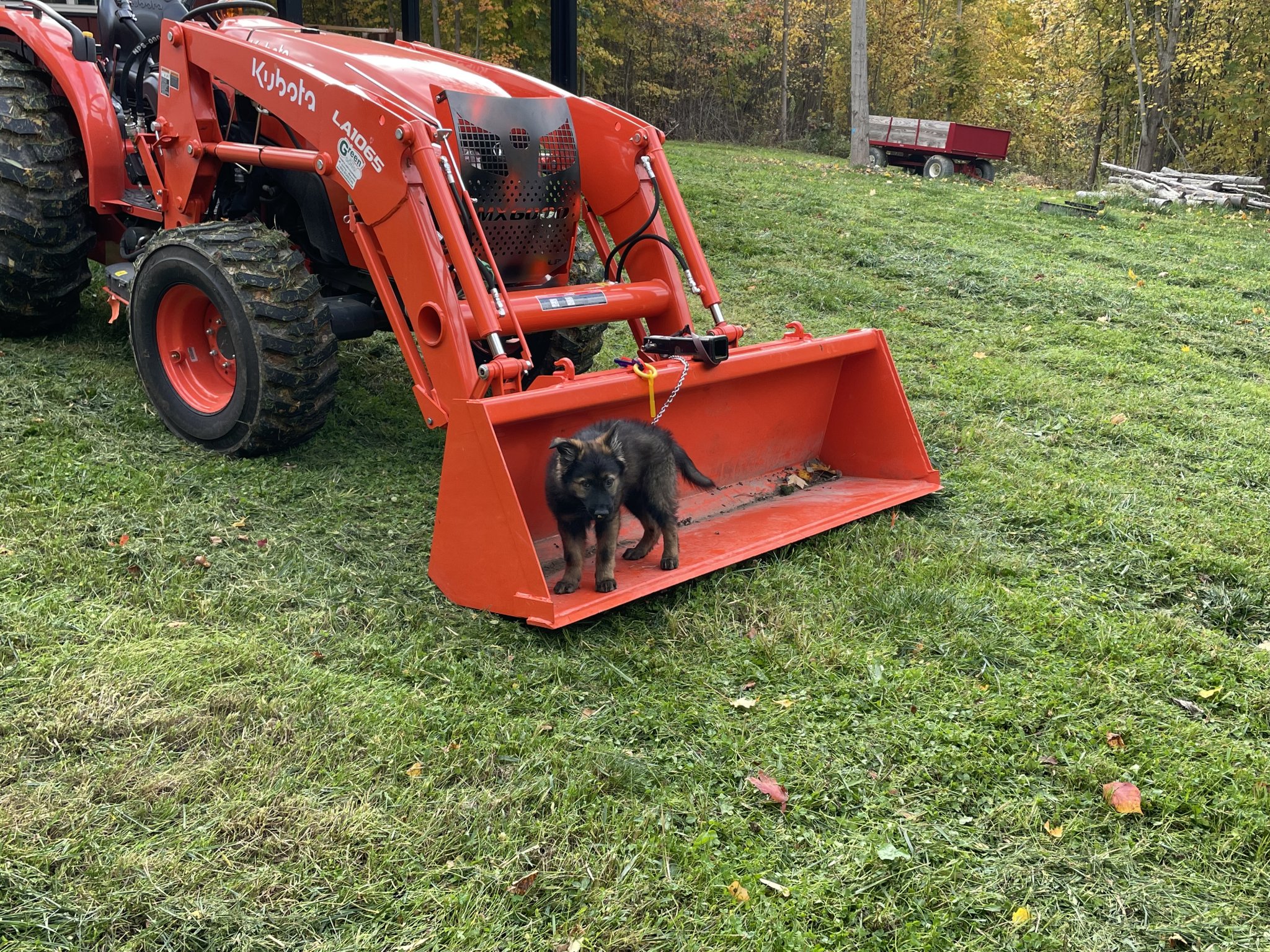

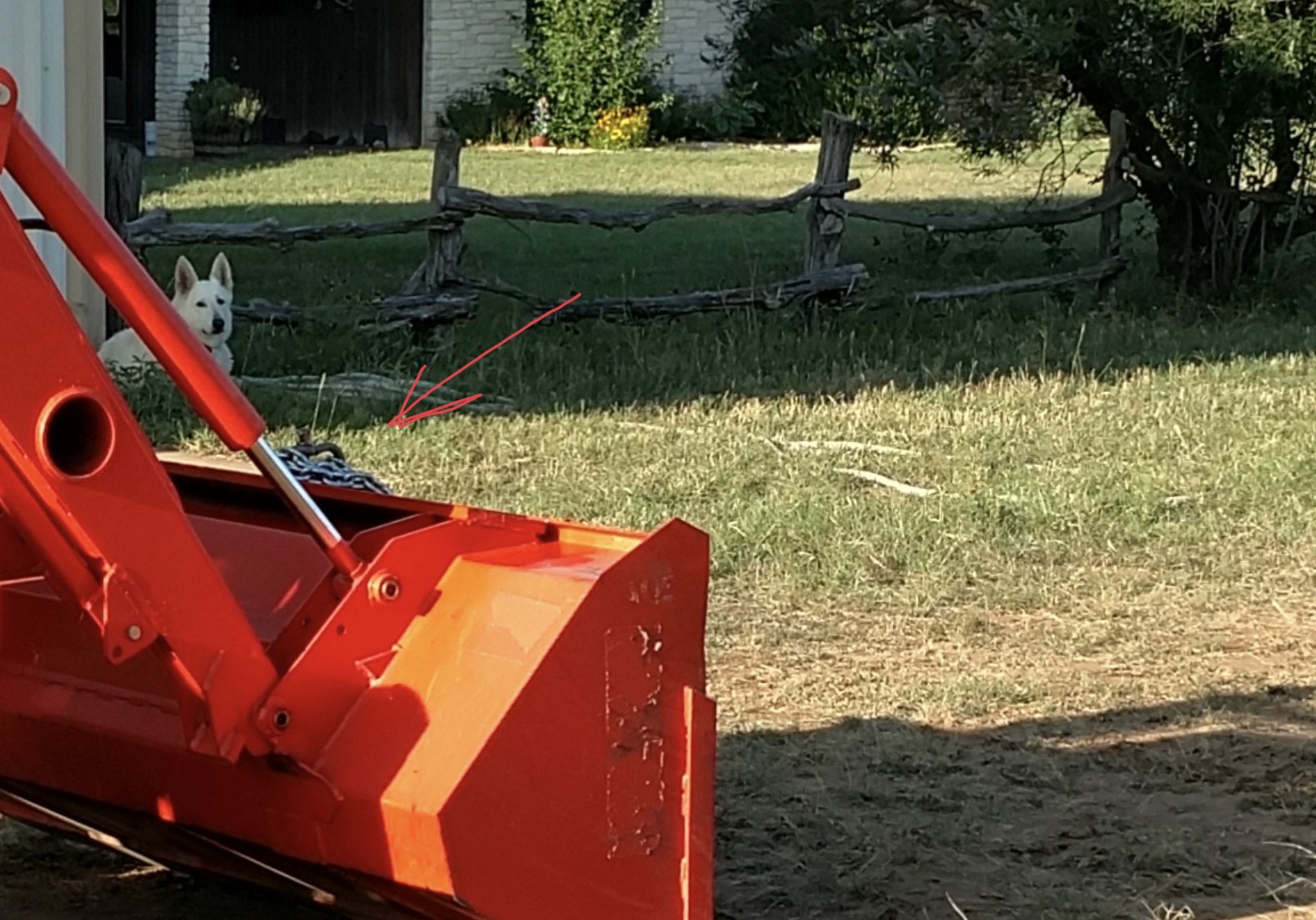

I thought about a center hook, however I opted (MX) for a receiver in the center which can hold a hook if need be…eventually I’ll add a receiver to the B as well. It’s handy to push a trailer as well as another lashing point for an ornery GSD.

I ended up going with 2 bolt on hooks and a bolt on d-ring/ clevis in the middle. This has worked really well for me. I would say I probably use the center a little more often but for sure use the sides and in some cases I use all 3 for a lift.
i still want forks but am happy for now.

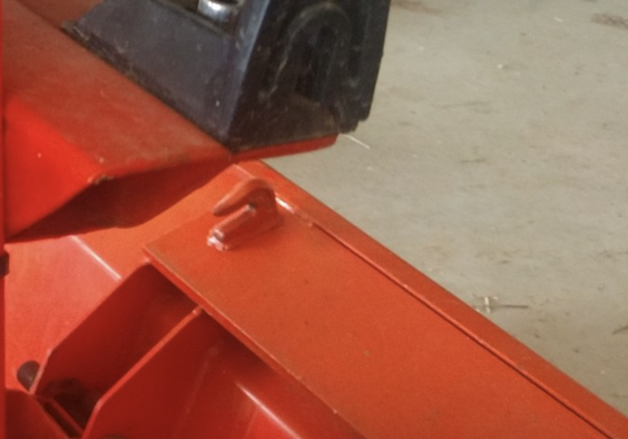

My tractors’ previous owner had One Clevis welded to the center of the bucket…sitting on top of a 1/2” reinforcing plate he’d also welded all the way across the top of the bucket.
It was after I’d acquired the tractor that I welded two hooks on top of that plate in front of each loader-arm.
Here’s the day I brought it home (obviously before I discovered a clevis is lousy for use with a chain and added hooks…as seen on the bottom pic of one side.)
