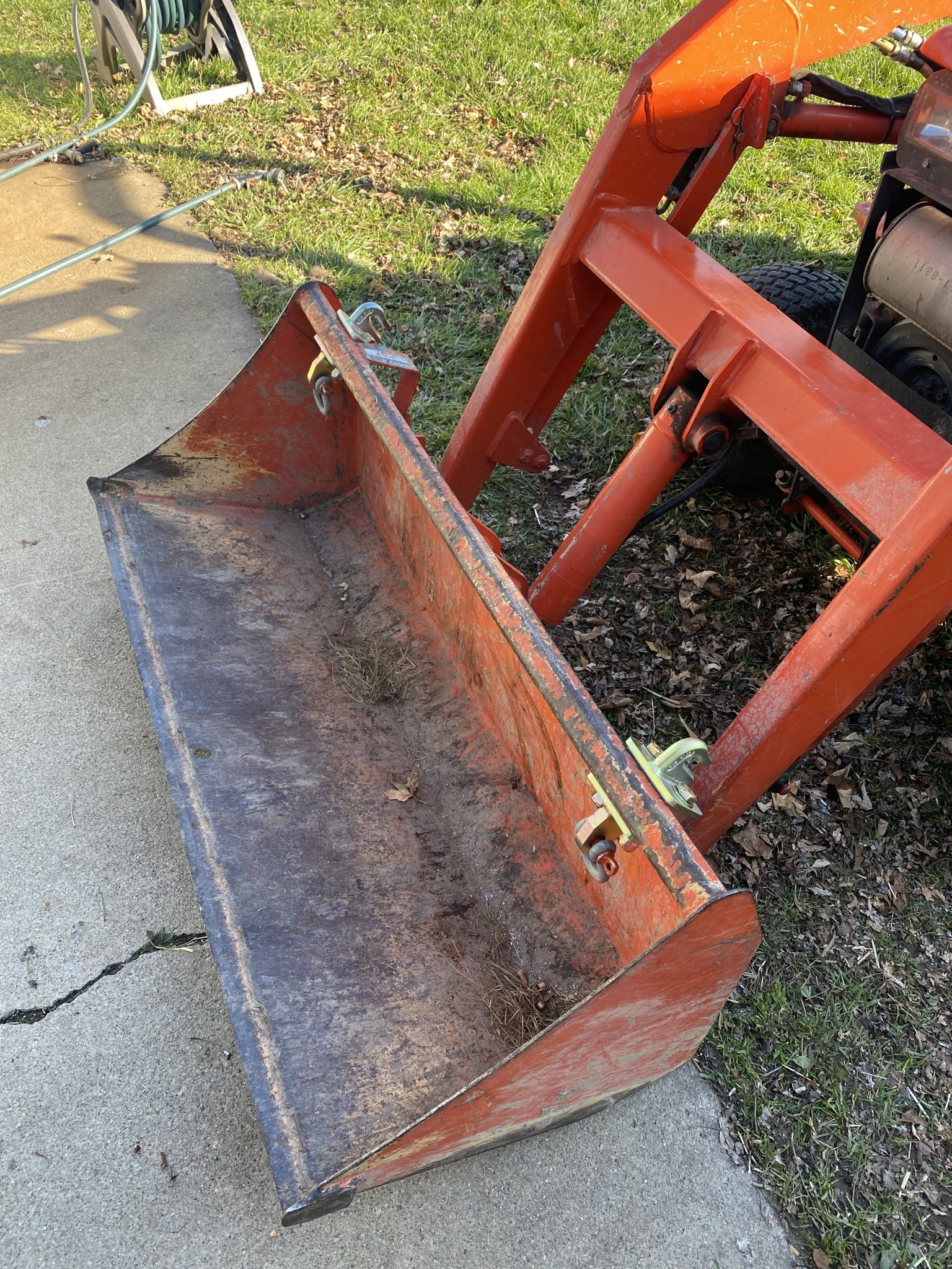

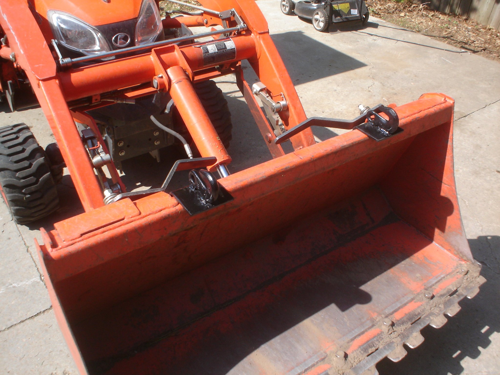

Had bought the bolt on’s a coupla weeks ago and also just got my BX Piranha tooth bar….
Finally got them installed today! Can’t wait to play with them!

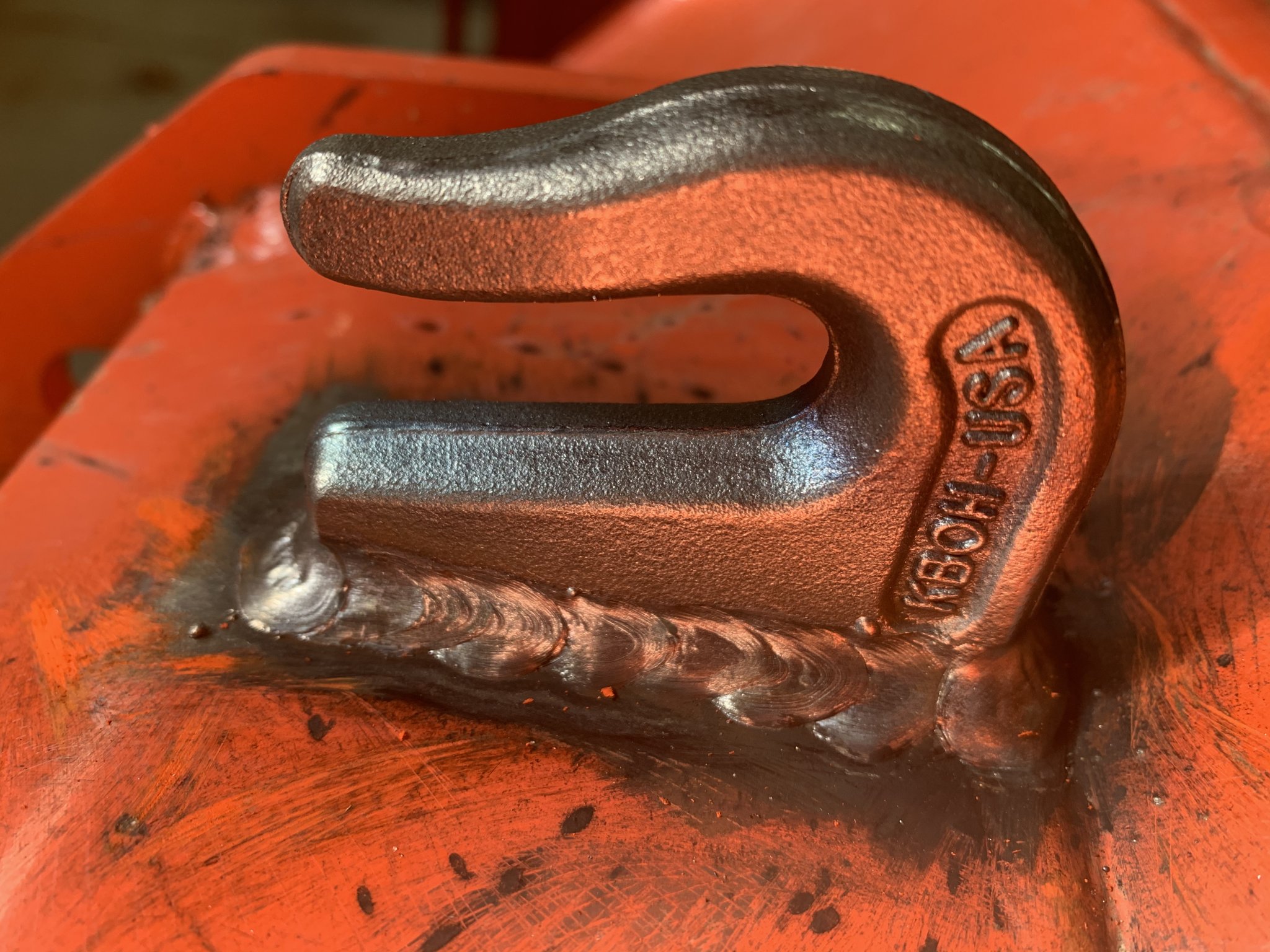

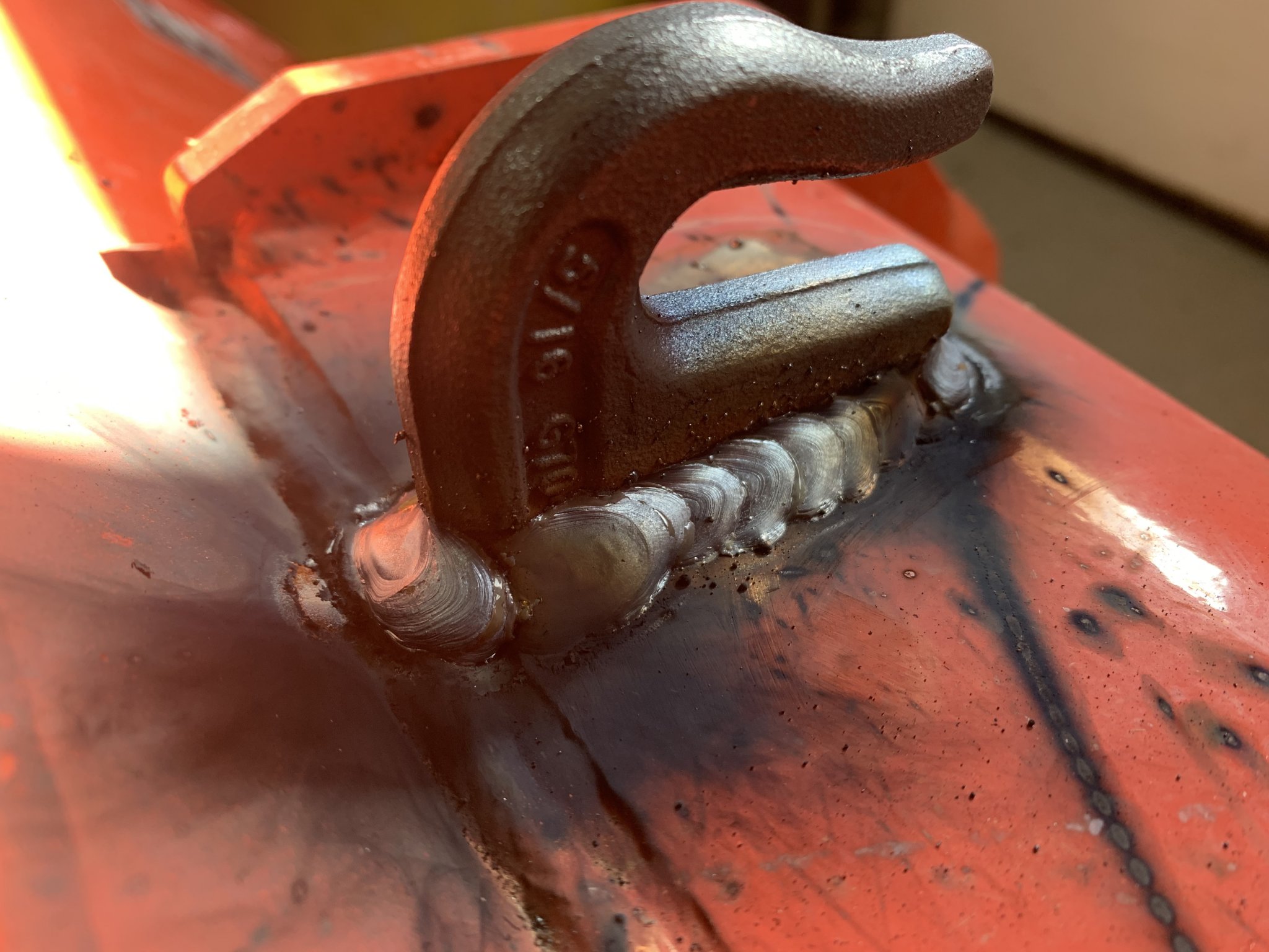

Glued my weld on hooks on this morning. Ended up not using the 1/4” plates, my bucket has 3/8” thick flat places. Stuck right to those. I will use the plates for something, I’m sure. Turned the heat up, and let her eat.
6,916
4,244
We have both and the bolt on hooks are far better than the welded ones, which snap off pretty easily
Lousy welding job if that happened. (poor penetration)
Welding is almost ALWAYS stronger than the base-metal to which anything is welded.

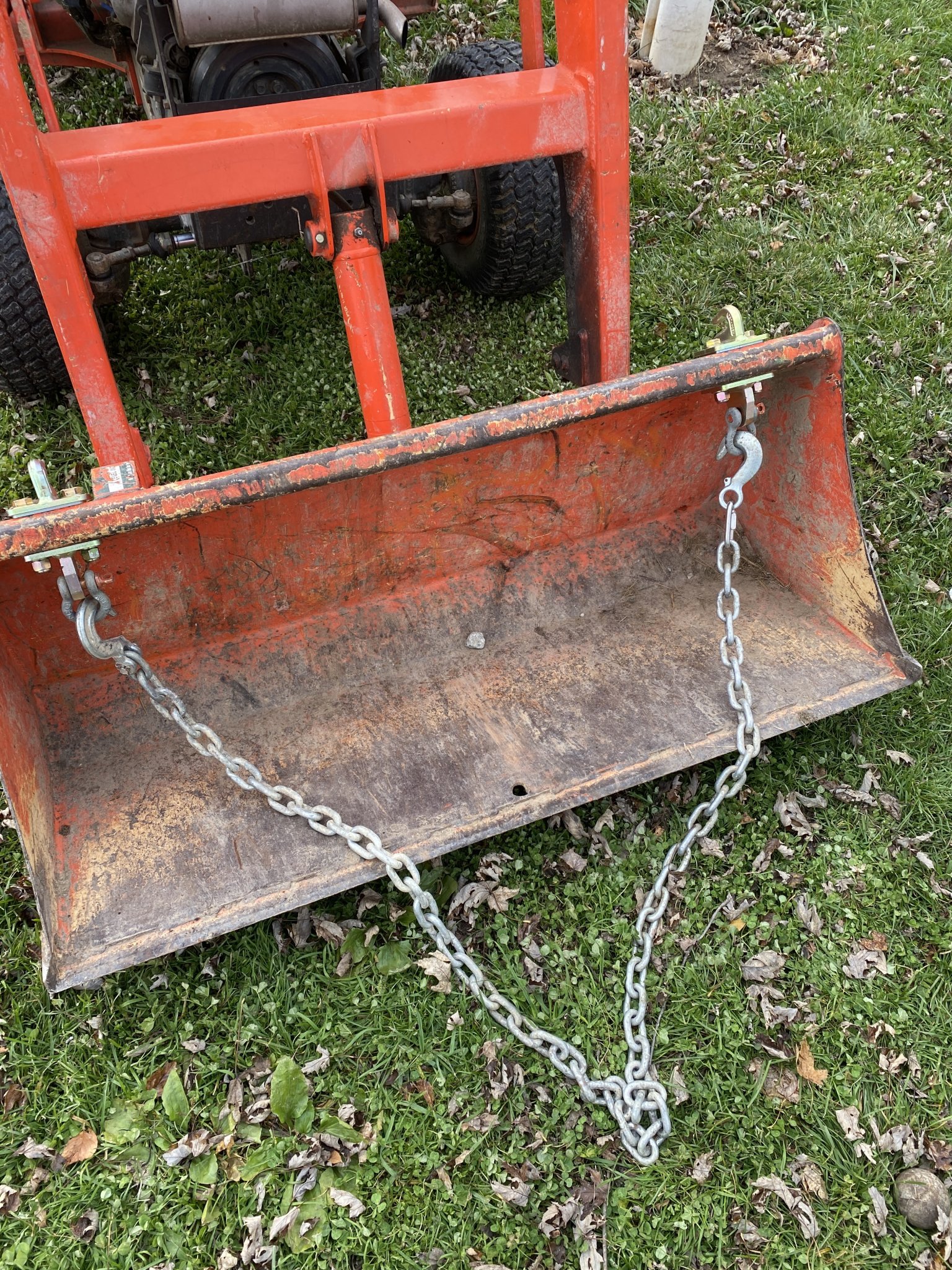

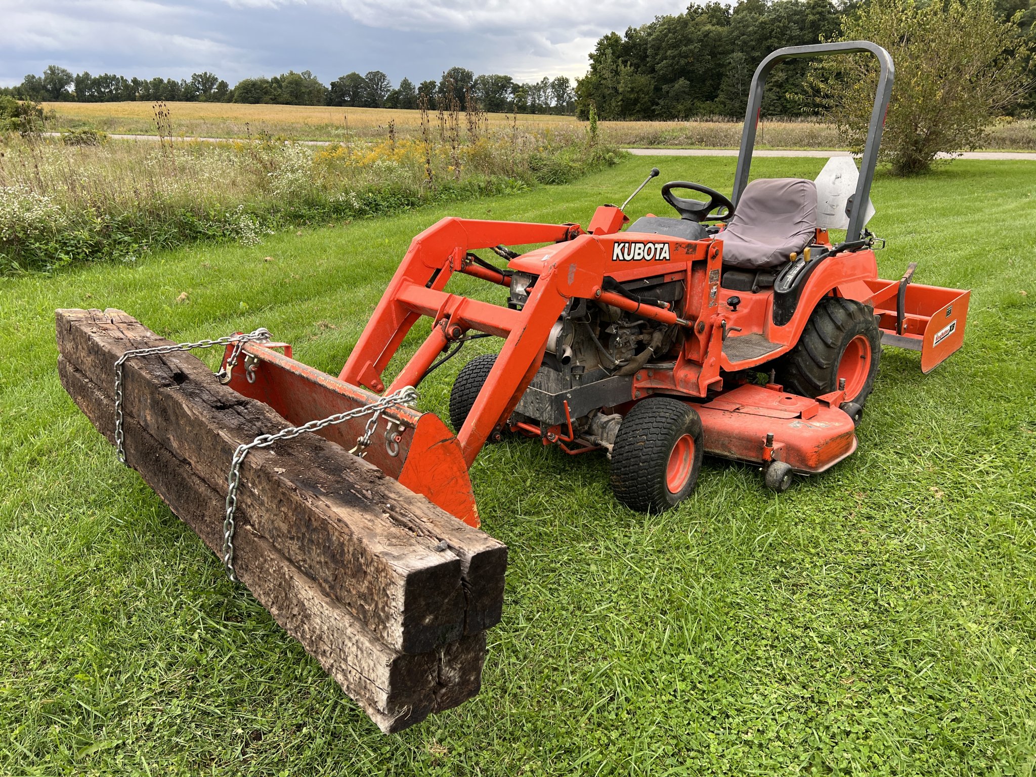

My setup
It's possible I could do this with 1 hook in the middle, but it would be a lot more difficult doing the balancing act.
No way I could have done this with one hook. Railroad tie would have been falling one way or another.

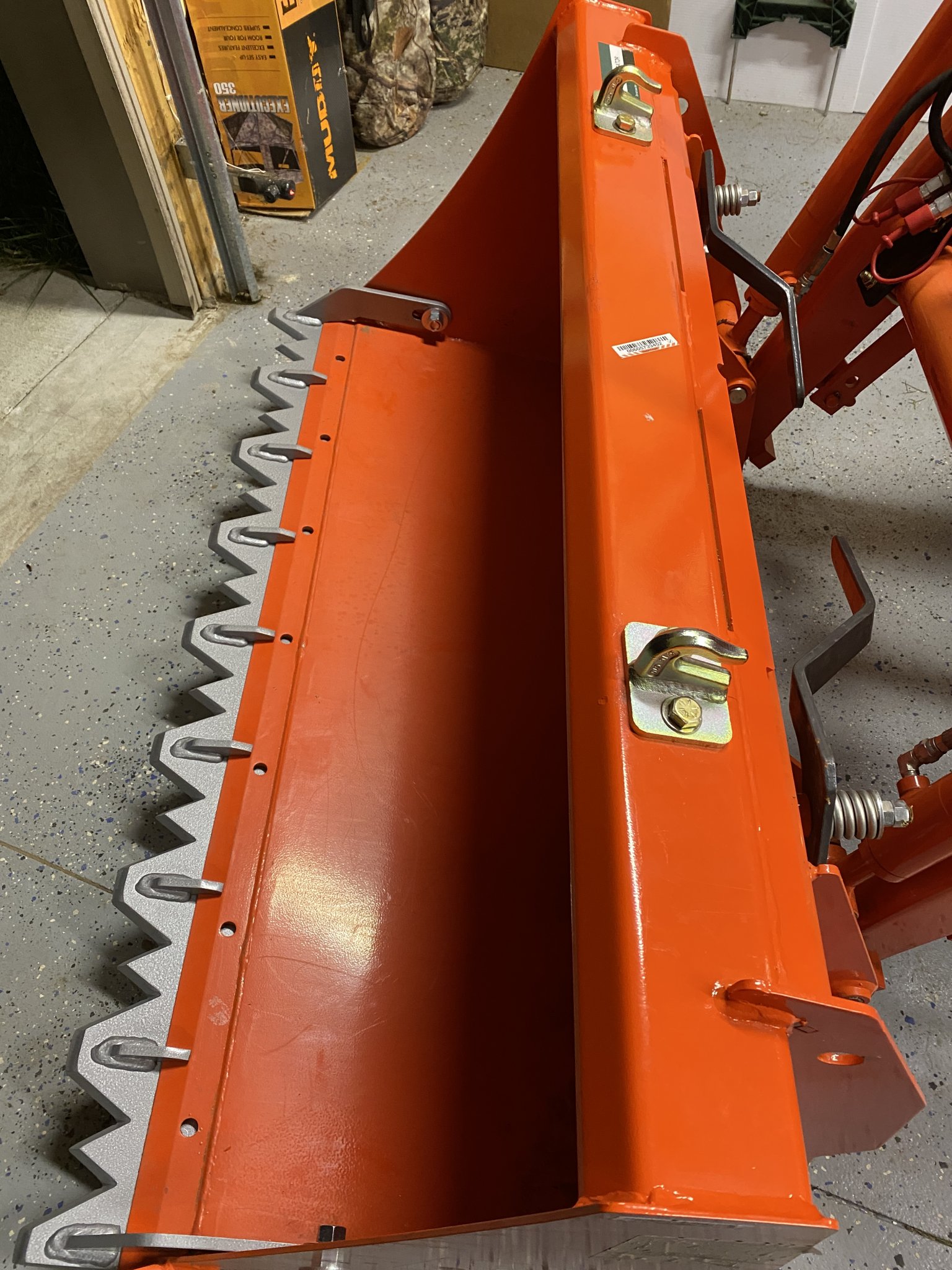

I can weld and opted not to. Ken's Bolt On Hooks are clean, professional, and probably stronger than welding hooks on due to the way they're constructed. The backing plate reinforcement certainly covers more area than a weld would. It's a well designed system, just follow the instructions and measure carefully. Would I do it again? In a heartbeat!! Oh, and they're great people to work with.
Not criticizing Kens’ Bolt-On products… they are clearly well-made products and solve the installation problem for those who do not/can not weld…or for those who choose not to weld… for whatever reason…. I just don’t see any validity in the claims they are “stronger” than ordinary weld-on hooks, etc…. because the bolt-on products themselves are ”welded” onto the backing plate used for bolts. Those backing plates use weaker fasteners using smaller attachment surface-areas than the weldment on either method.
Those fasteners will deform the bucket and/or break before quality welds would on either method. IMO
(There is a good consideration in that Kens weldments are consistent and well-executed… something the average homeowner with a HF wire-feed welder may be unlikely to acheive.)

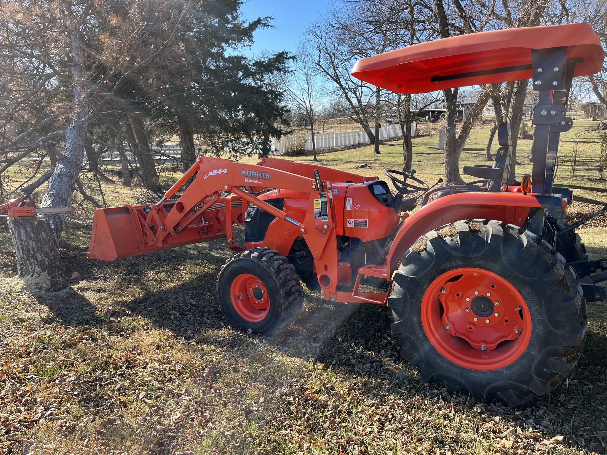

I bolted on two hooks a few months ago for my MX 5100. Yesterday I sawed down a dead beetle infested pine tree. The only photo I took was this one with the chain around the tree trunk . I pulled it back a way. Then sawed it in about 8 ft. Long sections And using both hooks lifted it up and hauled away.

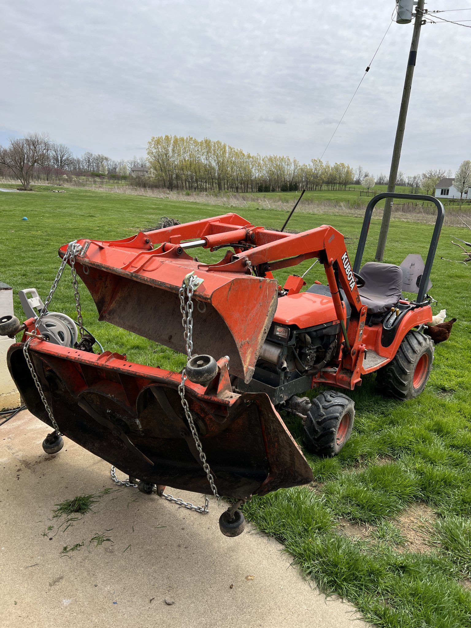

If you had 2 hooks placed in front of the lifting arm (this is recommended) you would not want to hook something to just one. It can tweak/bend the FEL arms by pulling sideways. I have used a chain in between the hooks with a strap attached, although the general rule of thumb is that you don't want to do anything where you have to pull hard with the loader. If you are going to have to do that you should hook to a drawbar on the 3pt.
Something like this. In this situation I wasn't really trying to yank on something.....just putting some tension do when I cut the broken limb it would fall away from the house.

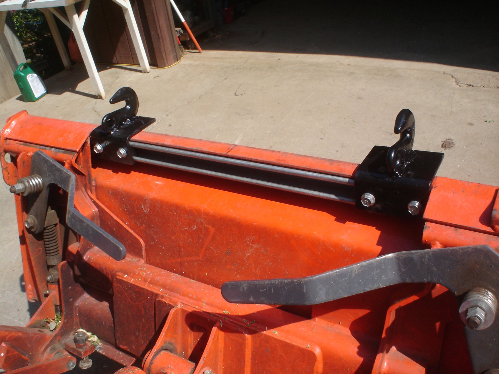

Here's my version of the no weld, no drill solution.....
A section of electrical 'strut' channel slid into the bucket top lip 'pocket' and grab hooks welded to 2x3 angle bolted onto the strut. Weight of load is distributed over the entire lip evenly. So far ZERO issues even with loader maxxed out for lifting...
