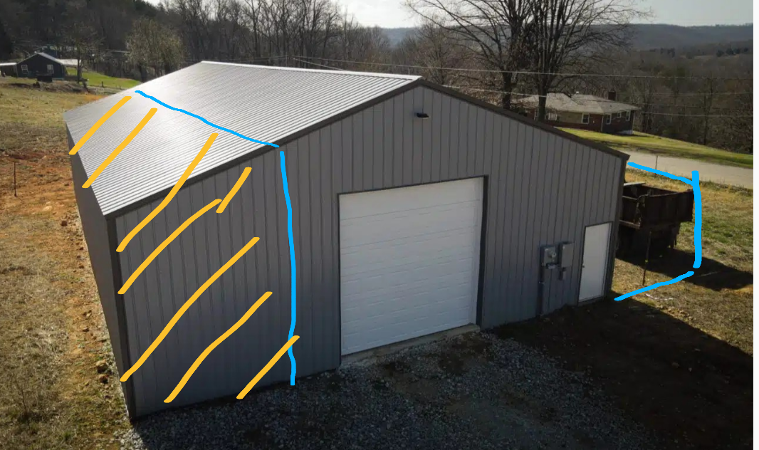

That is a thought. The hold up there is that we would like to build it as a drive thru. Doors opposite of each other so I could just pull through the building and not have to back it in. Of course, we all WANT things and don't get them 😆
I was thinking of something like this with a door at each end.
Ah, I see what you are saying. I was thinking you were talking about a large loafing shed. So the roof would only be sloped in one direction. That way, backing a boat in, the stern would be at the low side of the building.
That's essentially what I'm thinking, but with the door to one side. It's a better use of space to have the large item (boat) on one side and room for the ATVs, MX bikes, tractor, attachments, etc on the other. If the boat is in the middle, the "extra" room is broken into 2 smaller sections. Does that make sense?
It's all planning stage right now anyway. To be honest, a totally enclosed building isn't even necessary. It is what I'm shooting for though.
