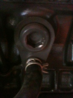

I just installed a block heater in my B3300SU yesterday, a simple process as long as you have the right tool (the center picture is a 17mm stud to be removed) and the last picture is the finished product :)
That is exactly what i did for the solution, made my own socket out of a 17mm bolt I had! It is not perfect but it worked. :)
