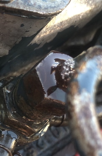

Are these bubbles coming from bleeding the injectors or created as it bleeding. Can’t get it to start. Bled for quite a while.

I do not think you can suck air back into the lines and your pictures look like normal bleeding to me.
