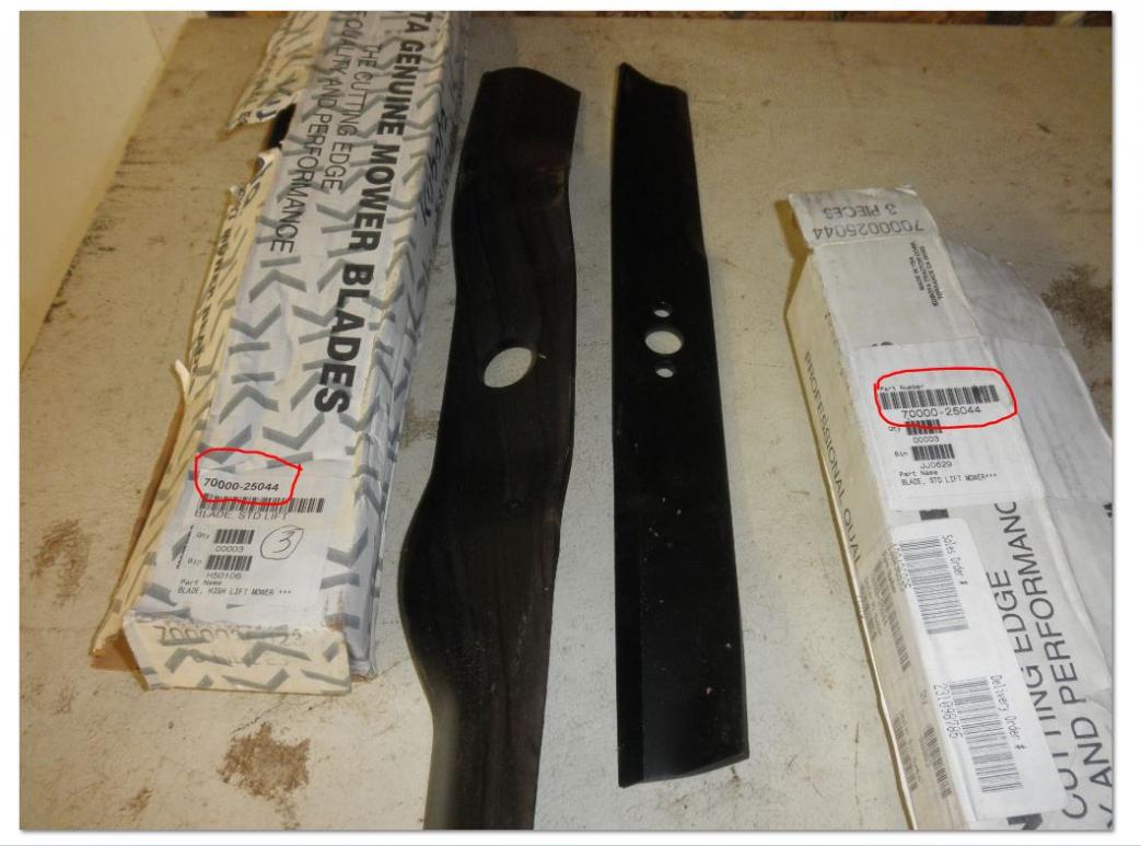

I have a mr4800 mower and have broken 1 blade. The blades that kubota recommends will not fit. Messick is trying to find the correct blade, but so far has had no luck.
Does anyone have any info?
Kubota says the blade is Part # 70000-25006, but it is 20 1/4 inch long and has no alignment holes. They say I should remove the aligment pins on my mower deck. The problem with that is, the blades on my MR4800 is only 16 1/4 inch long, 2 inches wide and has an alignment holes on each side of the install hole in the center.
Any Help??
Thanks

Thanks for the quick reply.
I originally went to kubota's website and ordered 70721-34330. They said it was superseded to 70000-250444. That is what Messick shipped me. 70000-25044 is 20 1/4 inch long and only 1 hole, unless Kubota put the wrong blade in the box. Messick call Kubota and they gave him this new # 70000-25006, which is the same dimensions as 70000-25044.

I just went to the website you provided and it look like the correct blade, but it has the same part # that messick shipped me that was wrong. I am going to contact the dealer to see if he has one in stock to check.
Thanks again

Just a follow up. I ordered the same part # from another vendor and recived the correct blades. I attached a pic to show the 2 blades with the same part #. both came from kubota.
Thanks for all the help.
