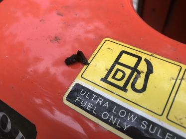

Thought I’d give Idaho Wolfman a break for once and post here,...... lol.....
Glad you figured out your issue with the fuel! Can anyone tell me what the “outlet” of the inside of the tank is manufactured? I take it that it must be a bit higher than the bottom of the tank to aid in avoiding foreign particles getting into the fuel line to filter?
I have the same issue as what was originally posted here. Fuel flows strong when removing the line from the inlet side of fuel filter. (L3200). I never thought of the spraying of the inside of the tank.... going to have to give that a shot tomorrow hopefully......
Thanks again everyone for all your advice and help!

Tornado, interesting post. I believe this was “something” put into the tank. Looks to be chewing tobacco. A nice going away gift from an ex. I think I’m going to just take the tank off and flush it all out. Just not sure where to start. Looked on YouTube but the L3200’s on tgere are older than mine and not quite the same. Could very well be same in concept I’m sure. Going to have to give it a shot as I can’t do a thing with it if it’s not able to run.
Has anyone ever removed the fuel tank from a ‘14 L3200?

Update! I’m happy to say I did end up getting my 2014 L3200 back to full power! I took the tank out and flushed it buy sloshing about 1/2 gallon of diesel in the tank at a time with a very rapid shake. Did this 14 times until no residue could be seen when emptying. I did see two pieces of what appeared to be chewing tobacco come out along with oodles of smaller gradual looking pieces. Upon start up, it didn’t want to run much different. But then after about 3 minutes it cleared rite out and back to power to spare!!!
I can’t thank Orange Tractor Talks enough! Especially The Idaho Wolfman and Jim L.
I thought I’d run thru whatever i could to help others if you needed to do the same thing......
Pictures are very important. You cant take enough. Doesn’t look too difficult to get things back in same place as they came from, but it gets confusing when putting it back together at least for myself. Mark everything even bolts as in the end they all look about the same so trying to figure out where they all go back to is a challenge. I did this over 3 days so maybe if one did it straight thru would be better. Before I started to slosh the inside of the tank i took the tank to the car wash and rinsed off the OUTSIDE ONLY of the tank. This ensured me that the pieces I would be possibly seeing after each “slosh” would be actually coming from the tank and not just falling into the tub off the outside of the tank. I think the most important thing to know at least for my L3200 is that there is a pressure relief thumbscrew/bolt just above the engine oil fill cap that will release any fuel lock pressure you may have. Just turn it out one full turn. Let tractor run at decent idle for about 30 seconds. Then turn back in and snug it down. That’s a very handy feature especially for someone like myself that is not trained in the mechanical field to say the least.
I had put off doing this for too long. Glad it didn’t ruin anything major long term.
Thanks Again!!
