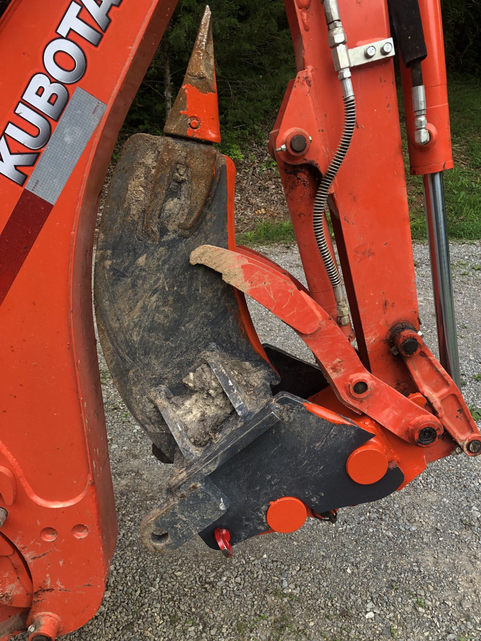

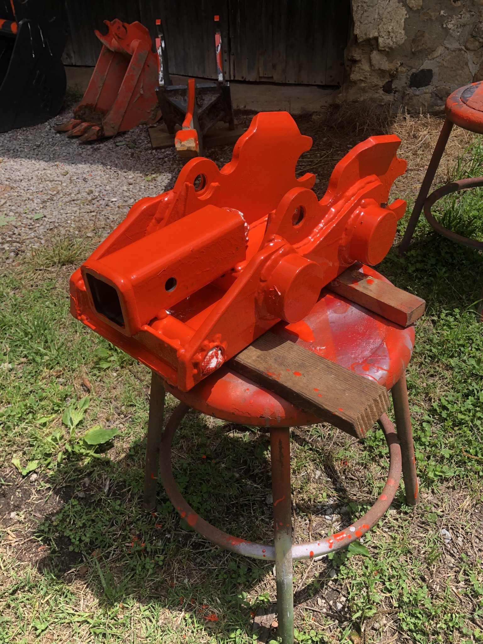

Not sure if it’s the exact same as the Kubota part. Made by USA Attachments for the M59 to use KX excavator quick hitch attachments. Had to slightly modify the pin-on thumb to play together. Best attachment change ever.
So impressed made an adapter to use KX excavator attachments like the ripper on the B26. Could be adapted to any backhoe.

Picture is of your adaptation for the B26?

Yes. A simple adapter could be made for any backhoe to use KX mini excavator attachments. Same quick attachment for several models with plenty of new and used stuff available.
M62 is nice. Like my pre tier 4 M59. All the TLBs are powerful and easy to operate. All need special mods and equipment to make them better.
