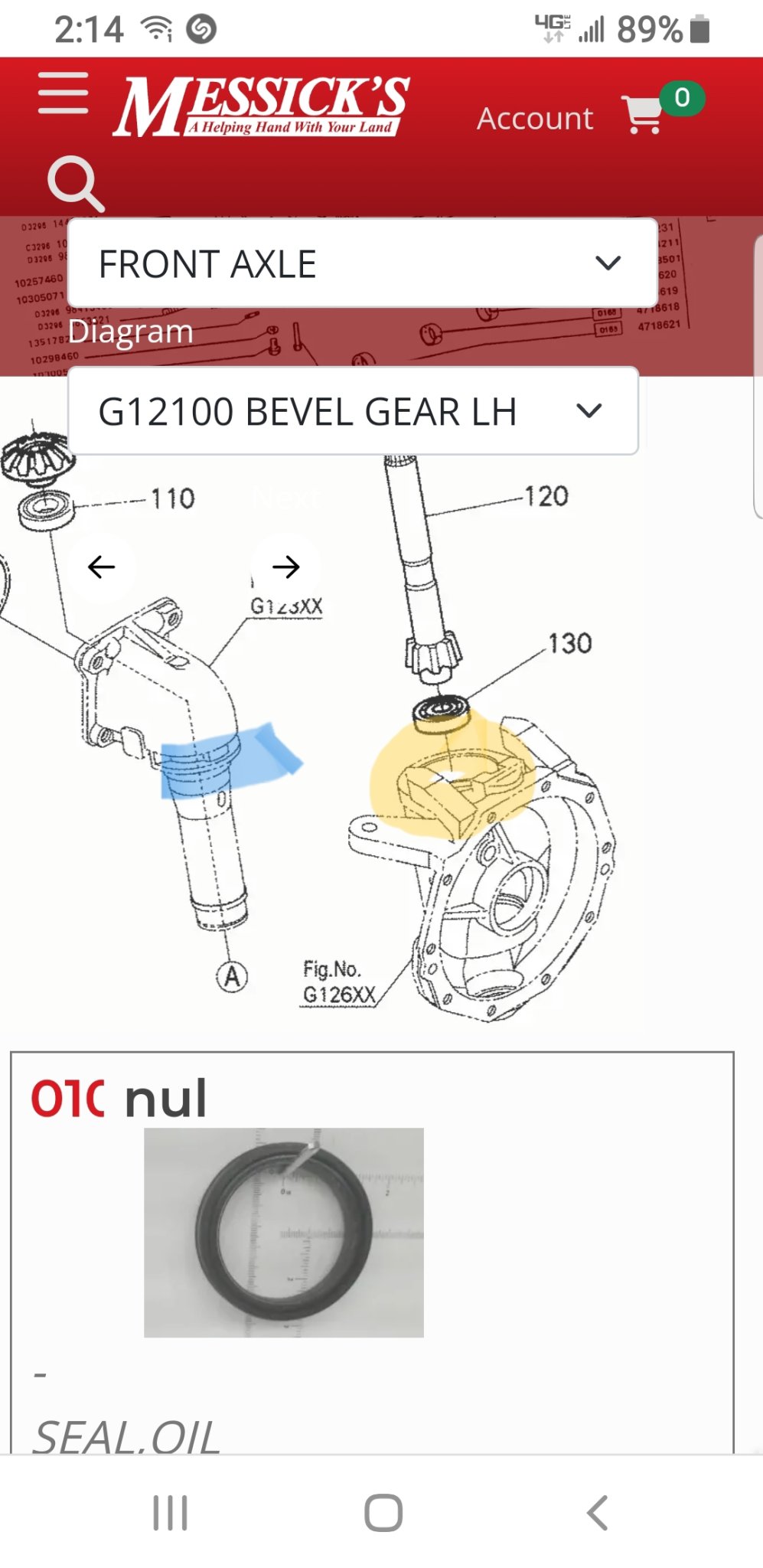

Not long I had to replace the bearings and seal on the axel case. I have now developed a leak where the bevel gear housing connects into the axel housing. Can I just replace the seal or do I need to go ahead and replace the bearings? I am in the Western North Carolina mountains where we had flooding. I have to rebuild 1862" of our road that was washed away. Thanks for any help or suggestions. Unfortunately I still don't have internet back at the house and no cell service. I will have to check back in when I have a signal.

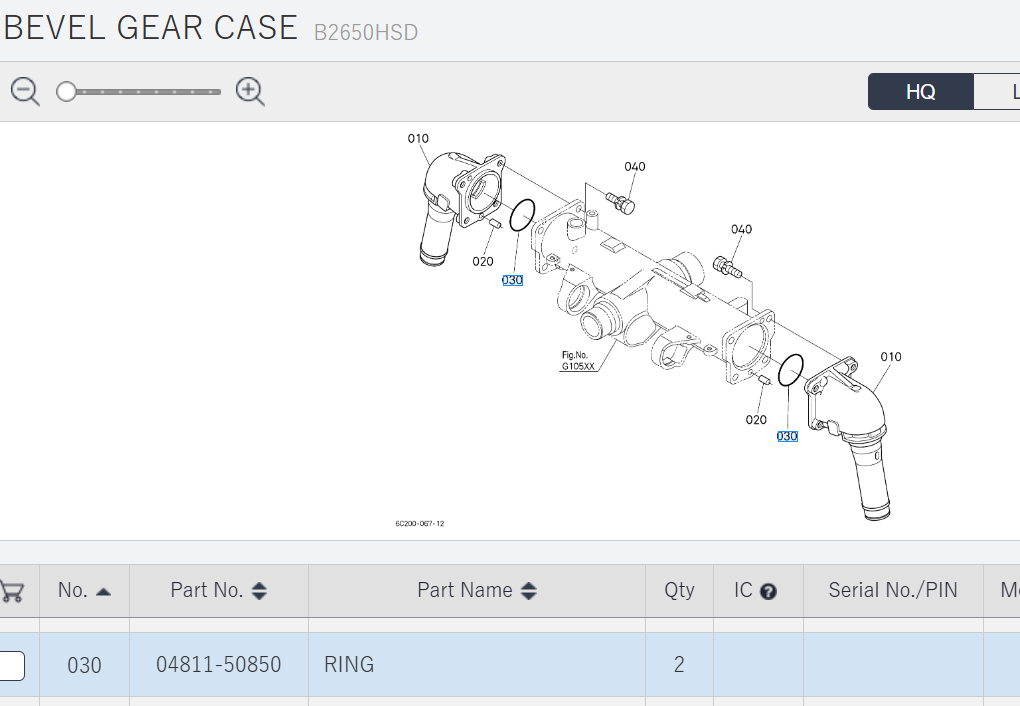

No seal there just an O-ring gasket, and there is no bearings that effect that connection.

Mine is wet in the marked area. I got it cleaned up so I could tear it apart. Then the fiber guys came to rehab and splice our cable. We have been without the internet or a way to use our cell phones since 6:15am September 27th. Getting it back today really helps me with this task.

That area you marked uses a seal, not o-ring. If it is only weeping oil a little bit, you can get by for a while by just making sure the oil level is high enough. Particularly if you really need the tractor to recover from storm damage.
