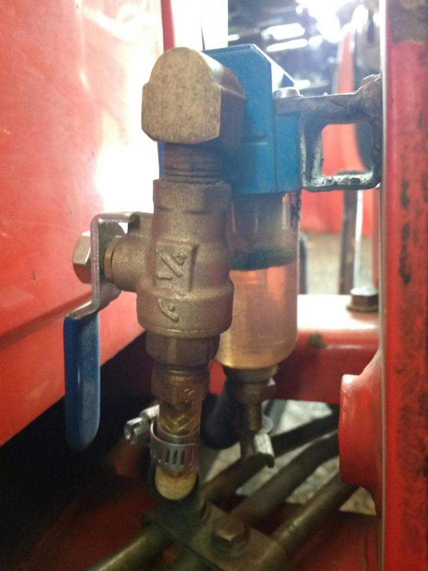

I ripped out the primary fuel filter on a BX23 and ran the fuel line to the fuel cutoff and filter that is mounted on the inside of the FEL support column. From there, the fuel line runs back to the original fuel pump, and then to the original secondary filter in the engine compartment. Has worked well for 2 years with no indication of debris or water in the fuel bowl.

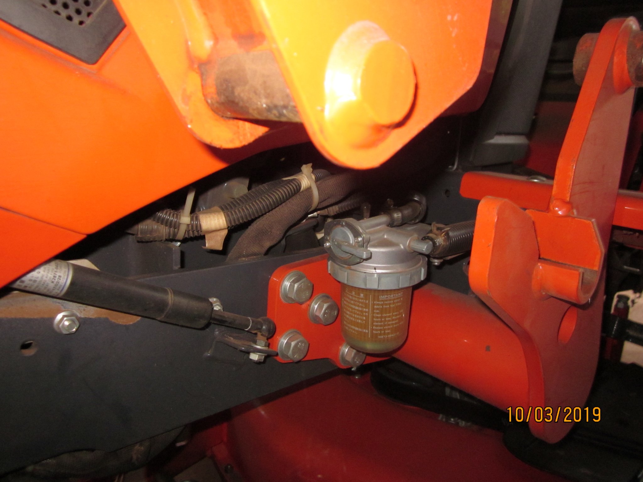

Here is mine***8230;
Uses the factory Kubota filter assembly: 6A320-58862
(https://www.amazon.com/Kubota-6A320-58862-Complete-Gasoline-Assembly/dp/B007S1P7X4)
OR
(https://www.messicks.com/part/6a320-58862/fuel-filter-assy)
Very easy to install and I placed mine where you can get to it easy, but keep it out of the way and safe.
This will probably be your cheapest and easiest solution to the crappy OEM filters. You could even use 2 of them, placing one before the pump, and one in the engine bay after the pump.
I do like your solution as it keeps the filter under the tractor belly better. Not exposed as much like the other filter kits. Still have to get under and change, but looks easier than the original to change. Question, am purchasing the underside shield from Bxpanded. Will your filter clear and work with that shield installed raised, if you know? This shield removes easily for access to that area. I would probably remove the OEM shield as no longer needed with the aftermarket shield.
