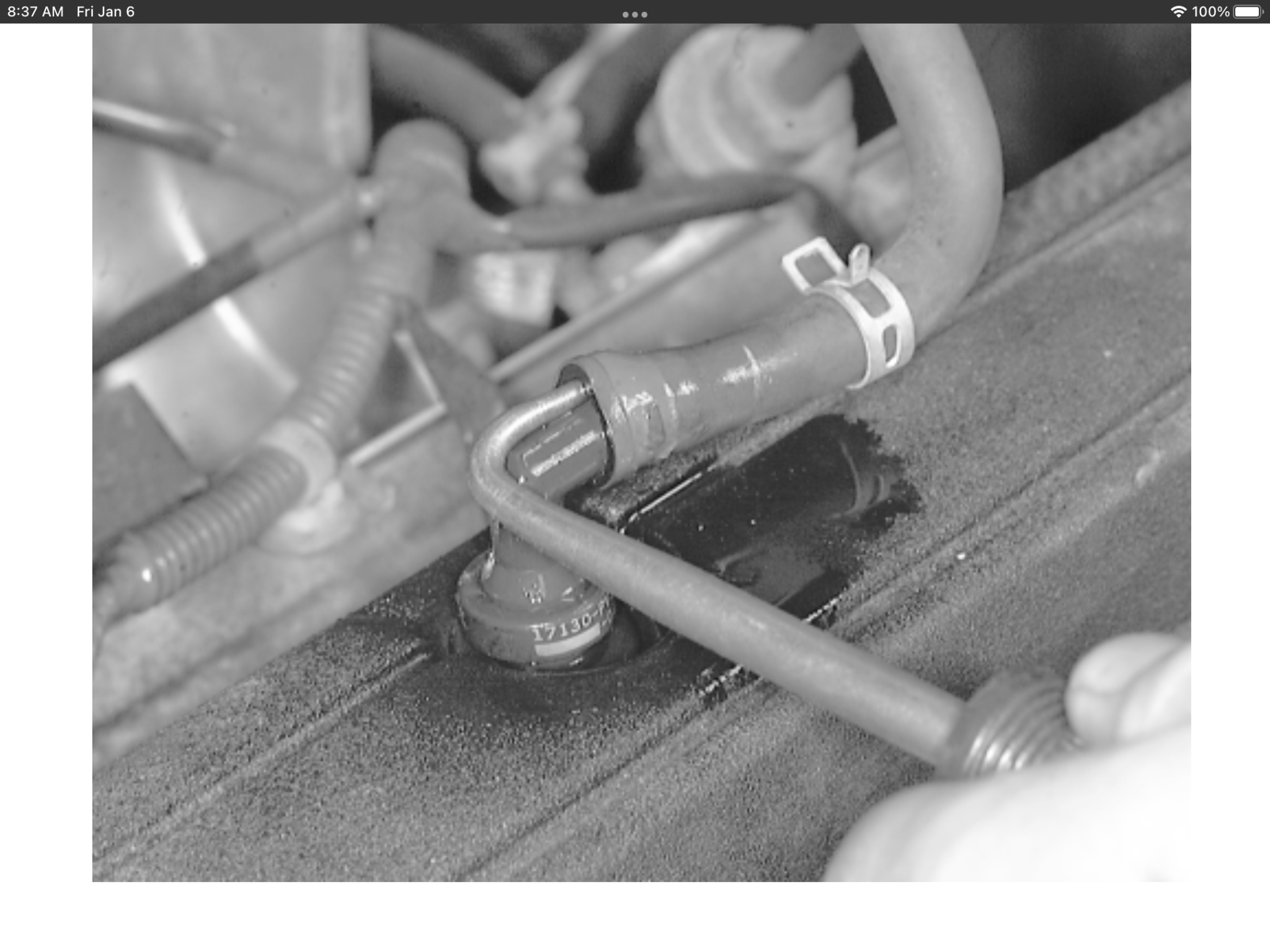

They actually make a ‘hose pick’ for the job. It’s got a particular set of angles on it that make a bit hetter for that task. But any large right angle or hook pick will do, usually. You just have to be careful not to rotate the pointy end outwards and stab through your hose.
Here’s an example of a ‘hose pick’. If you use that as a search term you get all kinds of different designs.

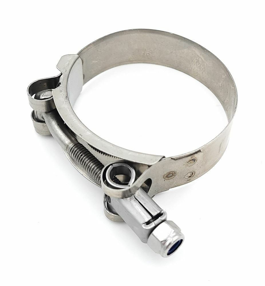

You say "clicks". I'd it is a worm style clamp, it might be skipping and not tightening.
Where possible, I prefer the T bolt style clamps.
