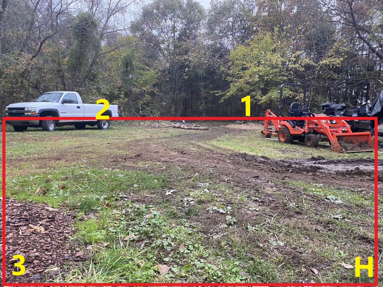

Hey all.... Well, to give a little more insight, I am new, and, I will admit I dont know what I am doing.....YET! Key notes YET!! The idea, this being my first TLB, you gotta learn somewhere, sometime. Either my equipment or someone elses. I would hate to break something, but, how else are you going to learn? With the Backhoe, i have learned where the digging ends and the tractor struggling begins. I dont kill the backhoe and more or move the tractor all over the place. Just takes time and practice. Same thing with the FEL. Only way to learn how it skims, digs in, etc, it to learn it. I can proudly say I can learn anything, but, agina, gonna take some time.
Reading the posts, my responses are that I will be getting a survey gun/level and rod, going around every25 feet or so taking elevation levels and plotting them down. Then I will know how much to dig. I want to be outdoors and do things on the tractor. If I get a box blade and dont make decent results in a months time of playing, I will reconsider. Minimun I need to do with the tractor is grade at least 20ft off the house with a proper slope. Ground is 1-2 ft of blackjack, 2ft of red clayish/sandy type stuff and then grey sadny type stuff.

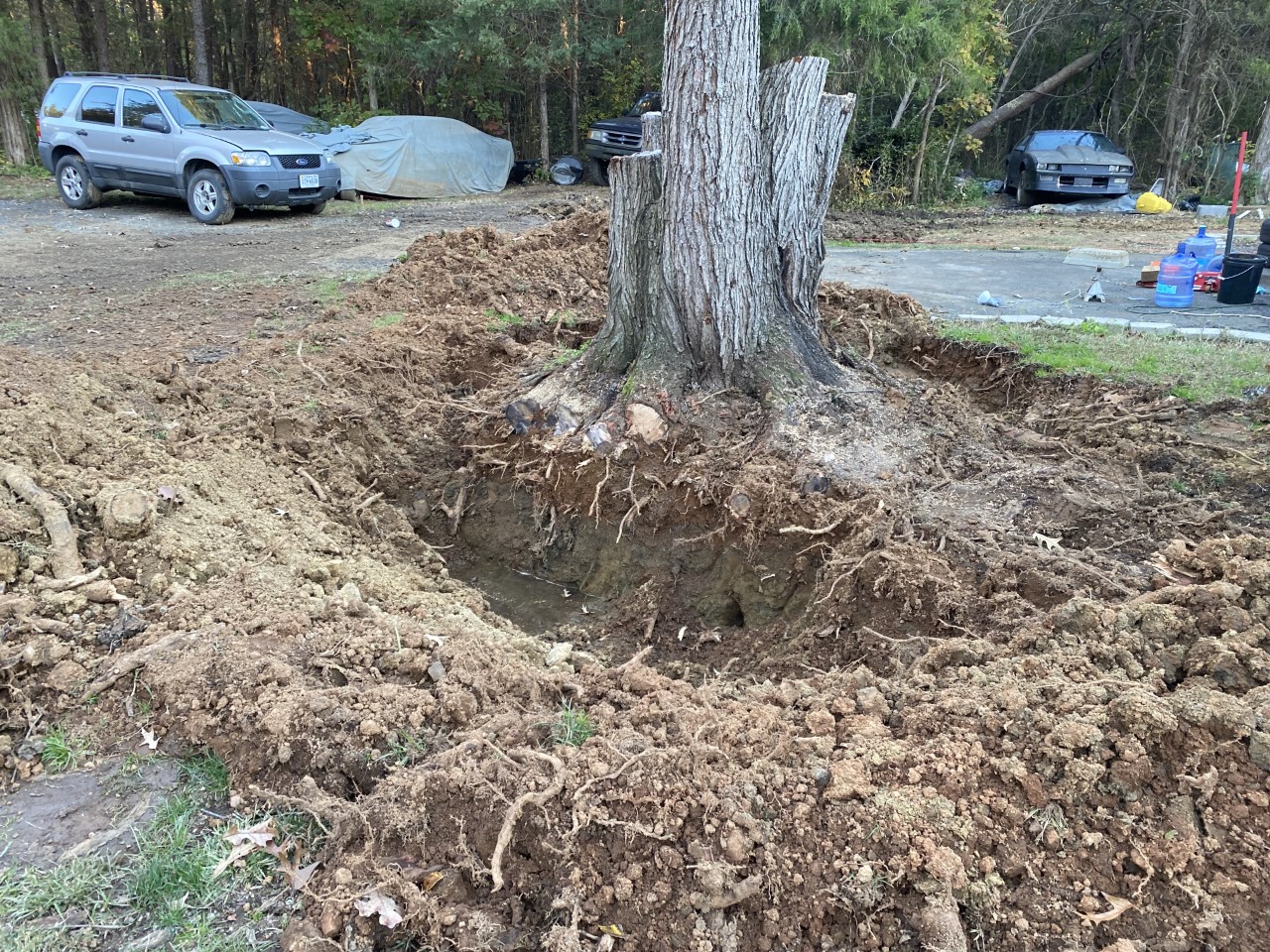

They say a picture is worth a thousand words, so, let me add 2 thousand words to ths post, lol. pic 1 is the tree I am removing so you can see the soil. nd pic is the area and example I was trying to explain.

Just a side note. On the other side of the truck is a death drop off that needs to be filled, so, I will not need to go far with the extra dirt.

Well you've got a fine piece of equipment that WILL accomplish what you want, providing you have the time and patience to learn the skills, it WILL do it all for you.
No, it won't be 'done in a day'...to do that you need to shell out 250K for the 'right' equipment. You will however be able to grade and move and whatever else you want.
Making a map and shooting grades is a GREAT idea ! Please pass that along to the City IDIOTS who redid two roads here, flooding one property. At NO time did I ever see a tape measure, level, transit,theodolite,compass or one of them all-in-one fancy GPS 'transits'.
Marking out 'sections', cutting 'level/grade' marks then removing 'inbetween' material does work well, especially for a smaller machine.
if possible, plan ahead, maybe job 'c' should be done before job 'a', as it allows 'b' to get done faster or easier.
While I've only had my BX23S for 3 years, it has almost 700 hrs on it, 90% doing jobs for neighbours.
Bottom line. If you use what you have, NOT ABUSE it, you'll get the job done, have FUN doing it, and won't break anything. As you increase you skills ,you'll be able to do the next job better and faster.
It is a good idea to take the top soil off first and pile it up somewhere to use later, then move the subsoil as needed, and recover with your saved top soil as the last step.
Just something I did not think to do myself in the beginning...
6,630
4,195
Yup!
A dozer or steel tracked loader will whip out that part of the job in an hour or two, and make a nice neat pile.
