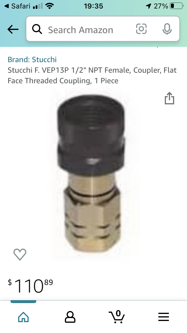

Engineer here. The issue isn't that there is not a solution. The issue is cost.
Here is what you are looking for, I have used the larger ones to hook up a grapple that had been sitting outside in the summer for a few days to a large excavator and threaded them completely together by hand. However, they are expensive.
When you said they’re expensive you weren’t kidding! I didn’t price the male. The 1/2” female satiated my curiosity.
Exactly. Now multiply that by 8 for just attaching a loader, 10 if you want 3rd function valve (not counting any implements using the 3rd function) and 14 if you want a single rear remote (not counting the cost of any implements running on the rear remote). It adds up very quickly on a piece of equipment under 100k an extra $800 cost to the manufacturer means at least a $1500 bump in price tag. Not enough value added by the different QC to market against a competitor. Now Kubota if they put it on all their equipment may be able to get the price of the couplings down to about $600 a tractor or about $1000 to the consumer due to volume but that still is a huge bump in price for something that will get used infrequently by most consumers and does not pose a safety or performance improvement. It is a nice to have that can be added aftermarket if desired.
That is not even close to reality. A manufacturer works in thousands not ones and twos. At the end of the day this comes down to weight/materials/process. When the street price exceeds that, the Manufacturer will manufacture them. None of these are made out of gold.
At 100.00+ USD for a pail of SUDT2 it does not take long to pay the extra for fittings that don't leak and do not need to be removed/leaked off in order to operate. Lifetime of the equipment it would actually save money. I can't even imagine how many gallons of hydro leaks daily around the planet because of these decades old poorly designed products.
