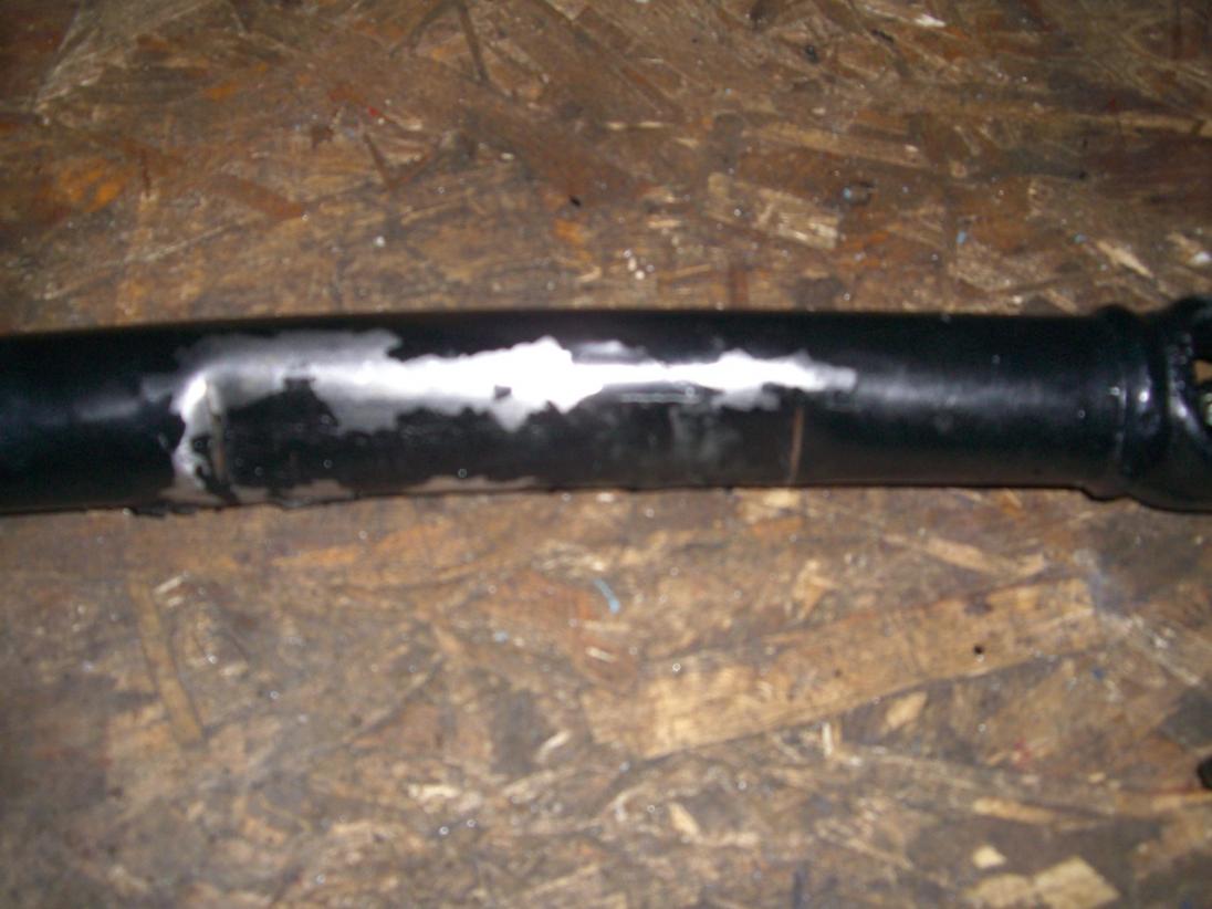

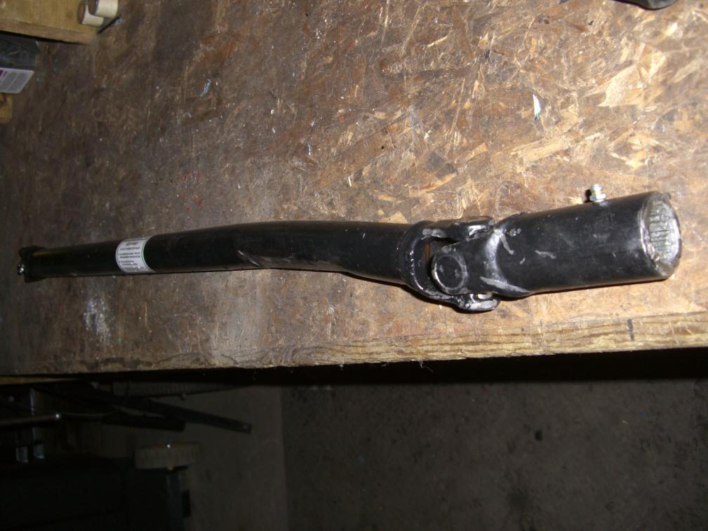

Well, today was a real highlight moment.
After a fall of 6 inches of light snow, I decided to blow it using my twice used new front blower. All went well at the start and it did a good job, however, as I approached the 25-minute mark and blowing just 6 inches of snow the universal coupling at the PTO drive end let go, snapped and sent the shaft flying.
Well. it flew into the cross member, then left the snowblower coupling.
It is a horrific noise and then you think what happened as you drive over the shaft lying now behind you.
Snow blower is fine, all shear pins intact rotates easily by hand, PTO splines are ok on both blower and tractor.

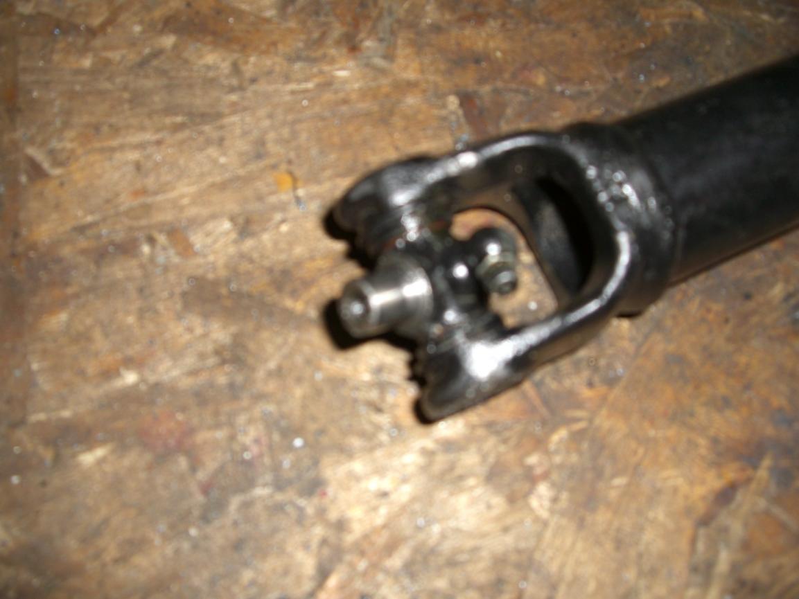

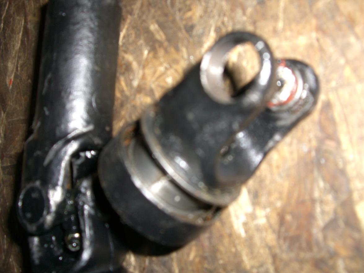

So the damage is to one universal coupling, one of the cups is completely missing, the other is sheared off. Tube, is bent with a good sized dent.
Anyone else had any issue with this blower? It has operated for about 1 hour, installed by the dealer.

Look at the red arrow in your photo which I have marked up. Could it correspond to something on the tractor frame? The mark looks like it happened while the shaft was stationary. The first time the blower was raised the shaft was bent and destined to fail.

The bend and dent were as a result of it hitting the spreader plate between the frame rails beside the engine sump. Only other marks are some deep scratches and small burrs on the quick attach plate ends.

I wonder if one of the bearing cup retainer clips was missing? Saw a similar result with a rock crawler driveline that was just replaced- when he got back to the shop, one of the clips was still laying on the bench where he had assembled the driveline.

Lil Foot, I think you win the prize for most likely answer to the issue.
On further inspection, it looks very much like one of the clips came loose or was missing. One caps came out and allowed the shaft to rotate out of axis and shear the opposite post.
After that is was toast.
Dealer, has never seen this before and is ordering in a new shaft.
This is on inspection a very flimsy item, the couplings are very small, the shaft tube is again thin walled. It wouldn't have killed them to make both the couplings and the shaft a bit more robust, after al,l it is a short shaft, the weight would not be that much if an issue and the balance might have been better.

No, the dealer didn't screw up.
The shaft was seated and the collar locked, I rechecked all that and made sure it was fully greased and the chain lubed before I tried it.
The clip is the failure point on this without a doubt. One cap completely missing but the corresponding post unmarked, opposite side sheared. The collar was still locked onto the mid-PTO after the failure, the coupling below it broke.
I have checked all the frame bolts and checked the frame for level and it is all good.
This one is down to manufacturing error.
