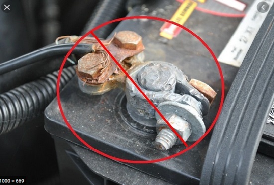

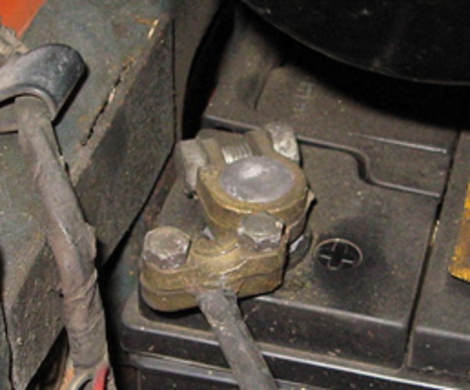

Installing replacement ends on cables usually means in a couple of years you will be back with intermittent electrical problems.

Invest in a complete new cable........... you will be glad you did.
Dave
I can't stand those replacement ends. Either crimp on terminal with heat shrink or replace the cable.
Those clamp on ends mean service calls for me. Within a month or two of being installed.

Either get a new cable or take a good look at that battery. IF the ground cable appears longer than necessary and the Positive cable too short....then there is a good possibility the battery is one with the 'posts' reversed.
Battery can be in the correct position but the posts swapped. The post configuration for any battery size/group is generally offered both ways.
