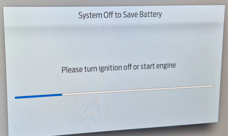

-33 this morning and of course cold batteries become a problem. A problem known since i was a child taught to me by my father.
My unexpected morning on brand new vehicle/brand new battery story follows...
for EV users it is generally known you can expect to loose up to 40% of your battery life in cold weather. https://www.ctvnews.ca/ottawa/article/cold-saps-up-to-40-of-ev-battery-life-caa-test-finds/
on older batteries and starting batteries most know a battery is weaker in cold weather.
But how about NEW gassers with new batteries? On my new F150 the dealer told me this morning of course you are going to have battery problems. Ford tech. told me this morning given so much electronics on the newer vehicles they sense the lower battery state and start to throw codes and shut stuff down!!! new truck / new battery just a cold winter day. Solution is to keep vehicle in heated area, use a battery tender, or wait till weather warms up is all the Ford tech could offer.
He did tell me be thankful I am not driving an EV today as he is getting constant calls that so many have turned into bricks until they get towed inside a heated place to warm up or plugged into a charger to warm the batteries.
Was told new truck with lots of electronics, with battery in perfect condition requires a battery tender if stored outdoors in cold weather. Otherwise expect computer to shut features down and maybe prevent a start. To me this is a step backwards not forward :(

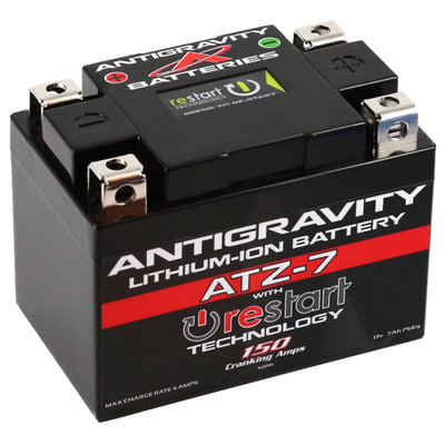

Here is what I used in the Yamaha.
IMG_20230720_172421622_HDR by cee_Kamp 32ACP, on Flickr

What year is your f150 and what engine? How often and how long do you drive it? Also is your f150 up to date with ota updates?
thanks for the questions.
its a 2023 F150 all loaded up, 2.7L EcoBoost V6 ,
over the last 12 months or so i have put on about 3,000 miles, this winter using it a couple times a week on fairly short runs. Over last summer though maybe once every couple of weeks as in warmer weather I like to take my bike (pedal bike not motorcycle)
my ota updates happen automatically at about 2am I am not sure how often I just let the updates happen whenever they want.
The day I took it to the dealer and noticed the warnings happened when it was really cold (-30's or so) but had used it at highway speeds for maybe an hour the day before and a hour the day in question. Wanted to give it a good run and thought why not as my daily F150 driver is 12 years old with 175,000 or so on the odometer. Was showing off a little to friends so took the nice one. Previous weeks I had seen similiar warning but paid no attention as I just thought I had turned it off improperly or left door ajar or something silly like that.
First time I ever saw a motorcycle with training wheels!
Okay, the message is not entirely caused by anything you did or could have done. Most of the issue is how ford programmed the charging system and possibly even the stock battery.
In order to keep this post short I would recommend you take a look at the f150 forums there is hundreds of pages of info about the issue and potential solutions. Its a well documented thing with the gen14 f150s.
Weight savings is right! The Deltran LiFePO4 battery that is in the race bikes weighs 25% less than the lead acid Yuasa. Maybe even less than that since I don't have lights and stuff so i put in a smaller battery. I would almost bet my R6 weighs about what your R 3 does. It's 374.4 lbs on a certified scale with a full tank of fuel. Only with about 100 more ponies 😁
