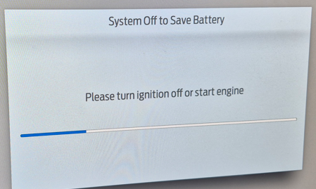

Okay, the message is not entirely caused by anything you did or could have done. Most of the issue is how ford programmed the charging system and possibly even the stock battery.
In order to keep this post short I would recommend you take a look at the f150 forums there is hundreds of pages of info about the issue and potential solutions. Its a well documented thing with the gen14 f150s.
thanks.... I got a question for you though.
today it was something like -38c (-36f) and the truck was throwing the same message. (see below) At first blush I thought when I started seeing that message last week it was a bad thing. Like battery or something going bad.
now though as it gets colder and I am running the truck daily I am starting to think this might be a good thing! not a sign of battery or other problems.
Could the truck be smart enough to realize thats its very cold so its making steps to protect battery etc... by shutting down OTA and anything else thats not absolutely critical to keep powered up to protect itself?? could it be programmed for self protection of its battery.
your thoughts?
your thoughts?
Its possible the truck is protecting itself but you should not get that message expecially when it driven everyday unless its very short trips.
One thing you can try is to not have the hvac system in auto and manually turn the fan speed up to 5 minimum. Supposedly this tricks the vehicle to actually charge the battery more. I dont know if it works or not but it worth a shot. I will pm you some links to some reading materal about the battery charging system.
thanks for the links and the wisdom. This old dog is much smarter now.
I tested battery and its fine as expected as truck and battery almost new. So its either:
- the computer just protecting its self sensing through the BMS temp sensor that -36 deserves some protection (which is a good thing)
or
- since it did sit for a couple of weeks last fall and in January when I was on holidays, etc.... maybe a simple BMS reset is warranted ( you know that push the starter, stick your tongue out, 5 flashes, 3 stomps, push the button , check the zipper kinda reset)
in your experience is their any reason NOT to do a soft BMS reset if all otherwise is fine? wondering if this might somehow fart up the days in service counter.
or
You could try a bms reset but it does reset the battery days in service. I dont think this a fix but some have had it work. The only thing I would recommend is putting the truck on a charger overnight or ultill fully charged then do the reset. Or just put it on a charger overnight without the reset and see if the message comes back. Remember the negitive lead from the charger cannot be directly connected to the top of the battery terminal because of the bms sensor. You could also try the fan speed 5 trick see if that works.
got it! negative on engine side of sensor.
its on a trickle charger now but charger says battery is 100% so feeling pretty indiff. over the whole thing.
Will let the 2amps flow for the day as it shouldn't hurt.
good news is I be having no troubles, battery shows 100% and at -43 wind chill this morning (-36 w/o) it fired right up w/o being plugged in. Life is generally pretty good.
