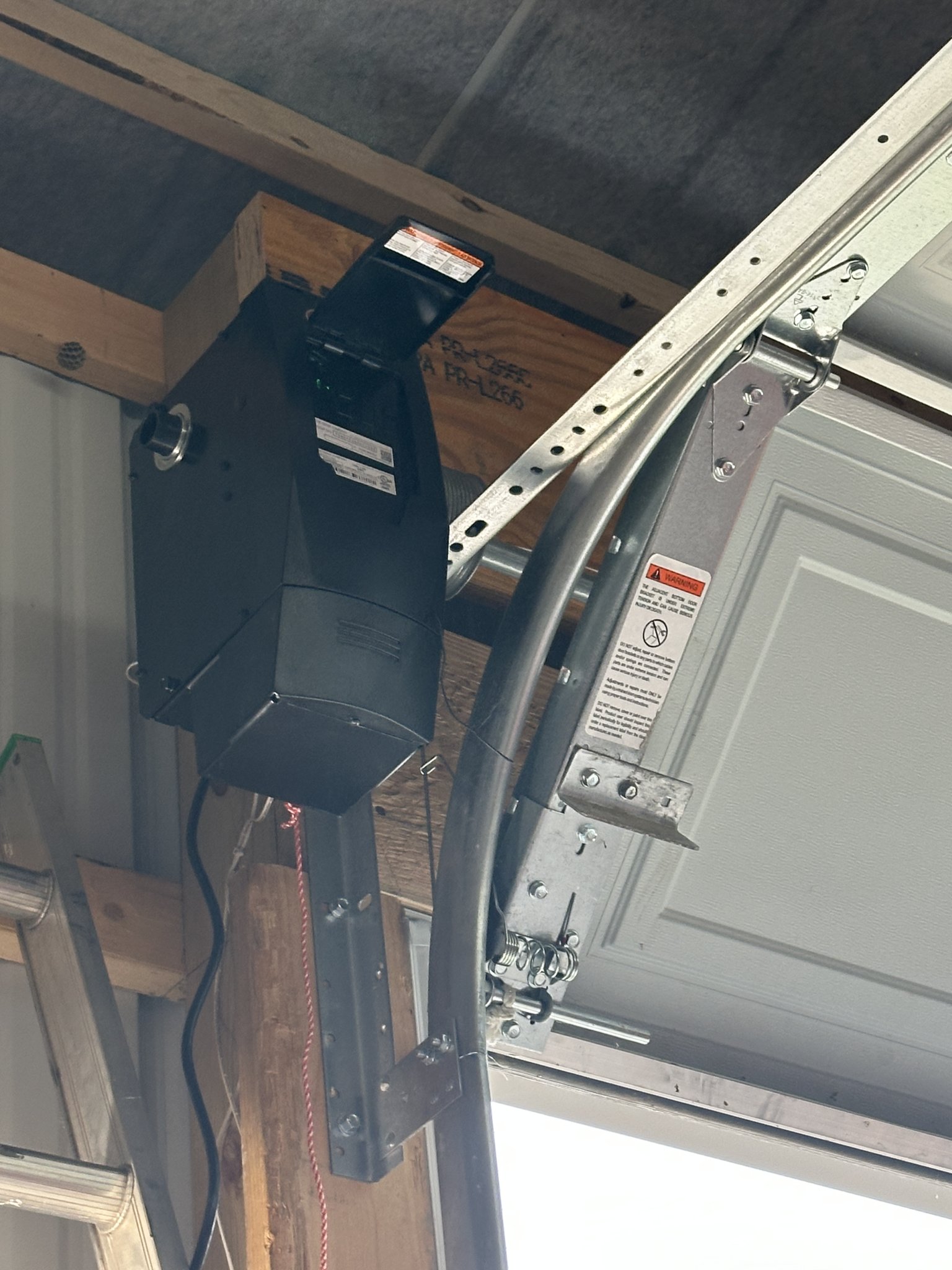

Put in an opener for the barn door today. Tried something different with the side mounted direct attached unit. No rail, chain or belt. Exponentially easier to get installed vs the traditional styles. I went with Genie since my other openers are Genies and IMG_3523.jpeg I can use their mobile app for keeping track of all the garage doors. Got a little cable mgmt to do on the power cord and emergency release cable. I really like the fact that it has a deadbolt that engages when closed and does not disengage when you pull the release cord. Requires one to do that manually.

Mine had to mount to the wall so I am confused by the way that is just hanging in space. There must be some torque arm involved that is not obvious in the picture or it would just try to rotate itself instead of rotating the drive bar.

That is all I have installed at our place. They are quiet (only noise is from the door itself). Headroom is increased since there is no drop arm bracket. Maintenance free.

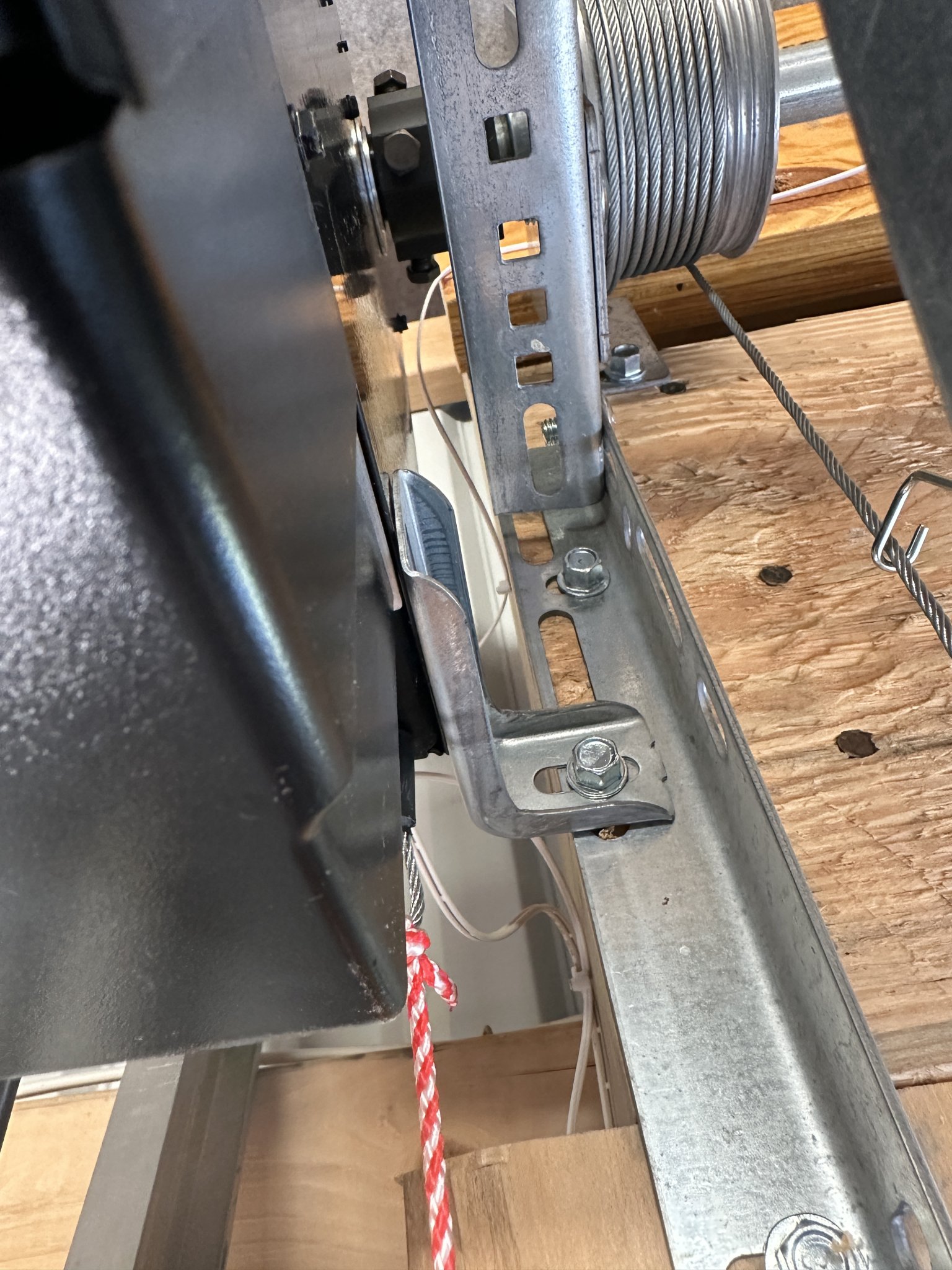

For those that asked- there is a bracket that mounts to the door frame. They aren't really "wall mount". It's more like frame mount. It is attached to the angle iron piece you can see in the OPs photo.

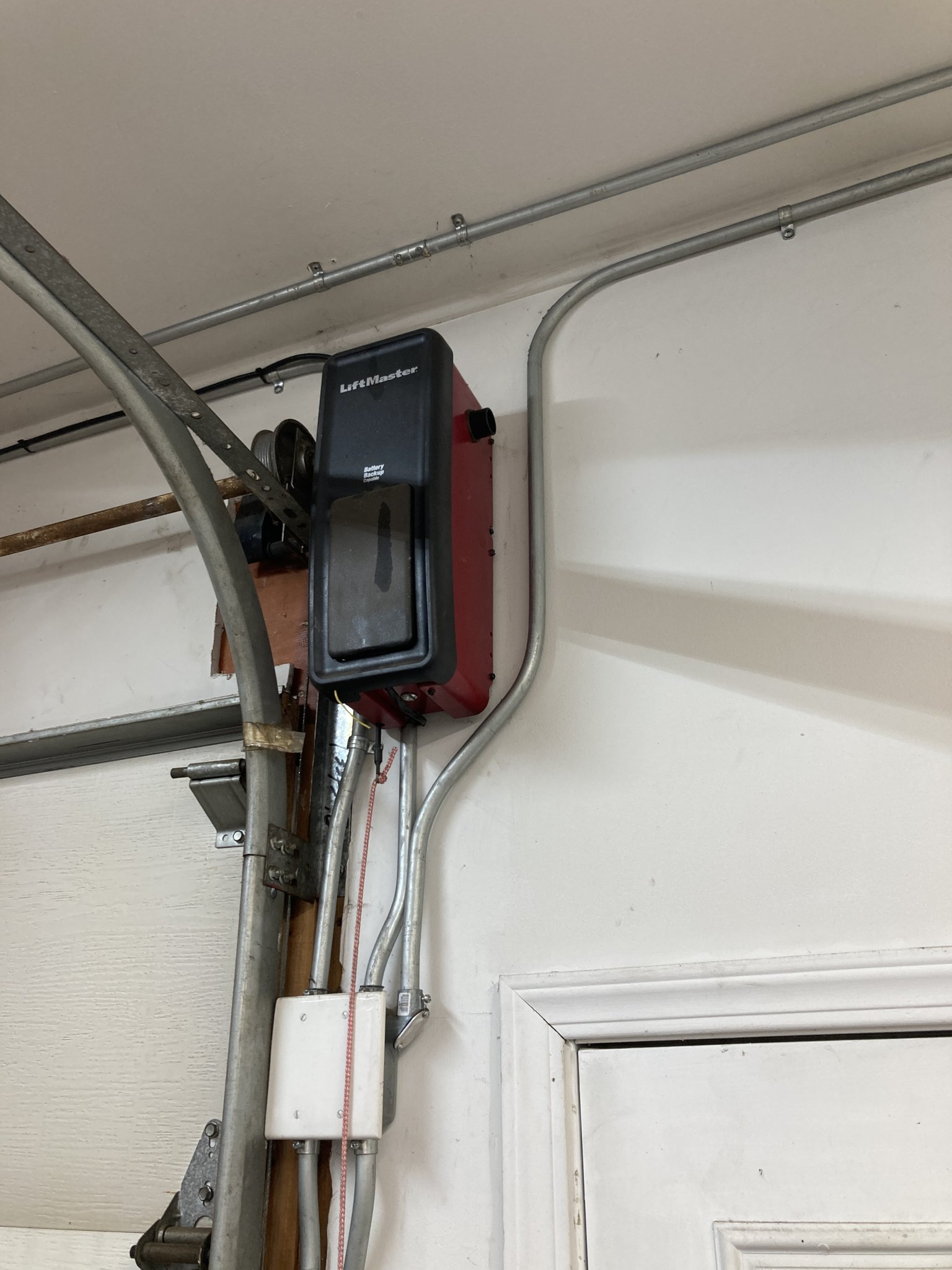

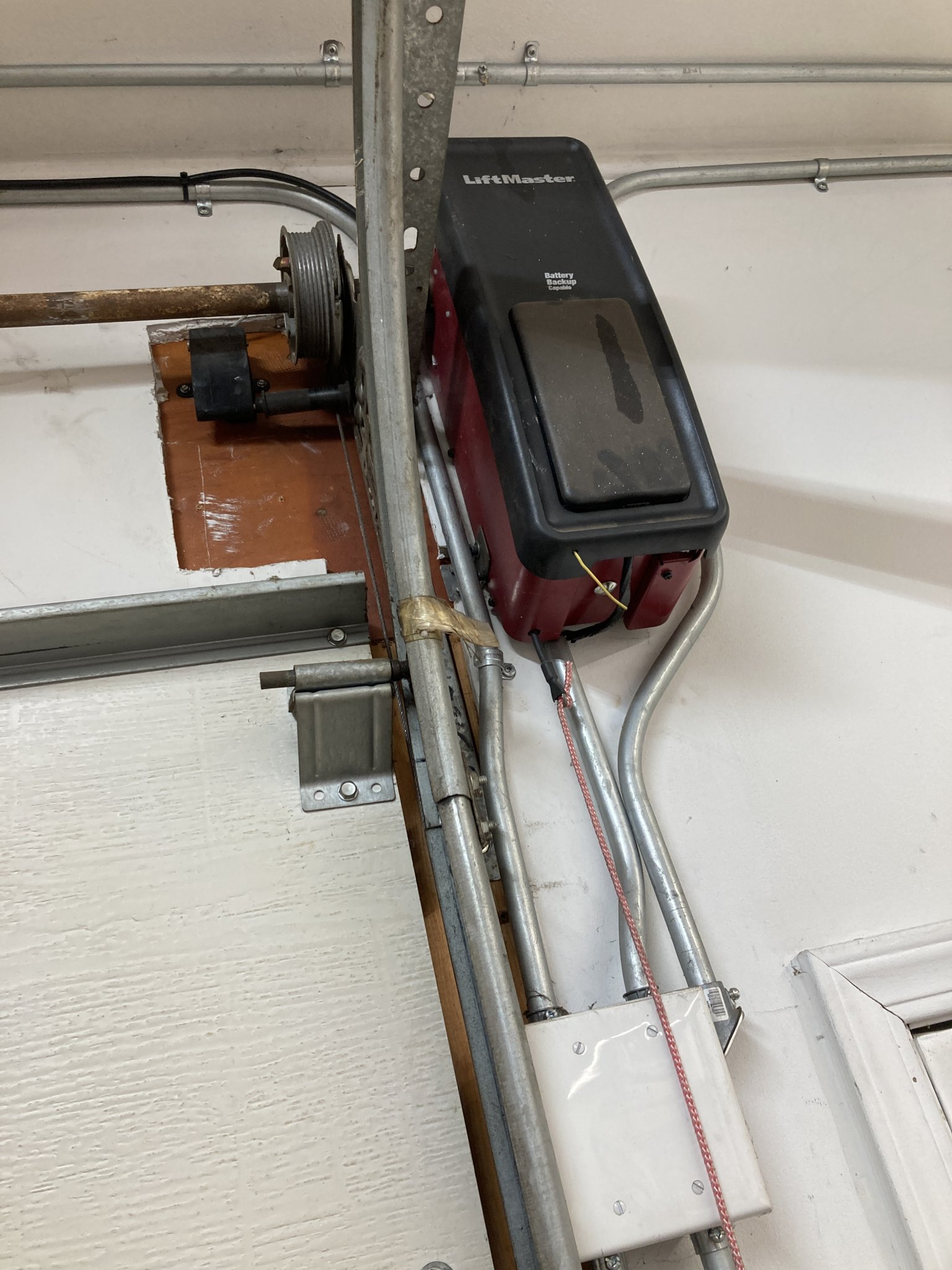

I installed a "Lift Master" when I installed the hoist.
It is considerably quieter than the old "chain drive" model that it replaced.
Although I do not have a "back-up power source". We don't lose power very often, so ........
Although the "specifics" of why I had to remove the drywall escape me, I do remember running into a problem with that little "arm thingy" fitting properly, but removing the dry wall solved the problem.
I like it way more than the "chain drive" it replaced. (y)
View attachment 140557 View attachment 140558
I was concerned with the mounting but this unit came with adjustable tabs that allow you to get the proper standoff and fit to the tube. Get everything level and lock it down.

Duck tape. The 100mph variety. Here’s a shot of the mounting. Bottom is bracket bolted to unit and attached to door frame opening. Top is coupling that attaches to door shaft. In my case that chart extends in to the unit at least 4”. IMG_3529.jpeg
