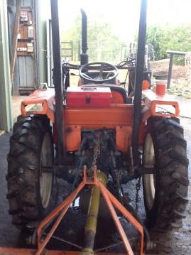

Hi Wolfman. I have ordered front tyres as well but they are not easy to find down here. 6 x14. Tyre guy said 2 to 3 weeks. I have no doubt the support network/ spare parts etc is a lot better for 'gray' tractors in Nth America than it is in Australia. Another reason why this web site is so helpful.
I had a really good look at the stance from behind. From all angles actually. It looks ok, but to be very honest I'm not sure I would be knowledgeable enough to know if anything was wrong, except if it was very obvious. I took it for a drive and it felt great. It's a much improved ride without the rice tyres. And it's the first time I have been able to put my front axle seal repair under stress. No leaking at all. It's a good feeling when you have no mechanical experience, but just research the subject, take your time, and repair it yourself. I love working on the old Kubota.

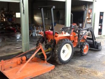

Ok, thanks, I shall get to measuring tomorrow. Here she is in all her glory. Not pretty and she is not happy about having white rear rims. That's my next project.

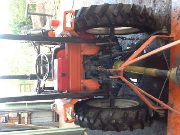

Thanks mate. Hmmmm I know how to flip my rear wheels to give me an extra foot of width.....but no idea how to flip a photo ***128512;
If your taking with an I-phone, hold the phone upright like your gonna talk on it with the button down. On my tablet I can load up the album. Tap on the picture, and one of the options is to edit. That gives you an option to rotate.
On the computer, I can either edit it in Microsoft paint. Or load up the thump nails, and right click on the mouse over the picture. One of the options is to rotate the picture
10,977
2,831
John,
most software now days understand when a picture is vertical or horizontal, it is smarter than ever, even if the picture is taken upside down! However - if you flipped it by using the software or the software flipped it automatically - simply look at the picture on the computer and then HIT SAVE, by saving in the "correct" view, it will upload it correctly!;):)
