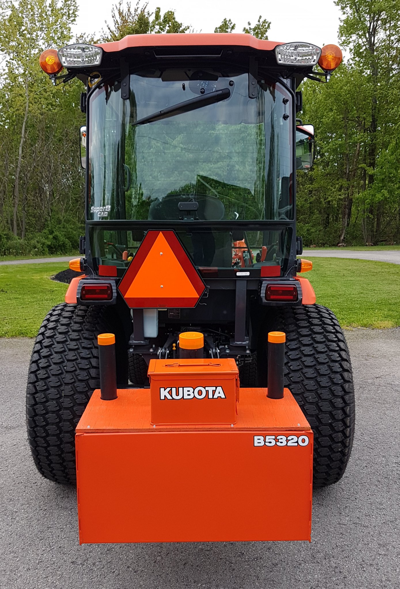

Ballast Box a must with Forks, especially heavy or extended loads, darn good in winter also for traction pushing snow 20190524_211409.jpg

Thanks troops, installed Ballast Box shortly after purchased last year, traded in B2601, there is a few stones in the front tires I missed..
