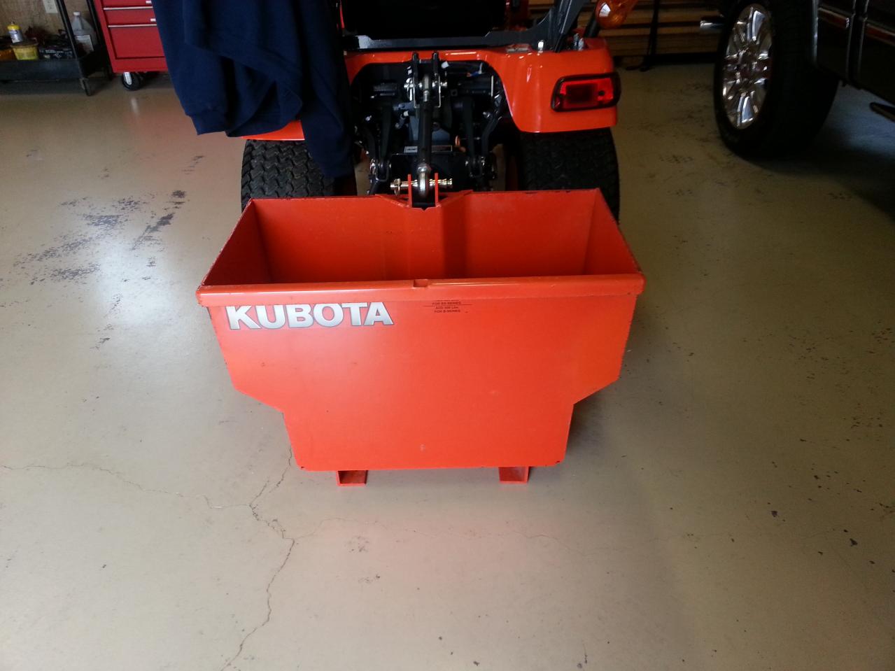

Got the box yesterday now to get some sand and load it up. It appears that I am going to have to make a stand cause i don't think it will hock up the 3 pt while it's on the floor.

I use 350 lbs of bagged sand in mine and filled tires. Works great. I installed steel casters on the bottom of box, it makes it easy to store and hook up to tractor.

Well if it has weep holes in the corners, you could just lay in a layer of small gravel and then sand on top, the sand will pack in nicely about the stone. You don't want to seal the holes up cause water will accumulate and over time rot the bottom out
Yeah, I have the same box and I initially had to use some 4x4's to raise it high enough to install. I can't remember for sure which worked, because I did 2 things at the same time to fix the problem of the lift arms not going down far enough. (1) I bought another adjustable side link and put it on the left side. (2) I drilled another 1/2" hole in each lift arm about 2 inches closer to the tractor. I'm pretty sure the 2nd adj. side link did the trick because I keep the 3 point set up in the original lift arm holes. I thought I needed the extra holes to get a cat 1 one bottom Brinly plow to go deep enough. I found info with a google search, but there wasn't a lot out there.
I just use old concrete blocks, old disk brake rotors, belgian blocks, old lifting weights and whatever works for ballast. I want to be able to easily empty the box if necessary. It drains perfectly too. I planned to build a wood/fiberglas cover for it to hide the ugly but haven's so far.
Wildfire
Wildfire what did you close the holes up in the corner with? Mine has what appears to be drain holes in corner and don't want the sand to come out like an hour glass.
Well when I got my ballast box it was pretty fugly. If I had my time back I would have built one from scratch but I decided to mod this one and to plug the holes I simply welded them over.

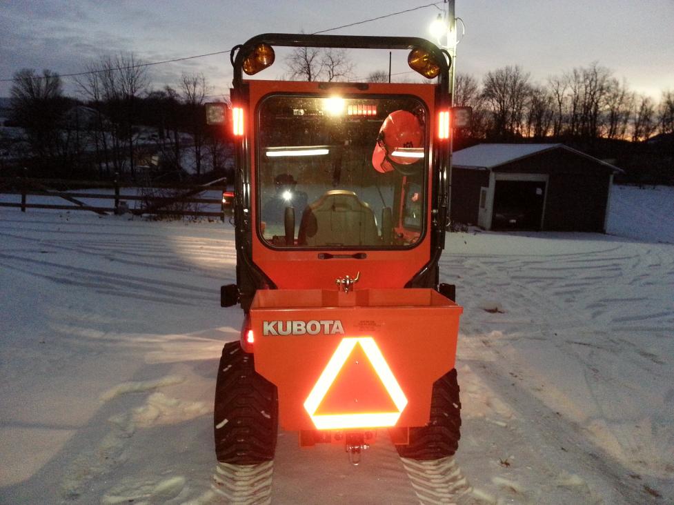

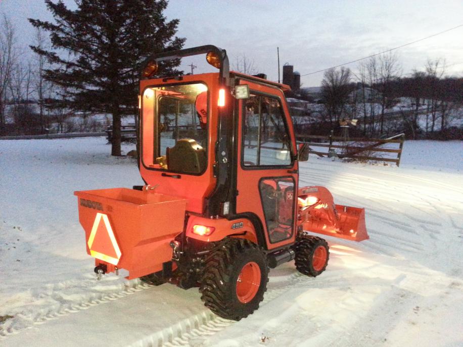

Yes I added the trailer hitch , which is bolted onto the bottom, from TSC store.
I also installed the cab by myself in one night.

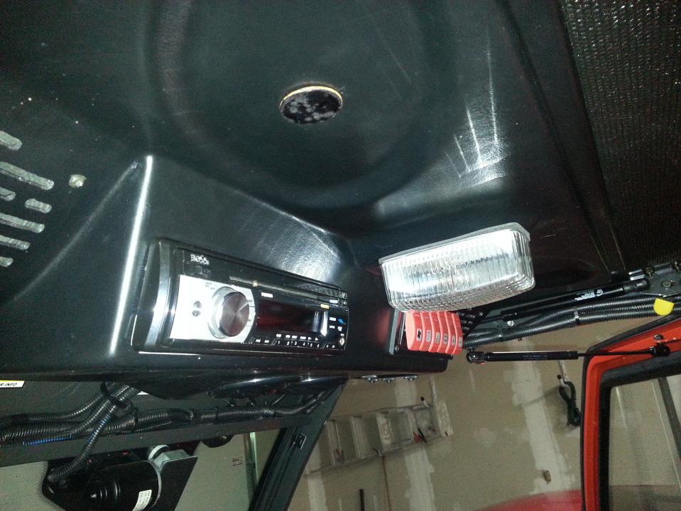

Love the cab, it has the 20000 BTU heater.I have worked at midnight in 20 degree weather and was glad that the heater was there to warm me up so I could keep going. I added the wipers and over head console with fans to it and CD/AM FM player.
